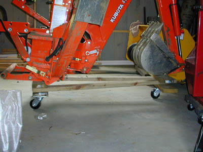

If you've got a drill that works, stick with it. I've found my dolly makes installation (and storage) much easier and I highlly recommend building one if you have a good floor surface to roll around on.
With the BH on the dolly, I roll the BH up to the rear of the tractor adn attach the pump so the BH is powered. I then position the BH and attach the lower 3PH draw bars. The dolly makes this part real easy. I also leave the sway pins out of the draw bar stabilizers so they can swing freely from side to side.
Once the draw bars are on, I move to the top link, First I put the lower pin through and snap-clip it in place. Now using the hydraulics on the BH I position the BH to raise the mast up and drop the hook part down on the lower pin. It then only takes some minor nudging to get the top pin installed and snap-clipped in. The last step is to pit the sway lock pins back in place and it's off to the races. The process takes between 5 and 10 minutes.
I can think of two things you might want to look at. The 3PH limit bar (the round bar than's below the draw bars on the BH) may need to be adjusted. I have mine set so it's in the lowest possible position to minimize interference when installing/removing.
Second, I found the rigging in the manual to be incorrect for the B2910. The rigging I ended up with can be seen in the attached photo. I can't remember hwo I originally rigged it and what the problem was, but the photo shows what I've been successfully using. I seem to recall someone else posted a photo with their rigging and I think that's where I got it from.

Thanks for the information and picture. I plan on making a dolly. Your picture will give me a head start on how to make it. /w3tcompact/icons/smile.gif

Also, Hayden - a nice rig you have to move around the BH, makes for storage and moving around easy. I just drop mine in the corner and block up the base for easier install.

I was looking at the picture of your Backhoe Dolly. Noticed that my Backhoe is assembled different than yours. I scanned the pages from my manual. It was revised last year in October. I don’t know why the difference. But thought you might want to know. Drawing on right is the 2910 setup.
/ 4690 BH Install/Remove #6
Yes, that's the same as my manual shows. I wish I remembered better how mine was originally rigged but I ended up with it the way you see it in my pictures because it didn't fit right the other way. I just don't know if the "other way" was like in the manual or something else.
Are you finding your's easier to get on and off, and is it rigged like the manual says?
Peter
Hayden
Mine is rigged like the manual for the 2910. I’ve tried it one time since mechanic came by. It wasn’t too bad. /w3tcompact/icons/smile.gif Will get a lot better when I get a dolly built. /w3tcompact/icons/grin.gif
