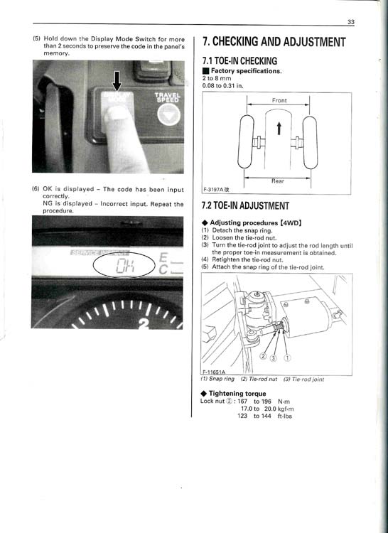

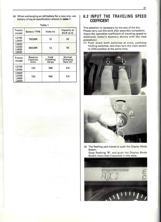

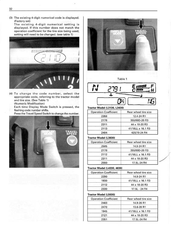

See attachments

Just go it from tilling and brought the book in this time, but Rat beat me to it. It is quite simple just follow the directions and you will know how fast you are going. After doing mine I knew when I was tilling at 2.4 MPH, before setting mine when I thought I was doing 2.0, the actual speed was about 3.6 so who knows what the factory was set for, not for R-1's for sure.

Thanks for the info! I wonder what A, C, and D modes do? Is there a lot of other info in the setup manual? I see the page numbers are pretty high...
Maybe I should try to get a copy of the manual at the dealer...
Ken
   / 4630GSTC Speedometer Calibration #16
It does not mention what those do in the manual. It mostly shows all the unassembled parts, how they go together. For instance, the front axle does not have the hubs in them. It shows how those go together. It also mentions how long it should take the dealer to assemble the various tractors. It's about 1.5 hours.
