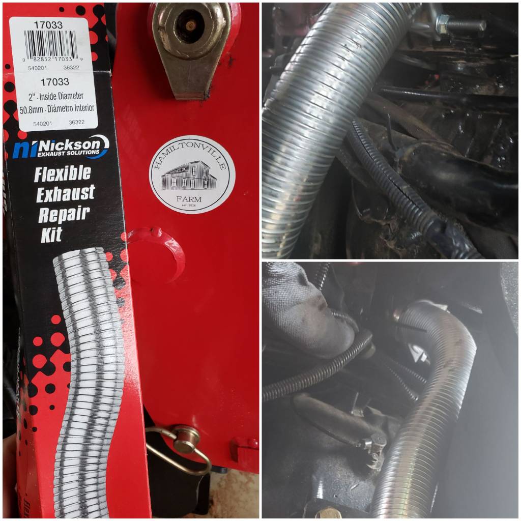

I added a piece of 18" flexible exhaust pipe to my exhaust today. I was on the tractor 4 hours today and I didn't smell the exhaust

Hey Hamiltonville! How did you attach that flexible exhaust at both ends? Did you clamp it to the existing pipe? I didn't see a clamp in your pic. Did you ever do a video on this? I am tired of breathing exhaust, almost as bad as my old oil burning 8N! YouTube subscriber to your channel
/ 4540 exhaust
Yes, the kit came with a clamp. Still running it this way. It works great.
/ 4540 exhaust #7
Did you attach it any way at the bottom? I'm going to buy one tomorrow.
/ 4540 exhaust
I used safety wire and secured it to the frame where the FEL goes.

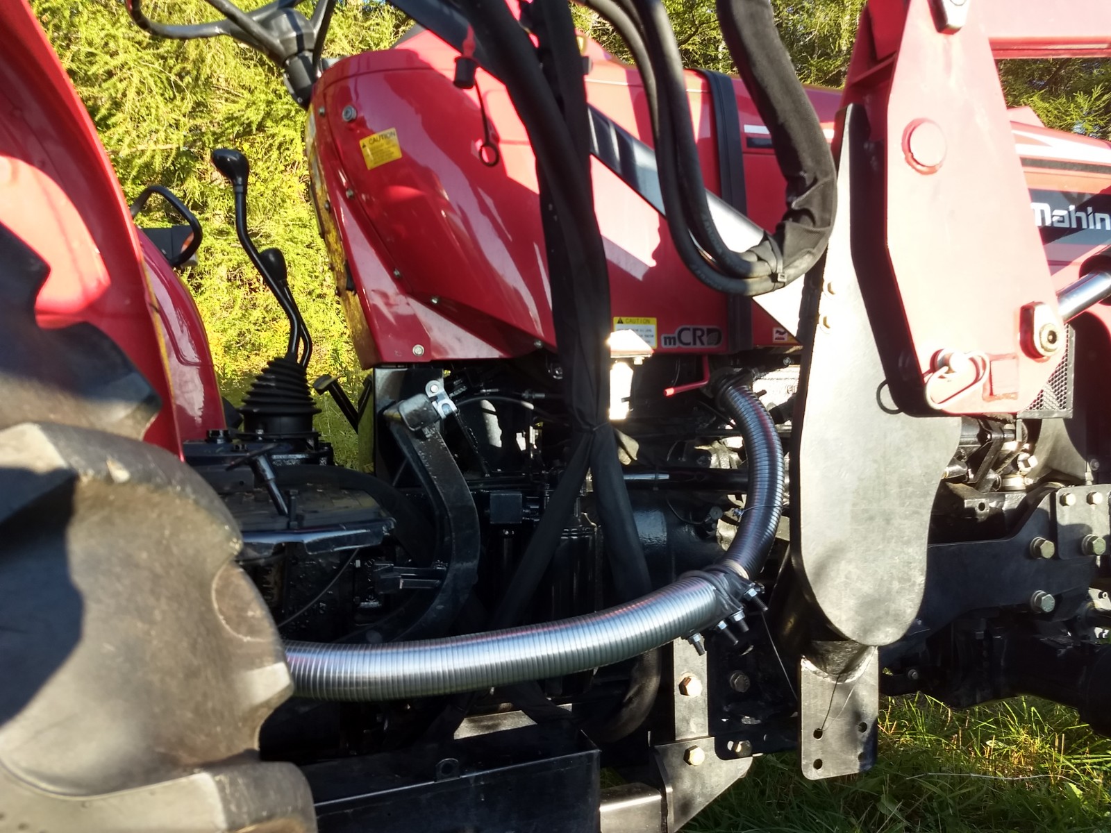

I ran 6' of flex pipe to the front of the tractor and attached to the small plate that protects the front axle. Since it's the furthest possible point I hoped more of the fumes would disperse before reaching the driver. A short test drive disproved that idea.
Next I'll try routing to the rear of the tractor. That's tricky because there are a lot of moving and protruding parts on the way from the exhaust to the rear behind the driver. And not as many options for securing the pipe. But I think I found a path for a test try.

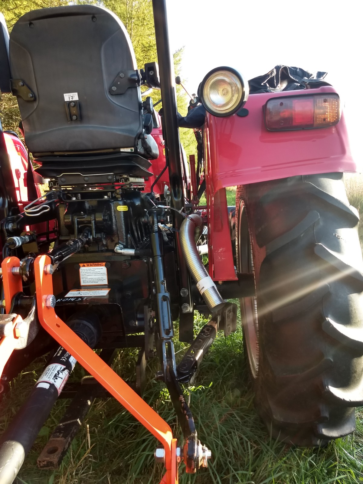

I ran about 78" of flex pipe from the under-hood exhaust pipe to the back of the tractor as a tailpipe, just proof or disproof of concept.
Since I'm running out of ideas I also got a 3M 7502 half-mask respirator with multi-gas/vapor cartridge P100 filters.
I wonder if anyone sees any problems with this before I try it?
/ 4540 exhaust #13
My wife tried this, bush hogging for an hour, and said it works great. Tail pipe makes all the difference.
