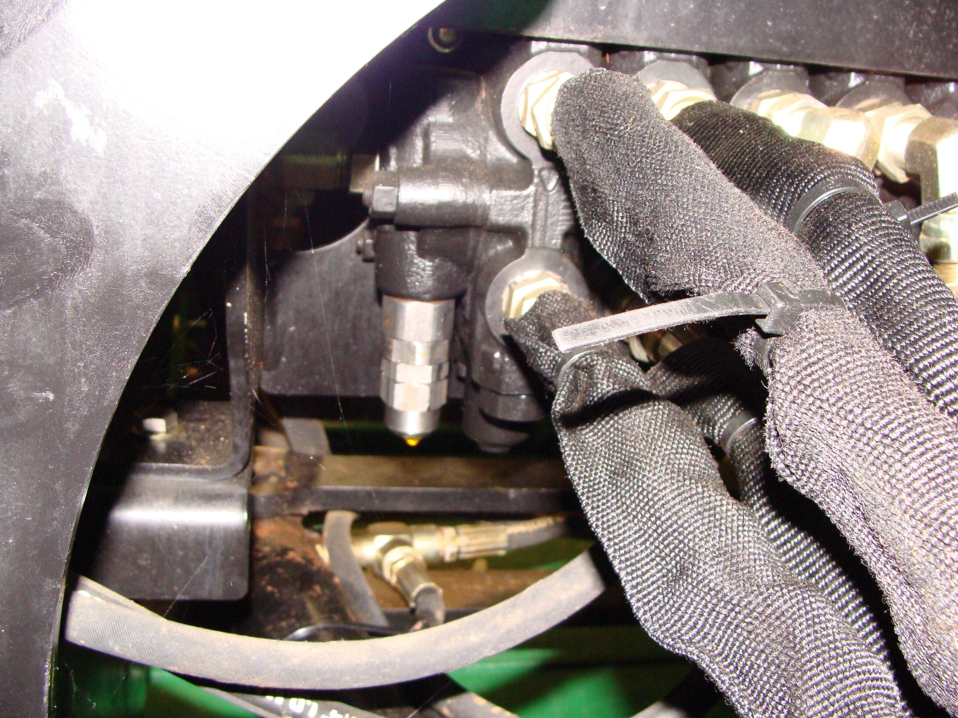

I had a similiar problem with my 447 and just took it to the dealer for repair. $350.00 later it's working again, although now it leaks a little and I think they didn't tighten something enough (see photo).
Does anyone have any idea about the part in the attached photo? You can identify it by the drop of hydraulic fluid about to drop on the floor. It's on the left side of the hoe facing forward toward the tractor (right side while seated on the hoe). It has what looks like 4 different pieces that a wrench could fit on. Are they all supposed to be tight? I can't seem to get it to stop leaking but it's a very tight fit to get a wrench in there. Any help would be appreciated.

That looks like the relief valve for the valve. The leak may be elsewhere.
   / 447 backhoe problem #29
JJ is right. The Deere documentation calls it the "system relief valve". What they mean by that is not the tractor hydraulic system, but the backhoe system.
When I got the tractor/hoe back from the dealer I immediately noticed it was leaking fluid while running. The valve was loose and I could turn it by hand, it was definitely coming from there. That's when I started to tighten it but wasn't sure about all the specs on whether it was supposed to be tight or how tight. And it's hard to get a wrench in there; I may buy a deep well socket for it. I would take it back to the dealer but I'm not too happy with them and they are an hour away.
