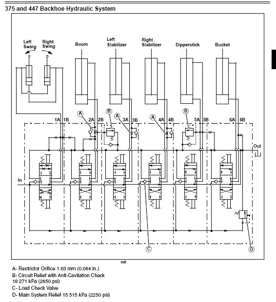

That is exactly right, when the boom flexes( the cylinder extends) lies the issue, how do u check for this or fix it, could u email the schematic to me or send me a link, I appreciate it, how does something lime this happen? Easy fix or complicated repair

According to the schematic there is such a valve on the extend side of the boom cylinder.
The item that's marked 'B' ?
Edit; never mind, I see the footnotes at the bottom now. :confused2:

sorry i was checking the email from my phone, didn't see the schematic, how do you tell if this is bad or not?

It looks to take a special tool to install a new seat (if needed). But if it is a broken spring, it seems simple enough. I think the relief can be removed and taken to Deere (or a valve shop) for a look see if you feel uncomfortable about turning wrenches. Listen to kennyd and AKfish about testing the system with a gauge first. They are the masters, I am a lowly apprentice.

well....ordered the manual today offline, went over to my garage this afternoon to clean up, decided to move the tractor out of the way and viola: the problem has fixed itself, much the same way im sure it did the last time. does this sound like some relief stuck open and the messing with lines, etc over the last week freed it somehow, eitherway, so far so good, hoed for about an hour without problem, seams to be stronger than before even, thanks for all the help

That looks like the relief valve for the valve. The leak may be elsewhere.
/ 447 backhoe problem #29
JJ is right. The Deere documentation calls it the "system relief valve". What they mean by that is not the tractor hydraulic system, but the backhoe system.
