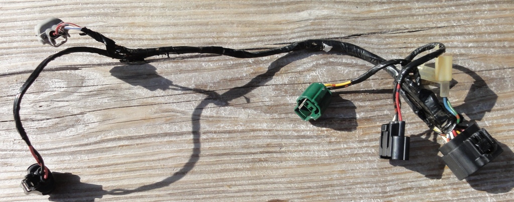

I wonder if any of you can help me with this.
I need a section of the wiring harness for a 445 mower.
This is the upper section that connects all the Fuel Injection sensors etc.
See the parts page item 33 which is number AM119104.
View attachment 445_Wiring-Harness.pdf
The problem is that this harness does not look like mine although the dealer plus JD says it's the only one available.
Click on this to look at the actual photo of mine.
You can see that the 2 connectors for the MAP sensor and the water temp sensor look wrong in the JD drawing.
Does anyone recognize what the ones are in the drawing? 1 is U-shaped and the other L-shaped.
Here mine has the 3-wire and another 2 wire connector.
The dealer is no help, and says I could not return it if the electrical part was wrong.
I don't care to pay the $85 for this thing, but I need to know if it is what I need.
Mine is maybe 18" long total and had that 12 pin connector on the end...
I already sent a message to JD and so far they have been zero help.
They say to "contact your dealer."
It shows to be "NLA" but JD still has inventory left.

The parts page is indeed incorrect.
