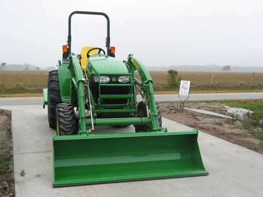

#39
73" heavy duty bucket with hooks added. Look not a scratch. /forums/images/graemlins/grin.gif
