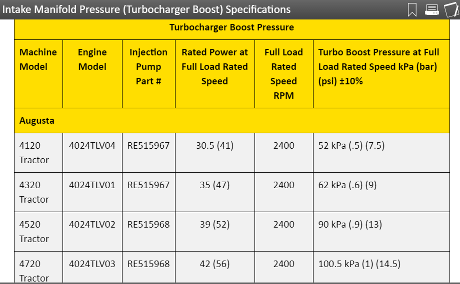

I am looking to buy a 2014 or older JD. I have been looking at used 4000 series. What struck me as a bit odd is that it appears as though the 4120, 4320, 4520, and 4720 appear to be the same engine except the HP goes up from 43 to 60. Same bore and stroke. Same compression (+/- .5).
I can only imagine that they increase the boost on the Turbo on the higher number models in this series.
Does anyone actually know the boost pressures, and if so, a link to the data?
Thanks.
Charlie

I had a 4120. From what I remember there are different injectors as well on the higher hp engines in this series.
/ JD 4120, 4320, 4520, 4720, same engine, same compression, different HP. (boost?) #3
More fuel more boost and possibly an intercooler.
I have read the other models have larger injectors, but unless it goes with increased boost, larger injectors ( all else equal) would not increase HP. Just curious how much boost is added on those other models.......

Same with our 6200, 6300 and 6400. All the same Engine and displacement. Just different injector pumps. Kind of a ripoff if you ask me.
/ JD 4120, 4320, 4520, 4720, same engine, same compression, different HP. (boost?) #6
4120 has 7.5 psi boost, 4320 has 9 psi, 4520 has 13 and 4720 has 14.5.

Super,
Thanks a ton for the reply with details. I suspected as much but seeing the data is proof.
Charlie
/ JD 4120, 4320, 4520, 4720, same engine, same compression, different HP. (boost?) #8
There may be some things to support the extra power, bigger radiator, oil cooler etc. Maybe not also.

You can get on Deere's parts system, log in, and look up stuff like injectors, pistons, etc to check for mechanical differences.
/ JD 4120, 4320, 4520, 4720, same engine, same compression, different HP. (boost?) #12
The 4X20 series tractors have the front axle, rear spindle, captured in the oil pan. You may want to take a good look at that connection if you are buying a used tractor. The oil pan weights 55 lbs and is a integral part of the front structure of the tractor. On the HP differences there is the boost factor but there are also different injectors, greater lbs. per hr from memory. Like Rick B said look the parts up on the JD web site

this phenomenon is the same on the smaller tractors too. i posed the same question too, and i believe that if you look you will find different head / cam / valve part numbers as you go up the line. i was looking at an emissionless 25hp one, wondering what separated it from the 30-40hp ones with the same base engine.

I have a 4520 cab with the intercooler 2009 60 hp. Keep in mind the hp was raised in 2009 about 7 hp for each model. It has been a good tractor for me.
