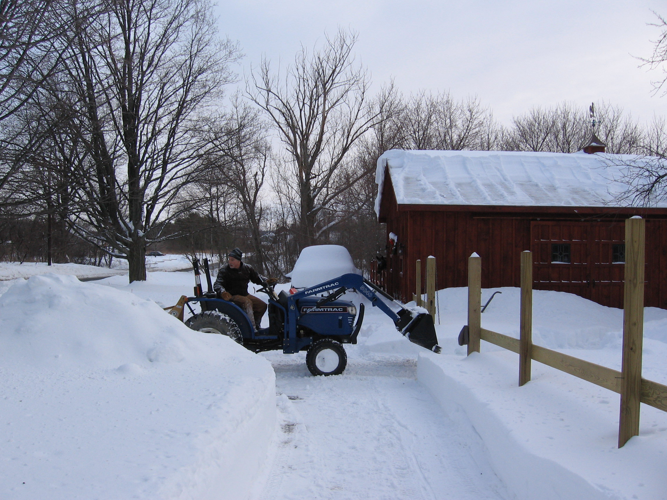

Come winter I use Rotella 5W40 synthetic, a dose of Power Service mixed in with fuel, and a magnetic heater slapped up under her belly and she fires up first time, every time.
