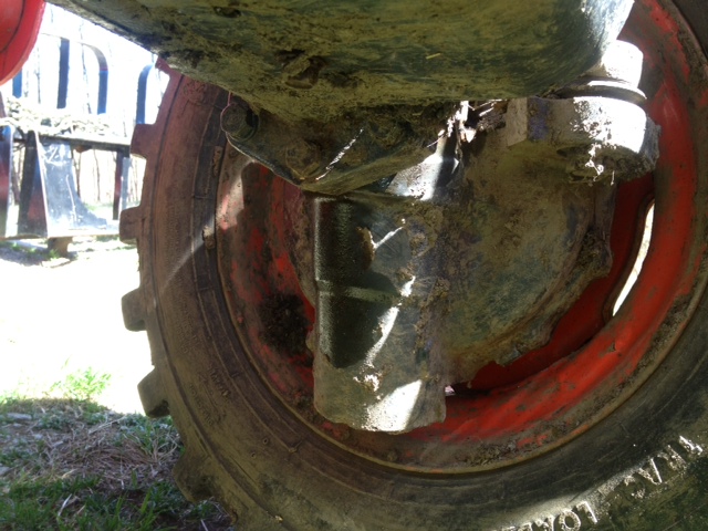

Hello,
I have a Kubota L4330 HST with about 365 hours on it. Over the winter I noticed the front right axle(while sitting on the tractor) was leaking
Now that the snow has melted I crawled under the tractor to take a picture so that I could get some help figuring out what I needed to do to fix this. I noticed that the left side is now leaking a little bit as well. So this is something I want to fix.
Here is a picture of the left side. The right side has more fluid leaking onto the can looking thing near the wheel.
So can anyone help me out? The tractor is primarily used for plowing snow in the winter and pulling firewood, brush hogging and loader work in the summer.
Hopefully this picture attachment works. Thanks for your help.
/ 4330 leaking front axle #2
Looks like the seal is leaking where the front wheel steers.
My 3830 had same problem. I took it to dealer and they installed a new seal. Problem solved. Only my left side had leaked... Right side never had issues. My tractor has 720 hours on it.

Thank you both for your reply. Do you know what the seal is called? Any special tools needed to do the repair myself or anything I should know in advance?
/ 4330 leaking front axle #5
Have a look through this thread for a diagram and description of the parts and how to replace them. Many TBNers install their own, but others rely on dealer service people. It's good to clean the area well before taking it apart.

I stopped by one of the dealers in the area to see if they had the parts instock. They printed out the parts diagrams and recommended that I do a tear down so that I can see if I need any bearings or any other parts and then come in to order the parts they didn't have instock. They were very helpful. They mentioned some of their technicians do this repair with the axles on the tractor and some people take them
Off and do the work on a bench. So now I just need to find the time to tear it apart.
