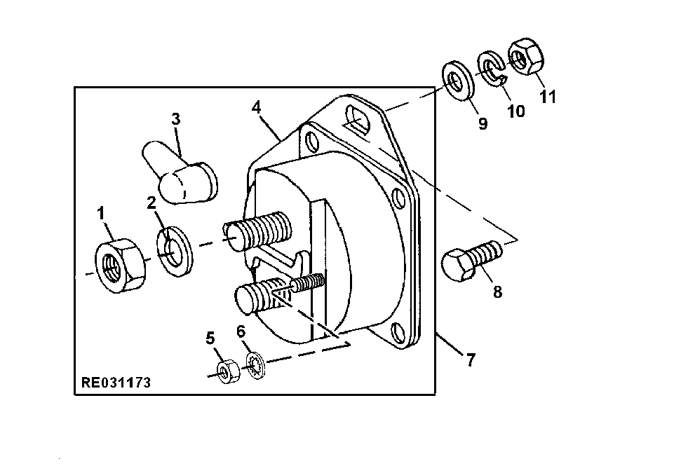

I have a 2005 JD 4320 HST tractor that won't even turn over if the temperature is freezing or below. Not sure on the exact temperature for sure??? We try to start it some mornings a just hear a click of the fuel shut-off, nothing else. No voltage getting to the solenoid. Wait till after lunch and it turns over and cranks like it should, it has done this a couple of days in a row. My first winter with this particular tractor.
Any ideas?
Any cold weather relays?
Need to warm the glow plugs up?
Thanks,
BigTex1

The 4320 wiring harness diagram shows one LVA13729 relay. Remarks (40A NO, 30A NC, 14VDC) don't specifically identify it as the starter relay, but it's in the right amperage range. That's where I'd check first. There's only one other relay in that diagram; the 70 amp LVA13701. But the remarks link it to the glow plugs.
//greg//
/ 4320 starting problems #7
I agree with greg_g that it either a relay or starter solenoid problem IF the battery & cables are GOOD.. A simple fix would be to add another relay similar to what JD did on some larger utility tractors. The extra relay sends more amps to activate the starter solenoid.
