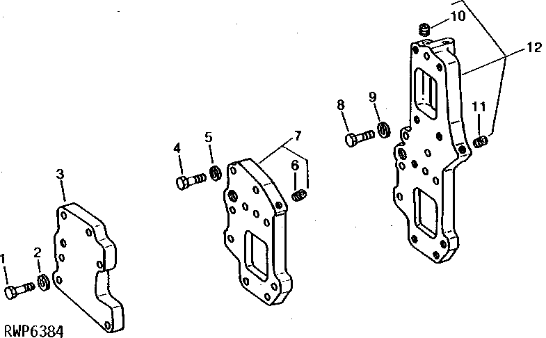

JD 4320
Due to the ever changing AG equipment , I would like to add a third hydraulic control valve to my old work horse , and am looking for information on adding one to this tractor .
/ 4320 JD AG Tractor #2
You'll need the plate(parts key 12) AR71189 plus the 3rd control lever to add a 3rd scv. An alternate option would be to add a valve similar to one used for FEL.
