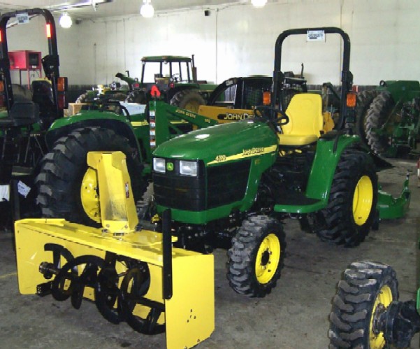

hi, we also have the jd 59 snowblower on our 4310 ehydro. we love it.as stated earlier moved any and all snow that came our way this year and blows it out a good 30+' depending on snow.in our deal from kc canary fultonville,great people to deal with,it was 3500.00 this included install of any brackets etc. as stated above hyd chute rotate but manual height adj.we don't have a fel but can take off or install just the blower fairly quick,but don't have to remove any brackets and leave the drive shaft in,we use a 3 point mower with ours. i'll try and find a picture from this winter blowing snow.if you have other questions feel free to ask.
thats our set up before delivery last year. can't find the ones from this winter right now but will continue to look

Thanks mopar. I don't have a lot of driveway to clear and have always done it with a 3PH mounted blade (7') facing forward. I pull the snow nearly to the end of the driveway and then use the FEL to pile it off to the sides. I use a walk behind snowblower to cut a path from the front of the house, around to the back and then to the barn. This takes the most time. It will be nice to get rid of the walk behind and the blade.
Do you find the need to fiddle with the chute height adjustment much or do you just set it and forget it?
Have you ever chewed into hard packed snow, such as a snow bank, with it?
With no cab, how is the snow blowing in your face factor? I realize you want to blow down wind but somtimes the wind is changing directions, gusty or you just don't want to blow snow in the direction of down wind because of house, cars etc.
Thanks for the picture. I showed it to my wife to let her see what else I was adding to the 4310 package. I have not got her to say "uncle" yet so next up is a tiller /forums/images/graemlins/grin.gif

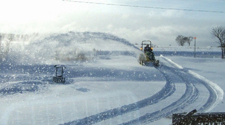

we mostly keep the chute at one setting and go.as for the snow blowing around we get in our snowmobile suits including full face helmets with heated shield pluged in,we have a plug mounted on tractor for this,and let the snow blow where it may,i've got to find those pictures!! the only real hard pack we have had is at the end of the driveways where the plow dumps the snow,no problems.we have broke 2 shear pins on the auger only due to some rocks,our drive is bank run gravel,but they are a breeze to change less than 5 min including getting the wrench,it's all done from the outside,no cover to remove and the blower comes with 4 mounted right on board with it.
/ 4310 Snowblower (front) #9
finally found a couple of pictures
here's one

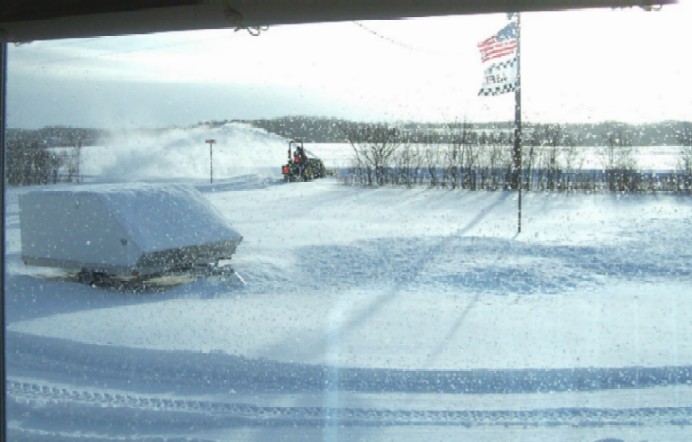

and another up by the road in the plowed stuff no problem at all /forums/images/graemlins/smile.gif

Thanks mopar.
Snowplow residue at the end of the driveway is no problem for me. I have a deep drainage ditch along the edge of the road. Virtually all of the snow from the plow goes in the ditch before it gets to the mouth of my driveway. If I can drive through the snow that's fallen, I can get out the end of the driveway with out clearing snow.
Do you use ballast weight on the rear with the snowblower installed?
Jeff
