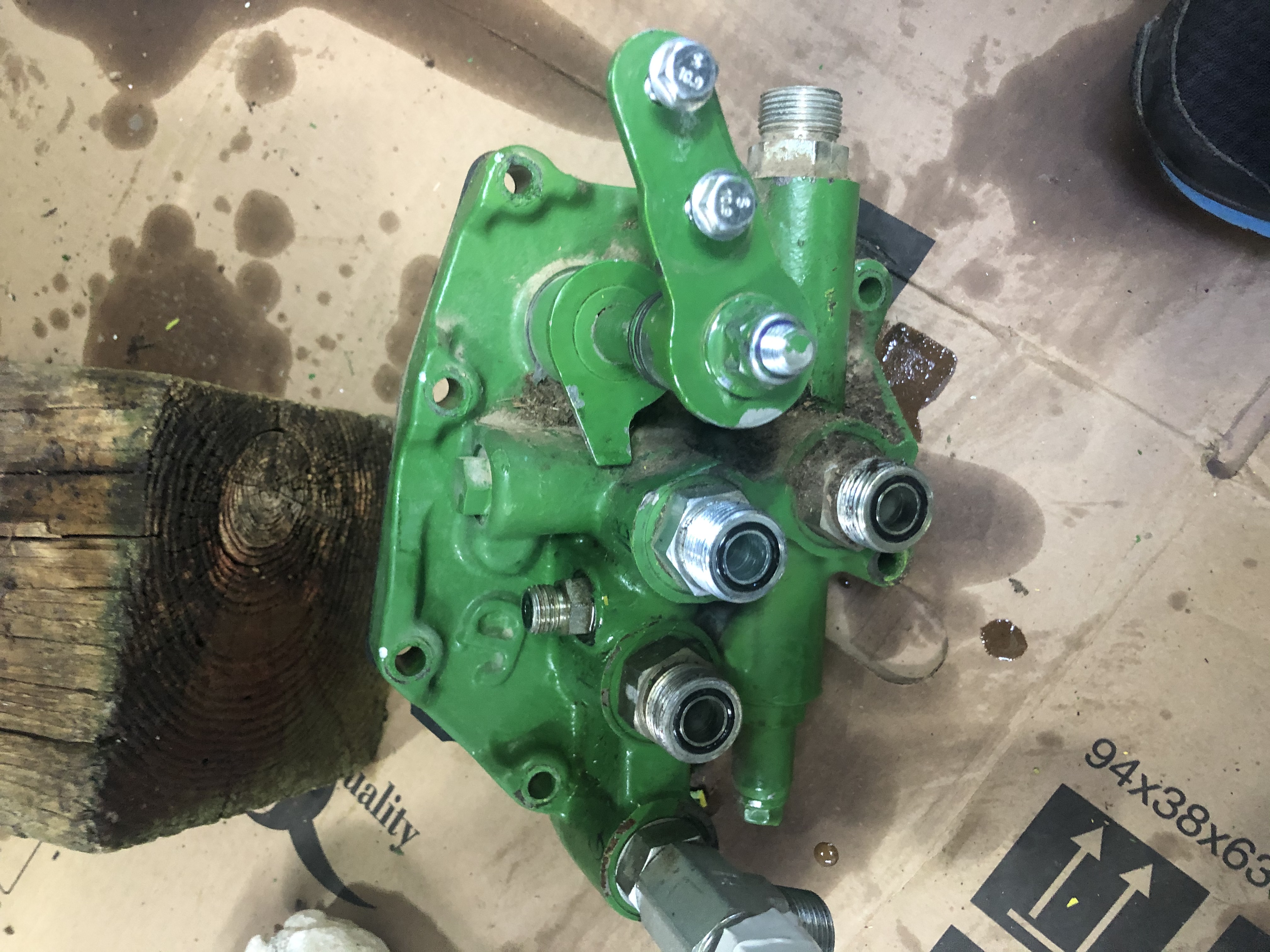

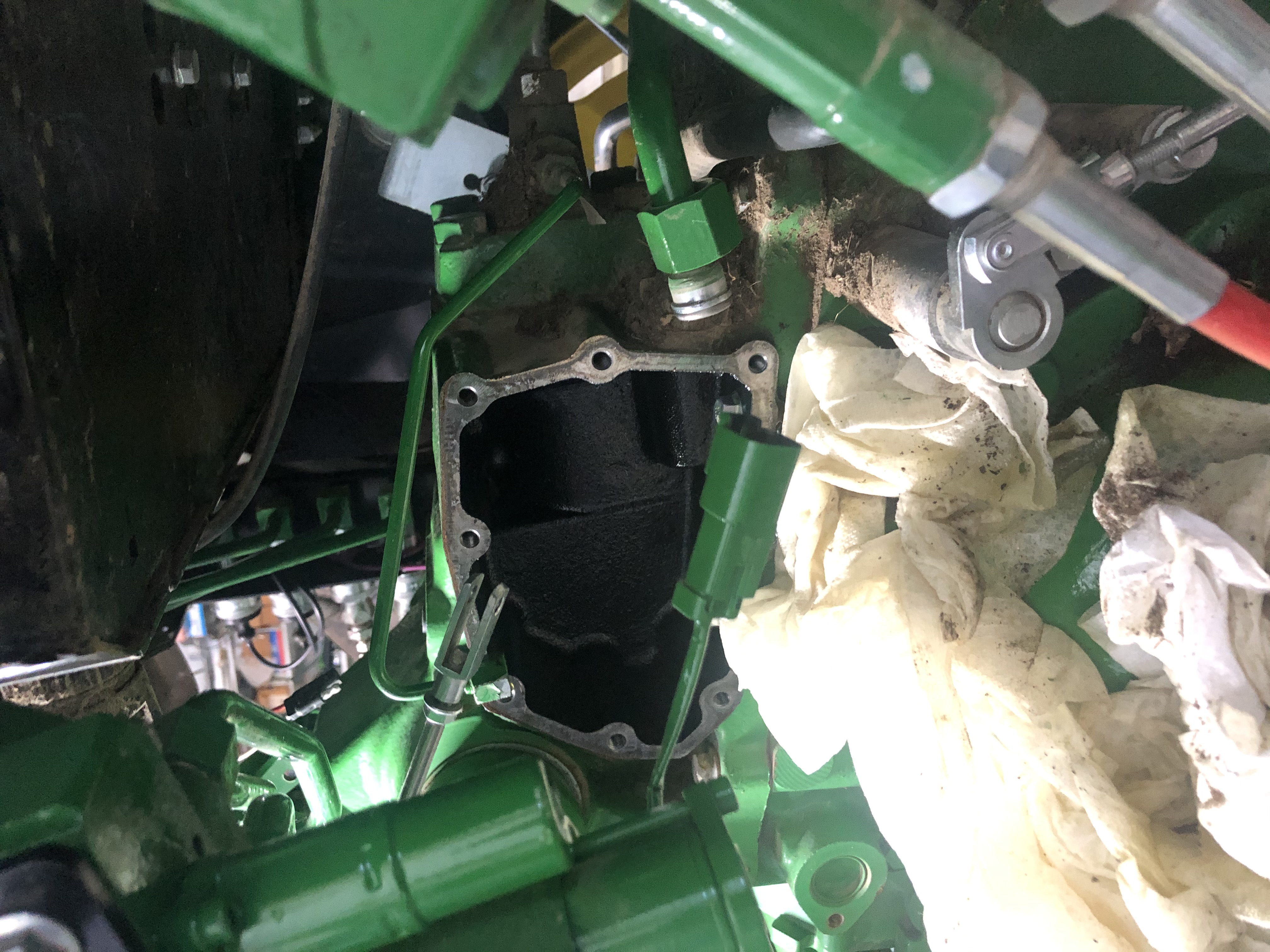

You were spot on Kyle. After some deliberation decided to tear into this repair this weekend. I removed the rear tire and cover place. After marking all the hydraulic lines and taking some pictures, I removed all the lines that were connected to the rockshaft manifold. I then removed the linkage for the 3 point lever. Eight bolts are around the manifold and I removed all of them next. IMG-2072.jpg

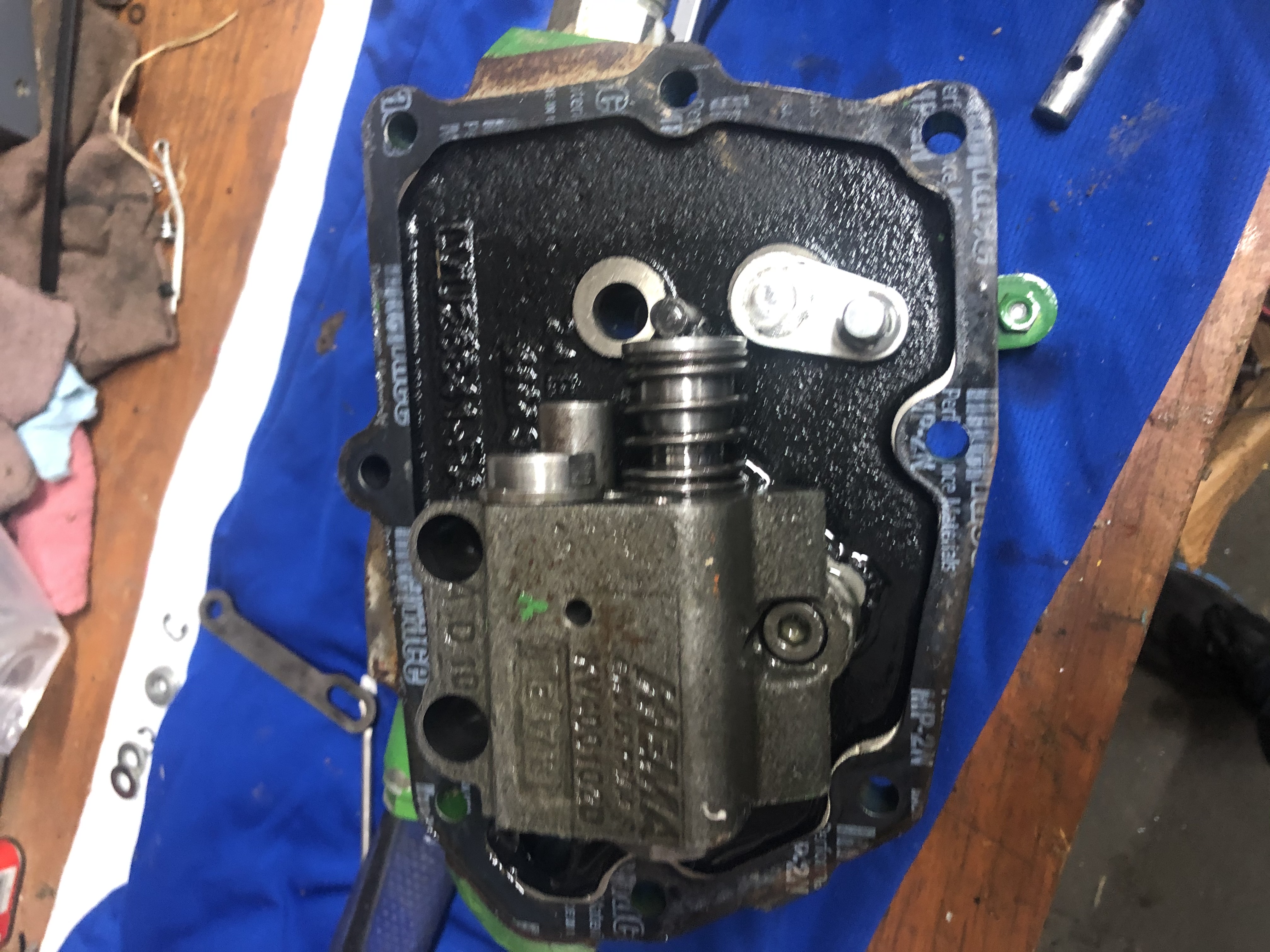

The manifold fell away from the tractor without any prying and the gasket was intact. IMG-2073.jpg

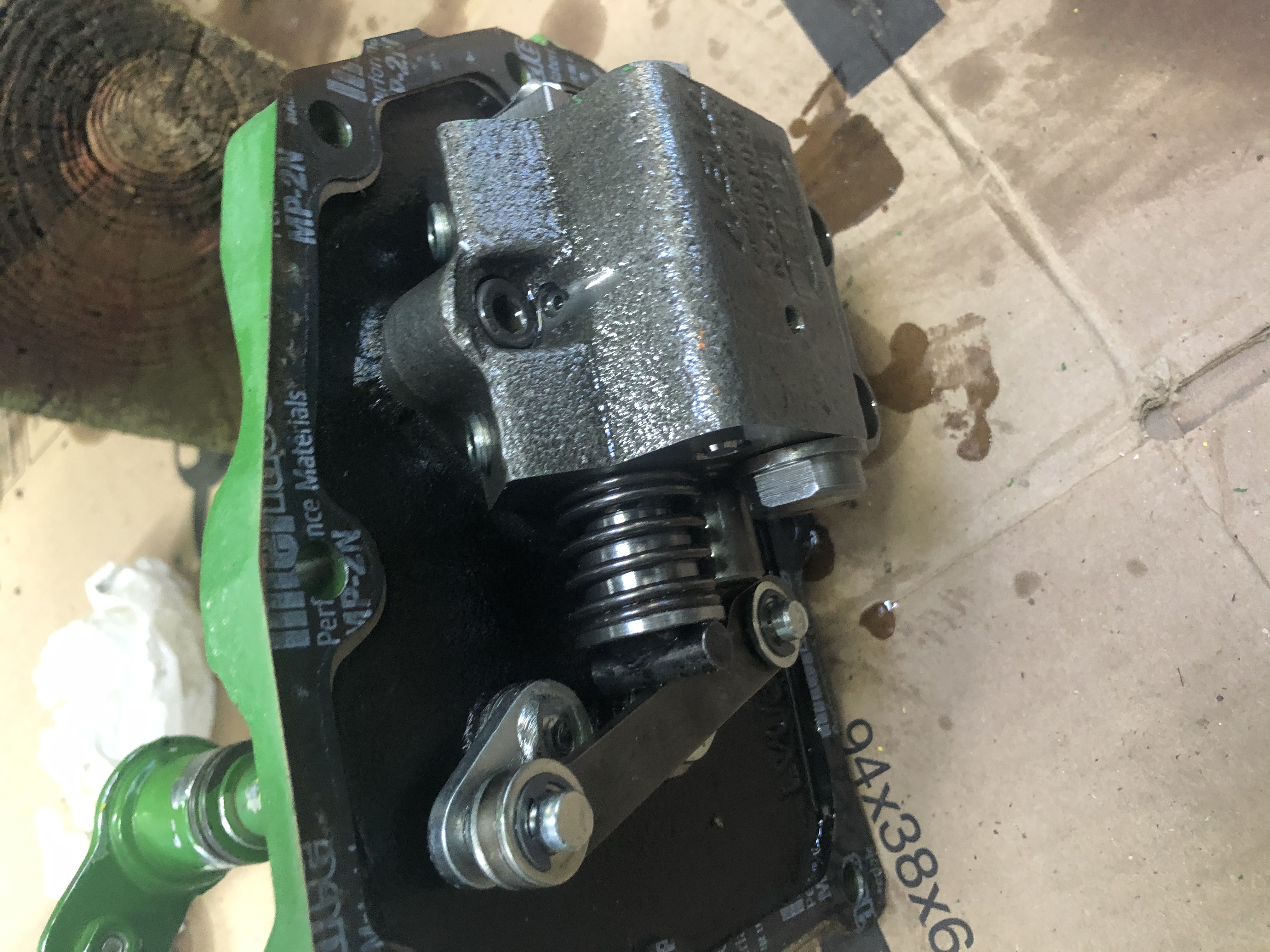

The valve is on the other side of the manifold and so are the control levers. The bottom shaft is the one I was having trouble with, very stiff and almost impossible to rotate. IMG-2075.jpgIMG-2074.jpg

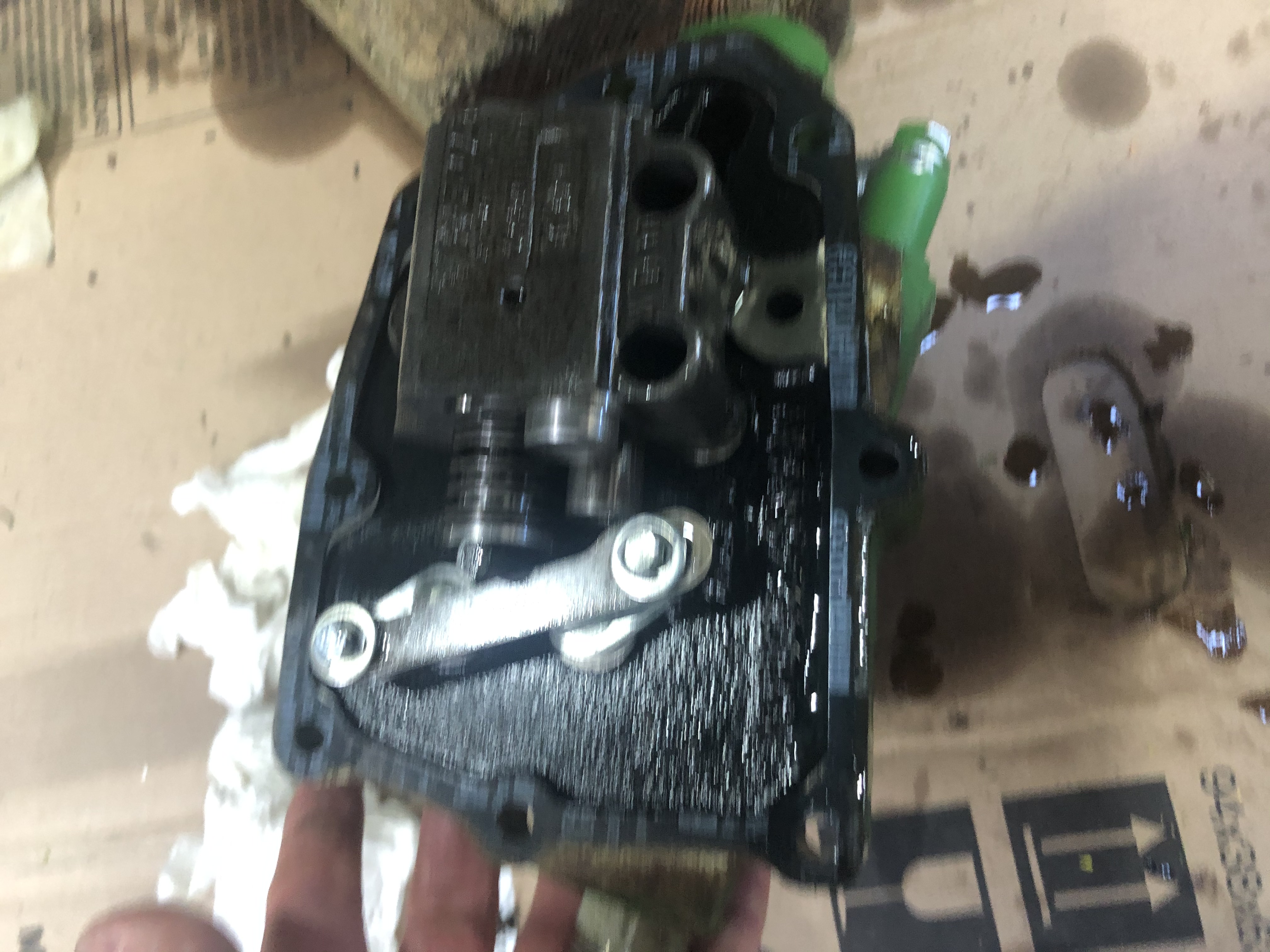

After removing the snap rings and the connecting rod, I was able to drive the shaft out of the manifold with minimal effort. IMG-2076.jpg

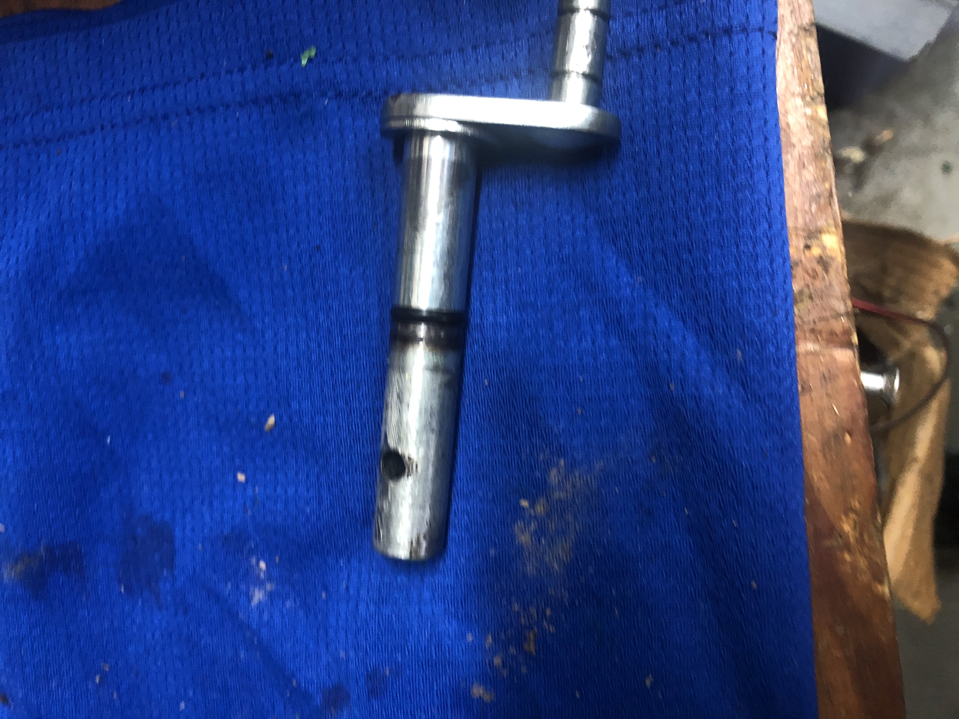

The shaft seemed to be in good shape but i removed the o-ring and polished the shaft on a grinder with a wheel brush. I then cleaned out the hole in the manifold with some 400 grit sand paper.
IMG-2079.jpg I greased the shaft really well and installed a new o-ring. I re-installed the shaft and tapped it back into place with a hammer. the shaft rotated with ease and worked like it was supposed to now. I put the linkage and snap rings back in place on the shafts and re-installed the manifold.
