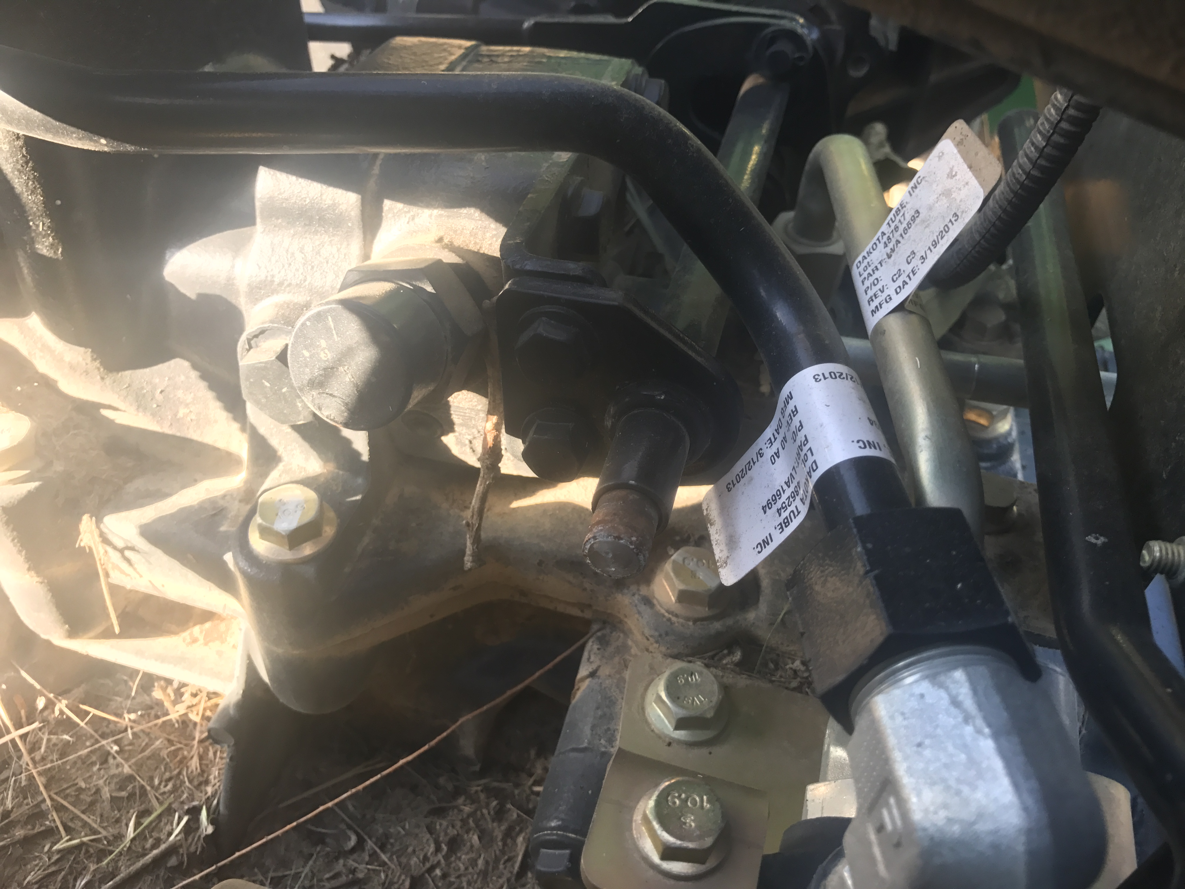

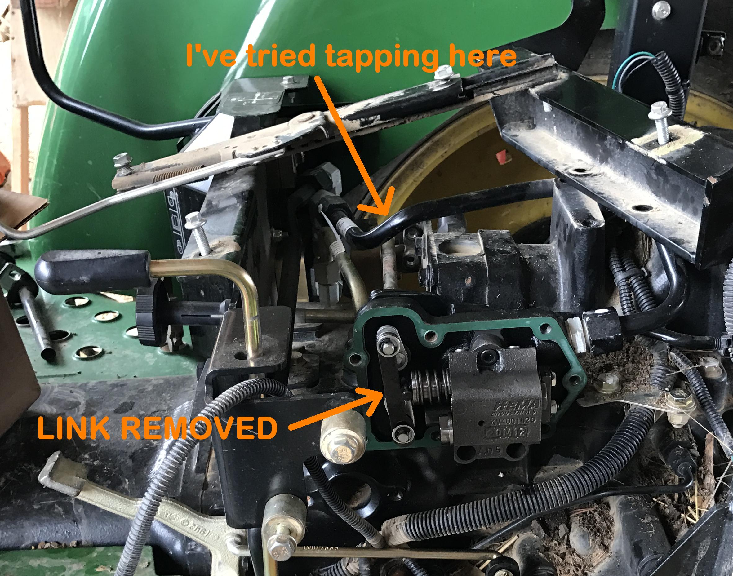

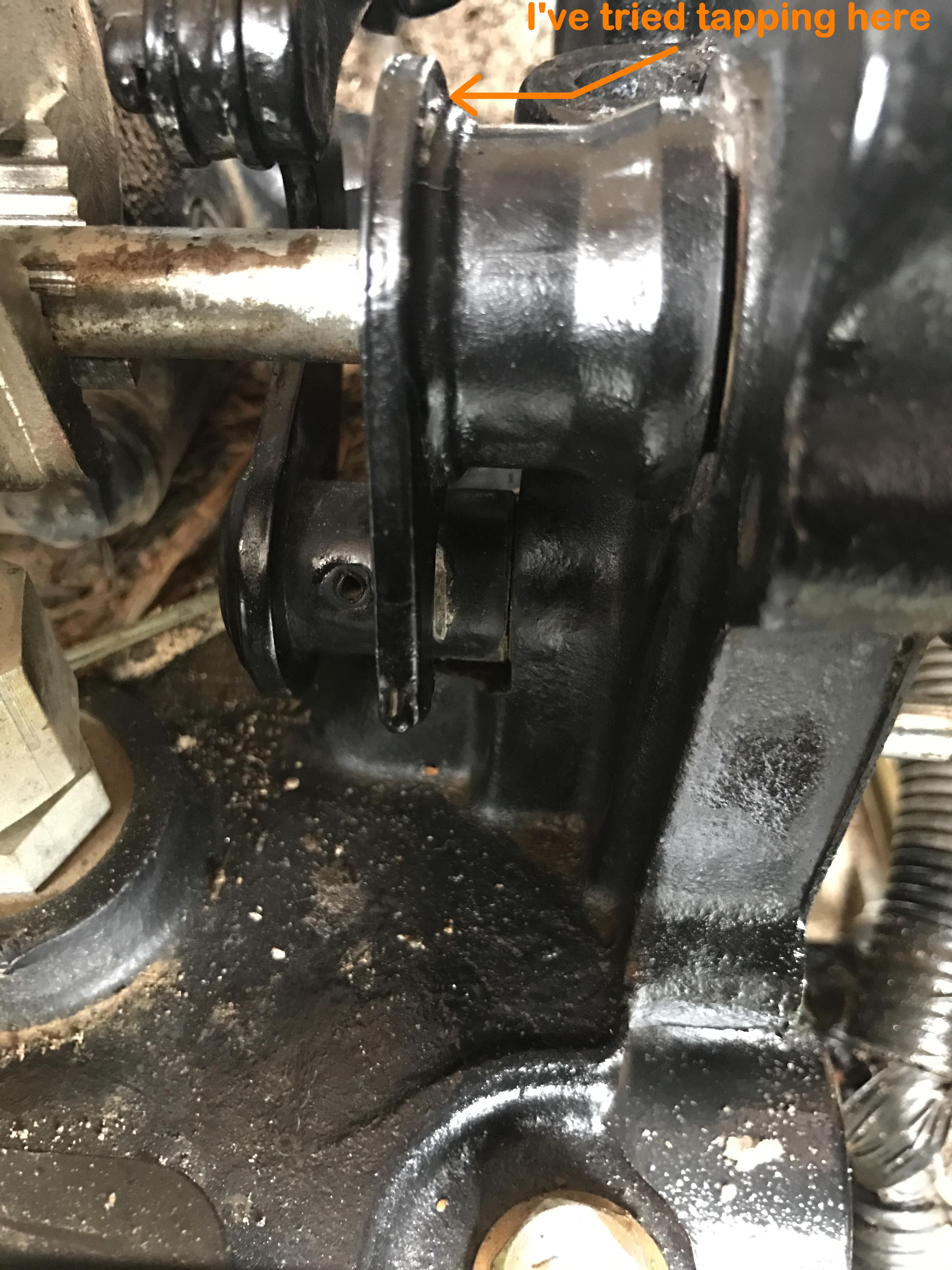

Kyle I'm assuming the key is under #13 and that part won't budge from the shaft. I removed the left tire/fender and have good access. I've tried tapping the shaft AND tapping part #13. See pictures. ORIGINAL PROBLEM remaining shaft.JPGNEW PROBLEM.JPGVIEW FROM SIDE.jpg
   / 4310 Rockshaft repair and filter replacement #23
Have you tried applying penetrating oil? Even a good one like Kroil or 50/50 mix of ATF and acetone might take several days to work. Warming the part to spit sizzle can also help, and applying the penetrating oil as the part cools will help draw the oil in.:2cents:

Welcome to TBN. Your pic that points to the shaft end where you have tried tapping, I believe is the correct thing to do. I remember having to get a 3 lb sledge, having only a very small space to swing it. I made a custom length shaft to punch the end of it. Try what RNG told you. It is rusted and stuck.

Thanks all for the replies. I got some penetrating oil and put some elbow grease on it and, after some sanding to knock off the rough spots, got it out. I buggered up the gasket though on the valve casing and out of service until I get a new one. a 50 dollar part and 20 hours for a novice to get everything apart .. As soon as it's done I'll be trading up to a 75hp JD ... of course that will be a new thread for advice !!

Good deal. Make sure you get some sort of wire bristle brush to clean the rust on the inside that the shaft slides through. and then GREASE IT!
