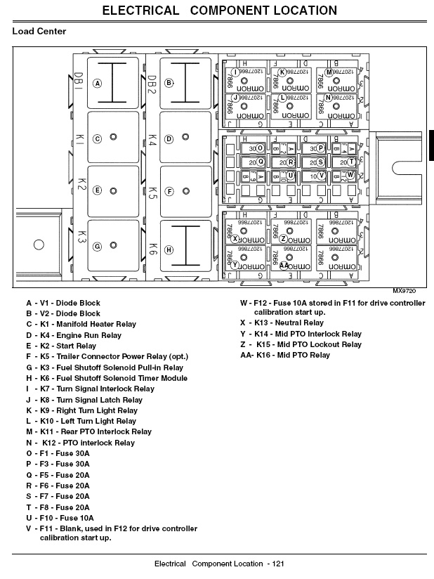

I tried firing up the rear pto in my 4310 after a month break, and although the dash PTO indicator light lights when I pull the switch, the PTO does not engage. Just before I left town I mowed, and then put the tractor inside the barn where it sat until Saturday. The battery was weak when I got home but it did start.
I've checked and do not see any loose wires or connections...and don't see any bad fuses, though the operator manual is about useless for electronics. Anyone have any ideas ??? Thanks for any suggestions.

thanks...I went by the dealer today - I was able to pry out of the service rep that it's probably a bad relay (however my guess as to which one - nothing in the manual or fusebox identifies which relay might control the pto).

It could be any number of things. Dirt dauber nest, etc...
I would start at the seat switch and check underneath to look for loose wires.
Here's a snapshot of the relays out of the handbook.

Got it!
Actually first thanks to several of you who posted similiar problems I found archived...thanks also Kyle for the relay info...
now, after going over all of the wiring, fuses, relays, etc...and testing for current...I beat (well, maybe a really hard tap) on the box the solenoids plug into, and...it works. Must be either a piece of debris in the solenoid or it just froze up. Hammer to the rescue!
