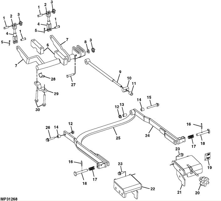

I just picked up a 4310. It's in nice shape, with one glitch: I cannot get the mid-mount deck to raise or lower. It just sits on the ground.
The cylinder is attached via pin to a slot in the Lift Arm Weldment:
When I activate the hydraulic lift, I can see that the cylinder fully activates. As the cylinder activates, the pin travels the entire length of the slot in the Lift Arm Weldment, but that's all that happens.
Here is a bigger picture of the whole shootin' match. The offending pin, in the Lift Weldment, is just above the green Draft Arm, to the left of the filter:
I'm not sure how the lift system actually works beyond that though. It's not clear what purpose the pin sliding back and forth in the slot actually accomplishes, since it's front-to-back travel (no vertical travel, so what activates lift??)
Is anyone familiar with this problem? Any obvious troubleshooting steps?
The deck was already attached to the tractor when I loaded it up. My next step would be to remove the deck, and re-install from the beginning to make sure everything is connected the way it should be.
Thanks in advance for any tips!

Are the lift links hooked to the deck? I can't see them in you photos, but they may just be hidden behind that green guide-link arm. If they are attached, maybe they are adjusted too long.
Purpose of the slotted bracket: the depth-stop adjustment knob is at the front end of that heavy rod connected to the slotted bracket. As that bracket tilts backward it rotates the deck rockshaft (which should be connected to the deck with two lift links) lowering the deck until that depth-rod stops the travel - based on how the depth-knob is adjusted. That pin in the slot is connected to the hydraulic cylinder that raised the deck by pushing the bracket forward. As the cylinder moves backward the deck will drop to the set depth limit - the slot allows the cylinder to continue to its fully retracted position while the deck remains at the level set by the depth-knob. Sorry about the convoluted explanation, but hopefully it makes sense to you as you look at your setup.

Are all these parts there? A stop by the Deere dealer to get a deck manual if you don't have one (with the installation/setup instructions) may be very helpful. I too suspect the height control knob but also suspect some missing part/parts.
This is for DECK SN M04260X, -M04272X so may not be for your particular deck. See jdparts for further breakdown of your particular deck.

Try to determine why the rockshaft isn't coming down (the weight of the deck should pull it down when everything is adjusted correctly). It appears to be stuck in the full up position (when the cylinder is in the full forward position the up-stops on the deck should be nearly touching the tractor's belly - I think a 1/4" clearance is reccomended).
Also sounds like the rear lift links are adjusted too long (I am assuming the yoke at the front of the deck is installed? If that yoke is correctly installed and adjusted, and the two green guide links are correctly installed: then the rear lift links should raise the whole deck .

I think you are describing how the lift should work correctly.
I believe you are mistaken about which position it (the weldment/rockshaft) is stuck in - I believe it is actually in the full UP position.
There must be something wrong with the deck connections to the tractor: the lift links may be adjusted out too long or there could be a problem with the front mounting yoke (the metal loop that attaches the front of the deck to the tractor frame). With that yoke correctly setup and the two green side-link bars in place: lifting the rear of the deck should lift the entire deck.
The rockshaft will only move downward IF the weight of the deck is pulling it down. You might try using a prybar (I kept a 3 or 4 foot piece of 2x4 handy when I had a similar setup) and see if you can manually rotate the rockshaft to the DOWN position (pry at the rear end of the rockshaft arms, where the lift links attach - the arms should rotate downward untill the stop-rod or the end of the weldment slots stop them). The rockshaft could be frozen in the bearing blocks, but I suspect the problem is with the deck linkage because as I understand your description: the deck is already on the ground (so it isn't pulling the rockshaft down).

In poring over the manuals, I realize that, when I first started troubleshooting, the draft arm was connected to hole A in the draft arm support bracket (4210 fashion) rather than hole B. That could allow the deck to sag too much. I'll go out and reinstall the deck and see if that doesn't fix it.
"1. Draft supports have three holes for installing draft arm:
For 60-inch mower installation on 4200 and 4210 tractors, install draft arm in center hole (A).
For all other installations, install draft arm in front hole (B)."

It finally stopped being soggy outside, and I stopped being too busy with my job to get out and have another go at the mower deck. I like working on the tractor better than working at the job, although the job pays better. :laughing:
It's fixed -- it was the position of both the draft arms AND the front yoke J-hook positions. The deck was attached to the tractor, front and back, as if it were a 4210.
So basically the lift arms were letting the mower deck sag too much, and moving the J-hooks to the rear holes on the front yoke bracket, and re-pinning the draft arms to the front holes, created more more lift on the deck.
I'm not impressed with how little lift there actually is - heck my X500 has more travel. And now I've got a front-to-back level problem and the adjustment collars on the front yoke are frozen solid (they're soaking in WD40 now). But it's working, basically.
