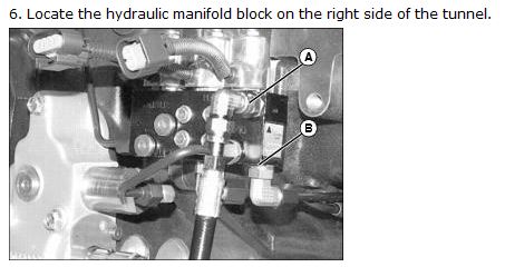

jk,
Your "shimmery" oil concerns me. You should also replace that suction screen with the hole in it. You can test the system pressure:
Attach your gauge at point "A". You should have a minimum pressure of 135 psi at idle maximum pressure of 175 psi.
