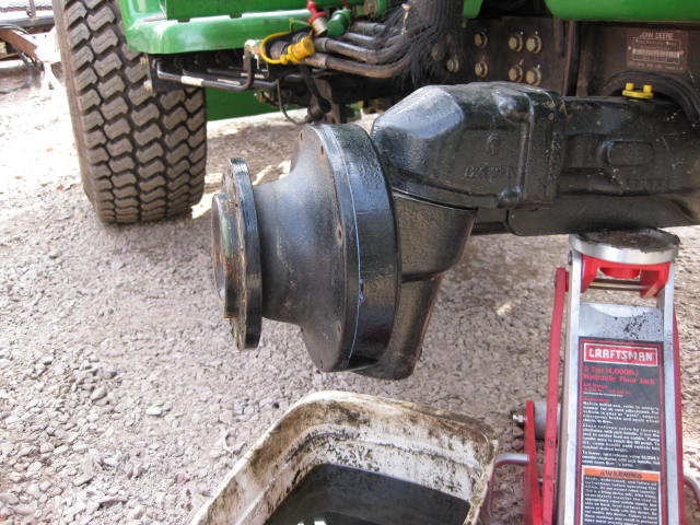

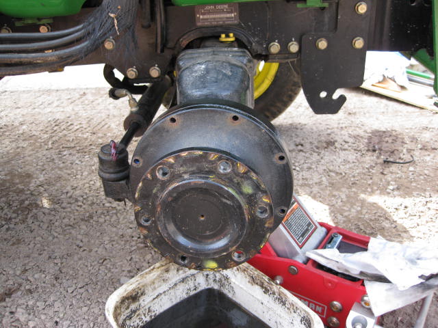

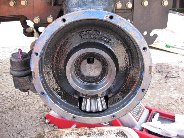

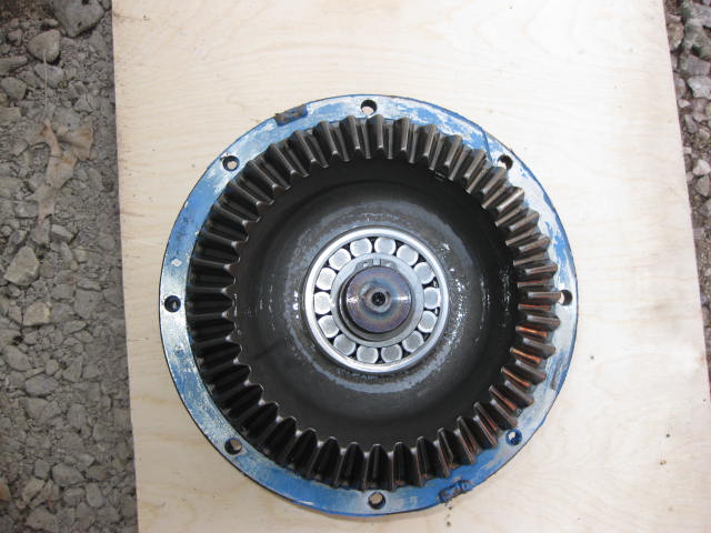

I had the seal go out on the rt. front hub. I have the manual and thought, I can do this my self. Everything went well, the seal was 25.00 and some oil. To press it apart I used a gear puller. To put it back together just some heat to slide everything back together.

Thanks for the pics.
I have never seen this assembly taken apart.
How many hours do you have on the machine? Any cause for the seal leaking?
/ 4310 Front axle #5
Yup, good to know it's home doable if the need ever arises, How bad a leak was it? and I'm curious about the hours as well, mine has about 350 hrs.

Thanks guys, The leak was to the point of leaving a small puddle on the floor. The cause?... I was pushing a lot of brush, and I think it might have gotten into the seal. I have about 580 hours on it. I wish I would have taken more step by step pictures. Everyone on this site has helped me so much, it's nice to give back :)
