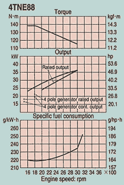

I was always /forums/images/graemlins/confused.gif on the oft-quoted torque rankings (of the 4410) - the info posted by John Miller makes more sense. And if you do the math converting hp and rpm to torque - something just isn't right in the "common" 4410 ranking compared to the 4510/4610. Peak torque is another matter and I wish that number was easier to find for all the models.

I think the possibility exists that at rated speed (2600 RPM) it is quite possible that the torque is higher on the 4410 vs the 4510/4610 engines. I would like to see a graph of it, but as Mr Miller pointed out, the peak torque on the 4510/4610 engines exceeds that of the 4410. While looking at the graphs for another tractor brand, it is apparent that they share a commonality, high torque rise with peak torque typically around 1500 RPM. As maximum engine rated speed is approached, that curve drops quickly. My experience with compact tractors is that the little diesels in them do a very good job considering what it is they are required to do. Rat...

I have made different spreadsheets on Yanmars (& Kubota's & Perkins, etc.) that are kinda in a state of disarray right now... but you asked and you shall receive... /forums/images/graemlins/tongue.gif
(next post)...
John

   / 4310/4410 whats the difference #29
Differences between Yanmars...
........ 3TNE88 -JD4410.........Yanmar..................... 4TNE88 -JD4710
