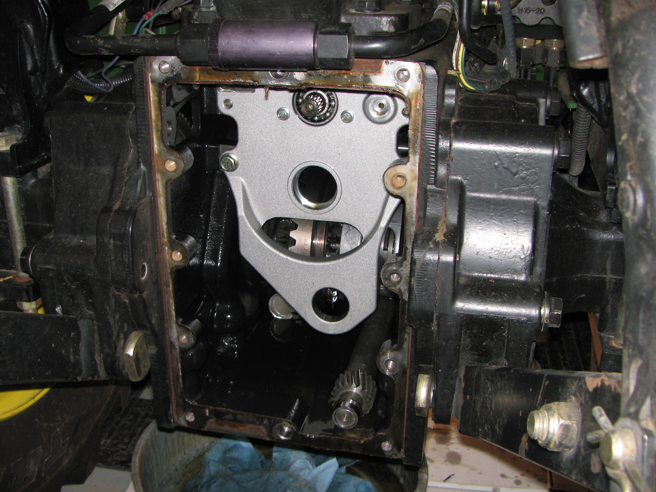

Not hard at all... But a bit scary pulling the heart out of my baby! In retrospect, not a big deal as long as you don't mind looking at the inside of your trans!
Wayne
Wayne
So that's what my girlfriend's guts looks like. That's what my wife calls my tractor.
