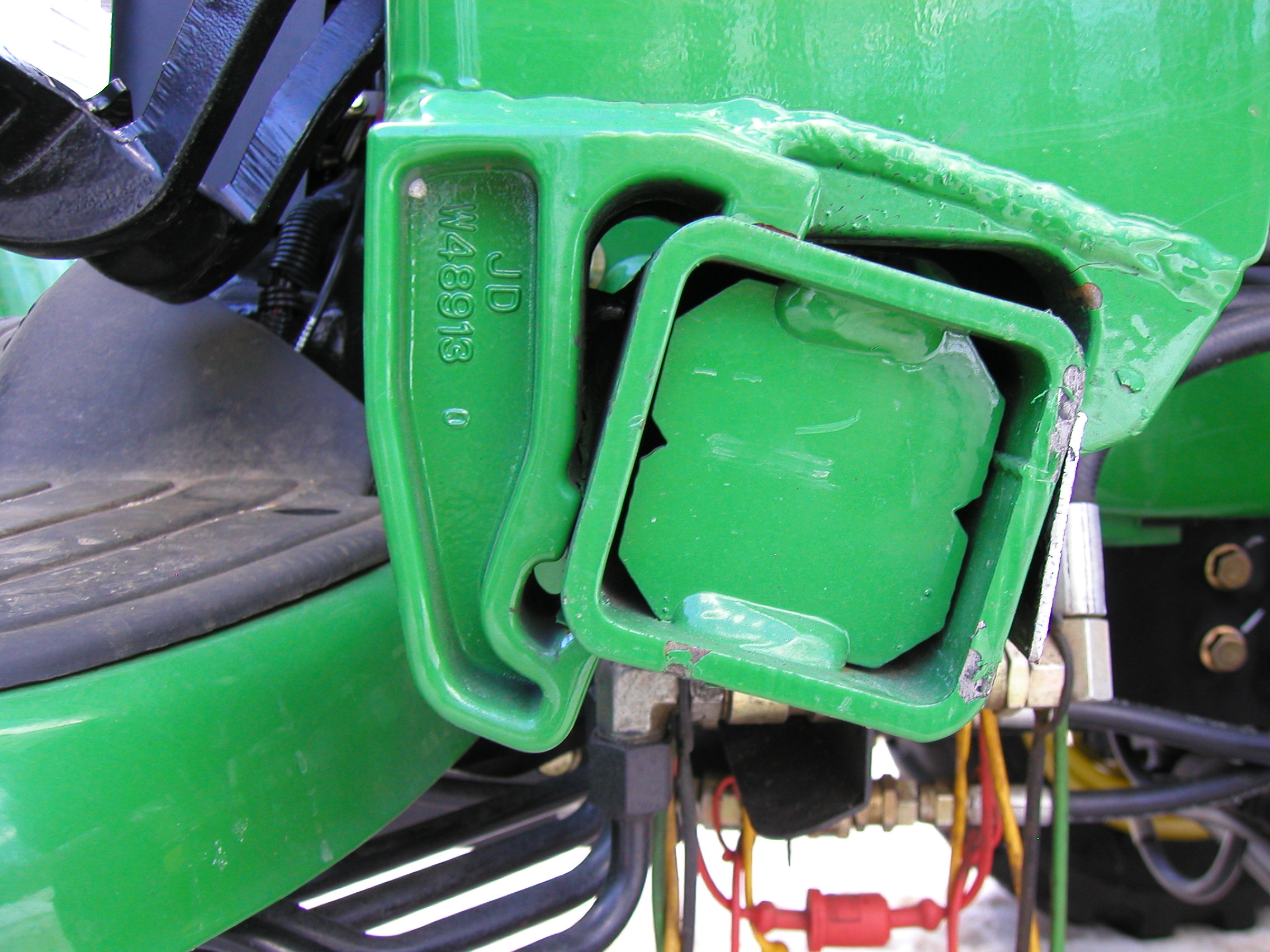

Hello folks.
I'm new to the site so please forgive me if this does'nt come out right.

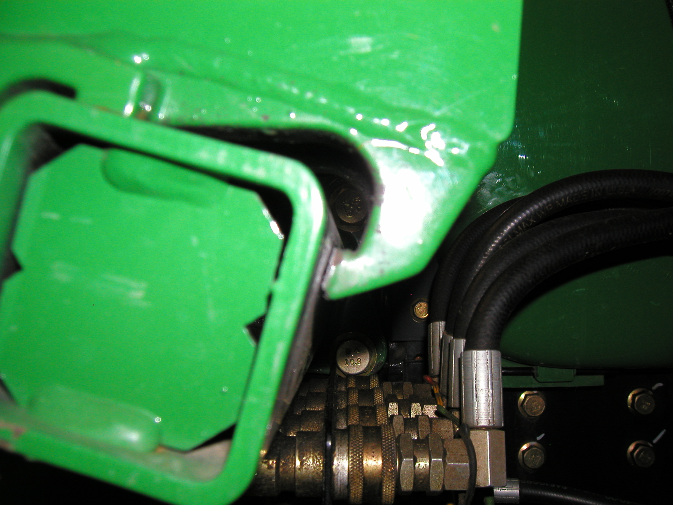

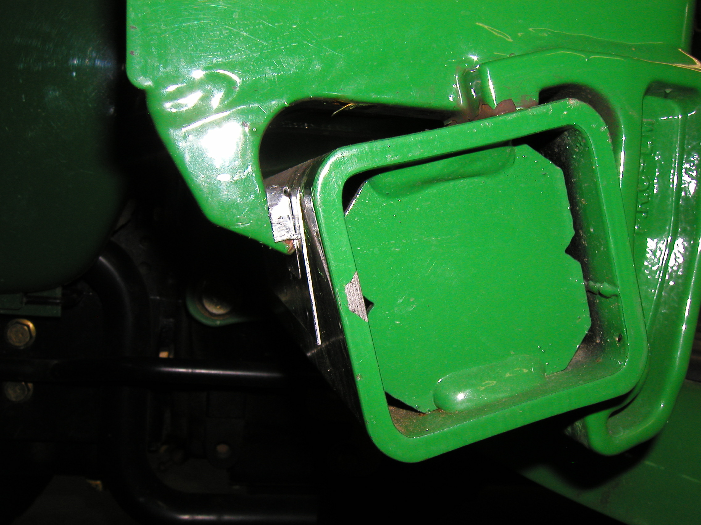

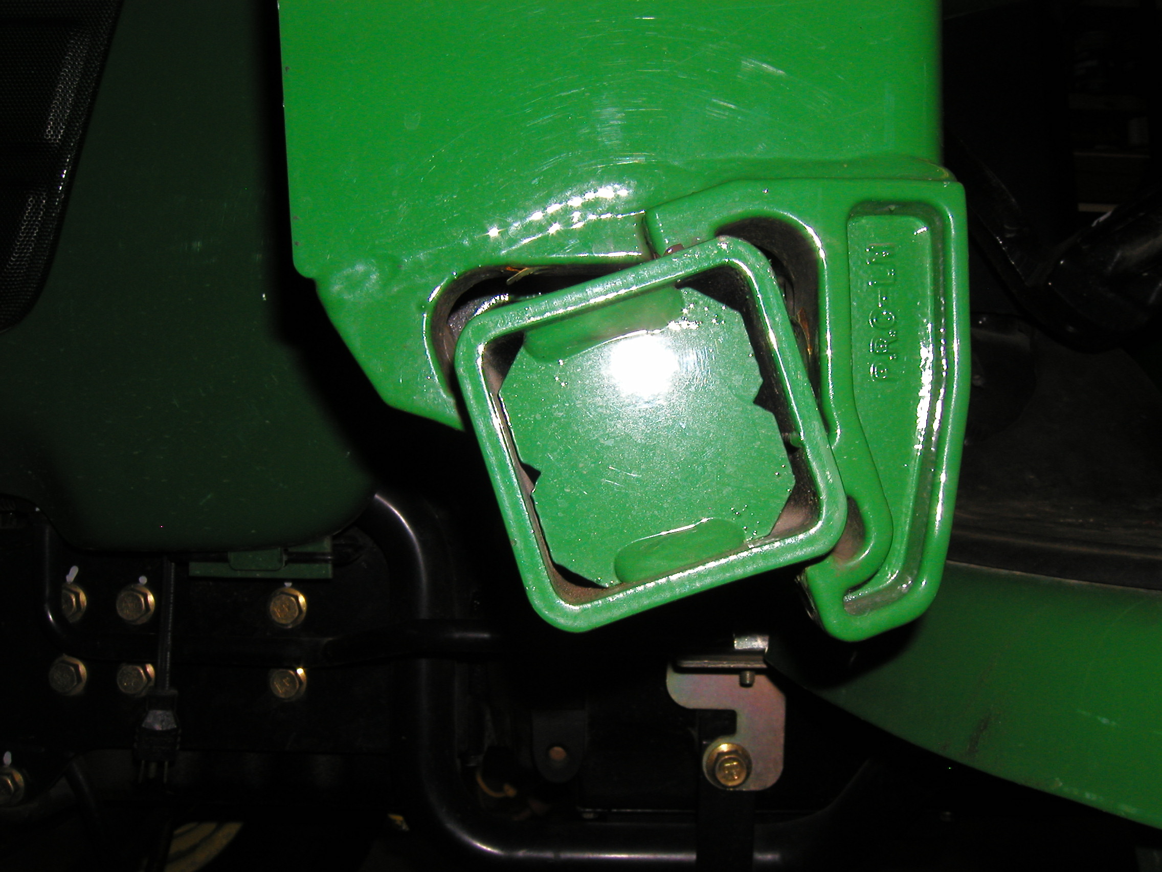

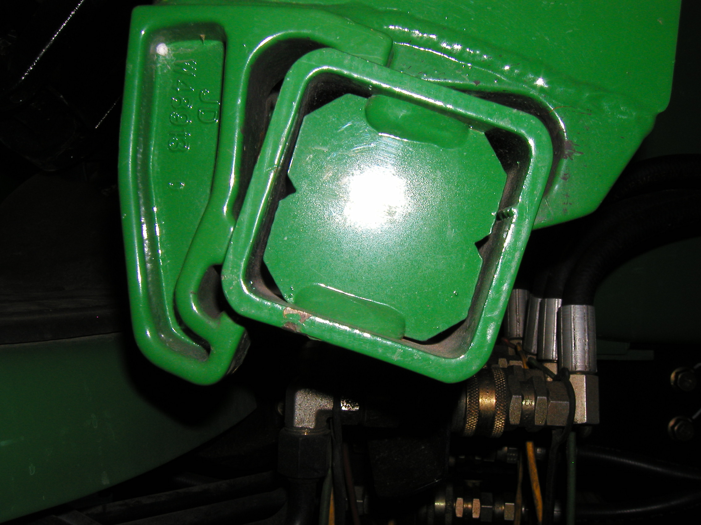

I've got the 430 loader on my tractor and it gets used a lot.
The attachment at the base of the tower is not as tight as it was 425 hrs.ago. There are now spaces between the "claw" and the square mount. This results in a very loose/sloppy loader situation.
The spaces are hard to measure because I don't have a perfectly flat spot from which to start.
I've noticed that there is no wear on the square mount at all. Harder metal I assume.
The dealer has reccomended a shim kit. It would require shop time which = 50 mi. of trucking.
Has anyone dealt with this problem on their own? I was thinking about some flat stock slid in the gaps and secured somehow. I have very limited experience with my old Lincoln tombstone welder. ( basically teaching myself )
I've attached some pics.
Thanks

Probably the easiest way would be to build up the box section where the contact area of the mast latch hits with some welding passes.
Sincerely, Dirt
/ 430 Loader getting looser #4
Adding/welding flat steel bar stock under (BOTH sides) of the support frame struts. The flat steel bar will take up the sloppy fit and will give you a uniform repair.
Much faster than the weld buildup repair.

Thanks for the replies folks.
Dirt; The "claw" section has four contact points. Are you suggesting running four beads on each support bracket. If so, and I hate to ask a welding question here, but the steel on the bracket must be much harder, what welding techniques do you suggest?
Kev; How would you reccommend securing the flat stock?
M; It seems to be loose on both sides.
JD4300; Mine started out that way. A small gap ( 1/16-1/8" in the bracket )translates into a large amount of slop on the far end.
The pictures don't show the gaps well. When stress is off the loader,I can grasp the top of each tower and shake it side to side easily. I don't think it is in danger of slipping off the bracket, but I'd rather not push it and find out.
I'm suprised that this has gotten so bad so quickly. It seems that since I put the toothbar on and dug a lot of earth, it has accelerated the wear & tear.
As I said, the loader see's a lot of work.

IMO - running a bead along the base contact points could easily result in significant uneveness and the "cure" could be just as bad (maybe worse) than the problem.
The insertion of a shim or piece of flat stock would resolve the problem of uneven material filling the wear gap.. but, tacking (I think TIG would be best here) the shims in place; you'd have to pay close attention to the amount of material extending into the open area that rotates when the loader is removed and reattached. You don't want a problem of the loader mast hanging up on the base.
I'd be real curious to learn how your dealer plans to take care of this problem. You mentioned a "shim fix" that was advocated by the local dealer. Did he fully explain what that means?

AK; Evidently, there is a shim kit available from JD. The dealer explained that , due to loader geometry, it is critical to have the machine on a level surface to determine where to shim. There are four points of contact on each side and each wears differently. ( this is the part where my head starts spinning ). Their procedure is to weld the shims in place.
My problem is why should this have to be done with only 425 hrs.?
I remember looking at literature from JD, before I bought my tractor, explaining how the loaders are engineered for each unit and rigorously tested.
Seems to me they should last a lot longer without this annoying problem.
Chuck

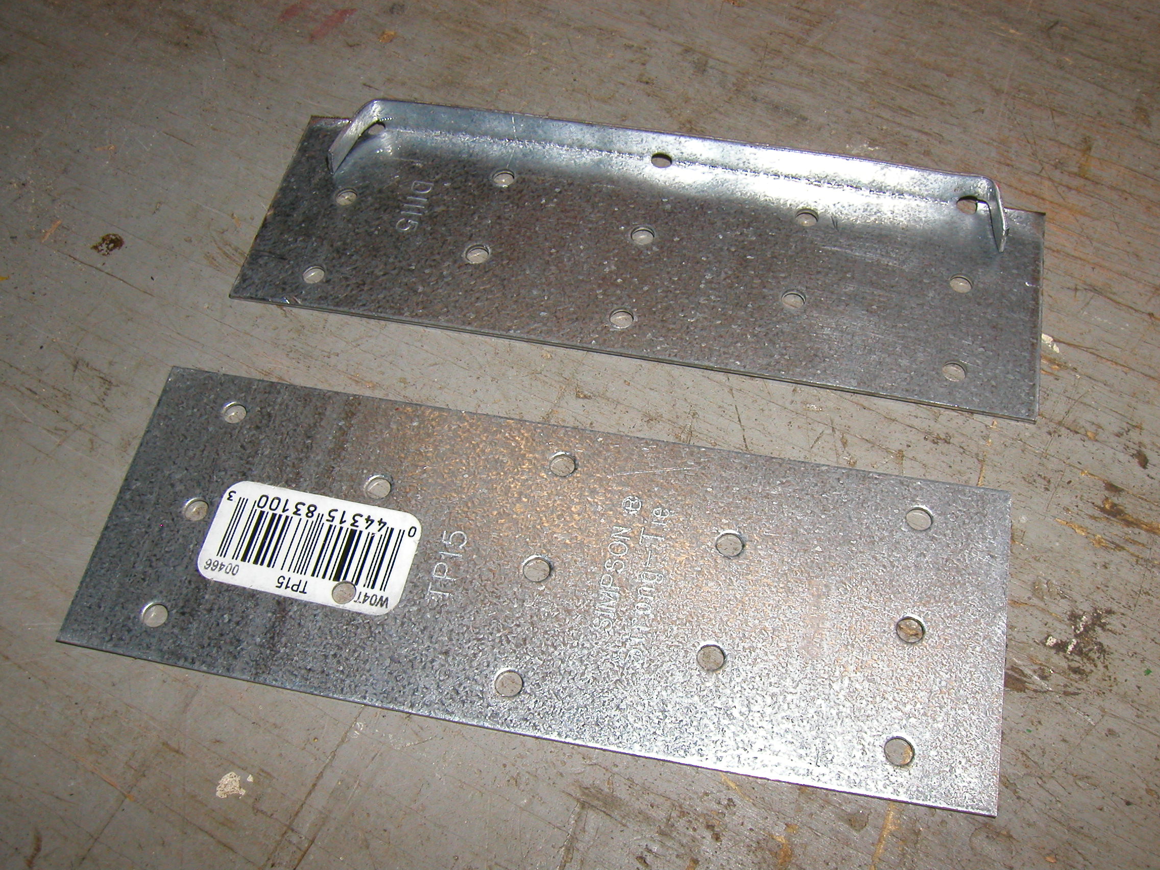

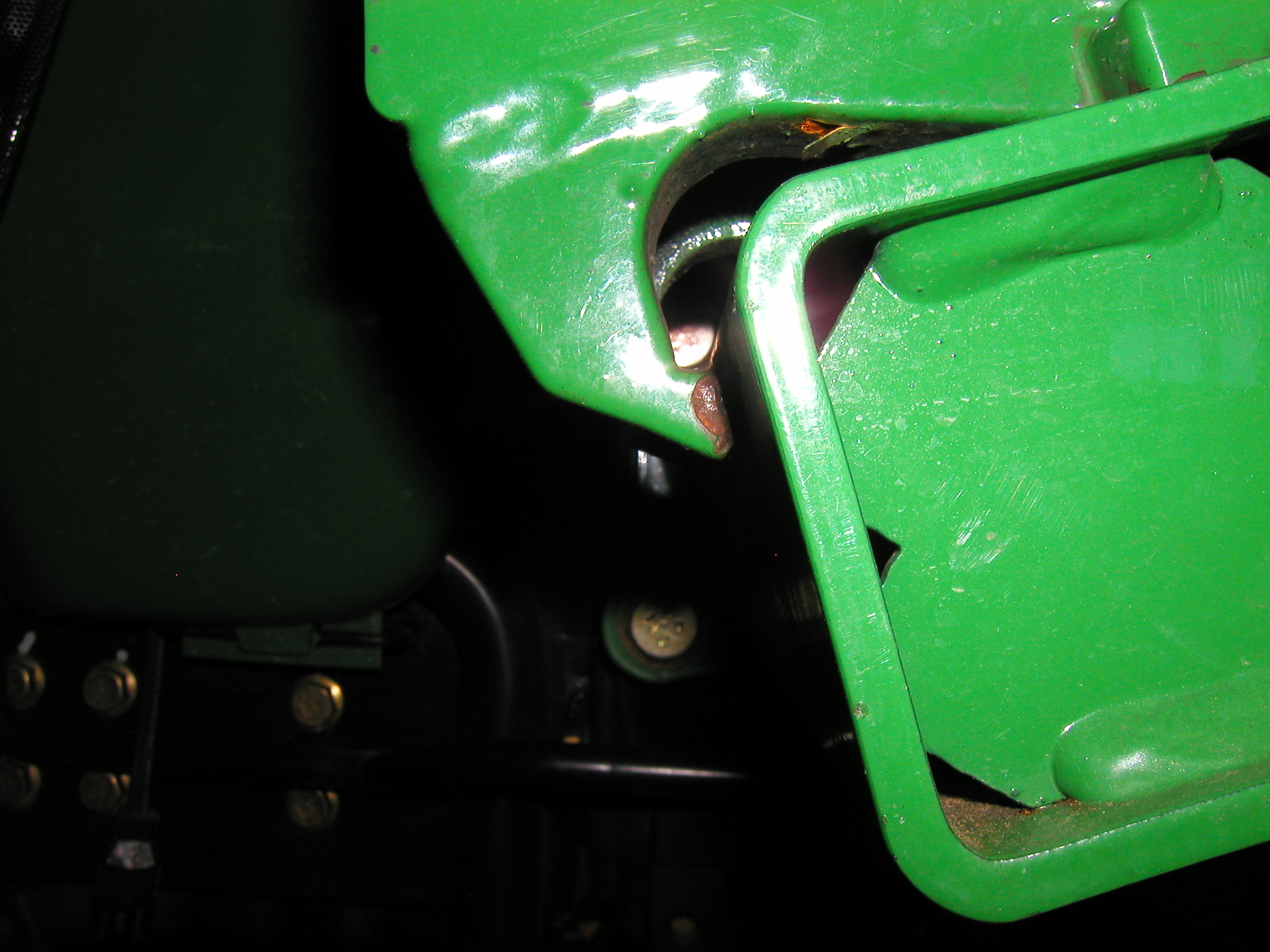

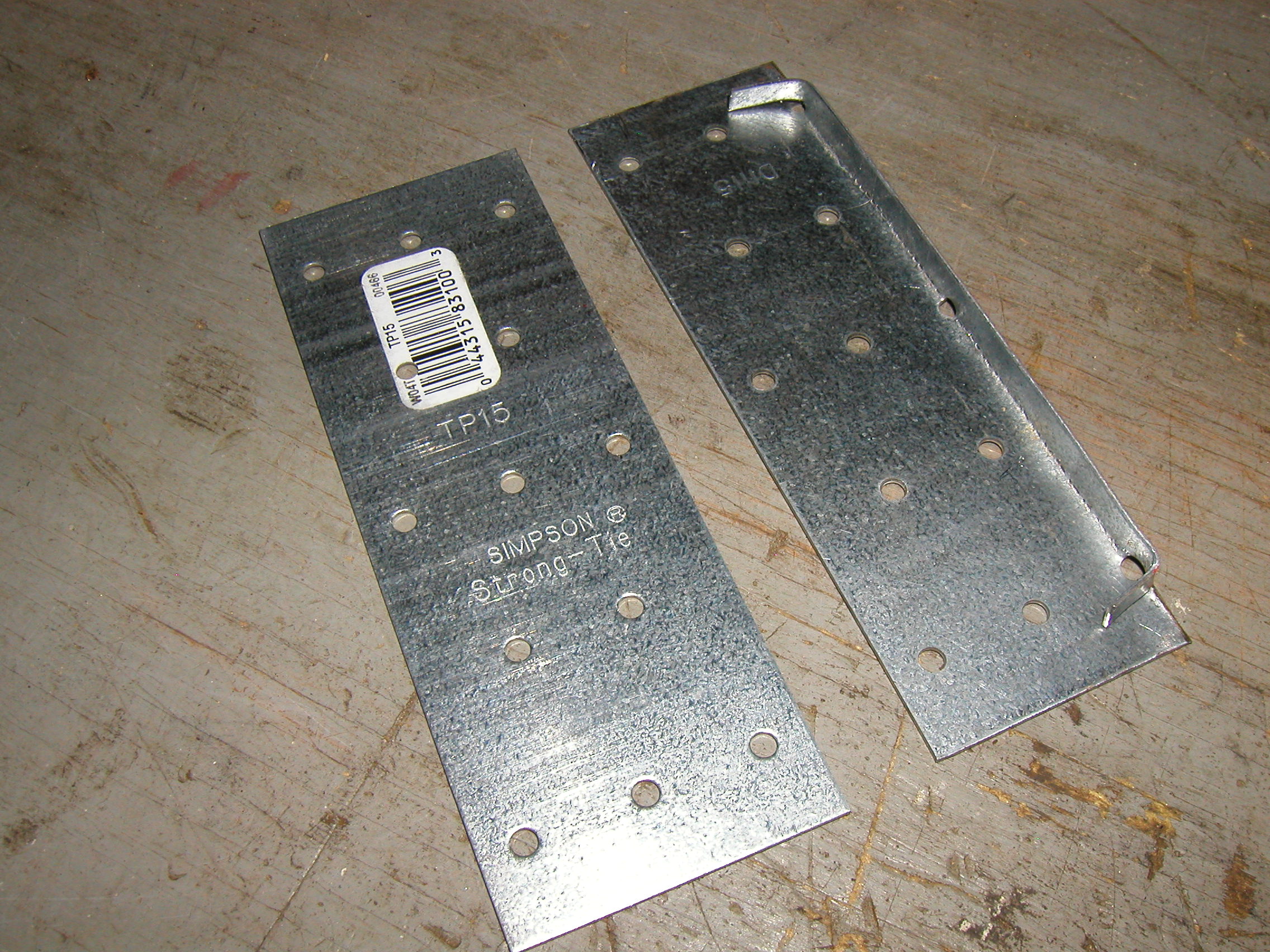

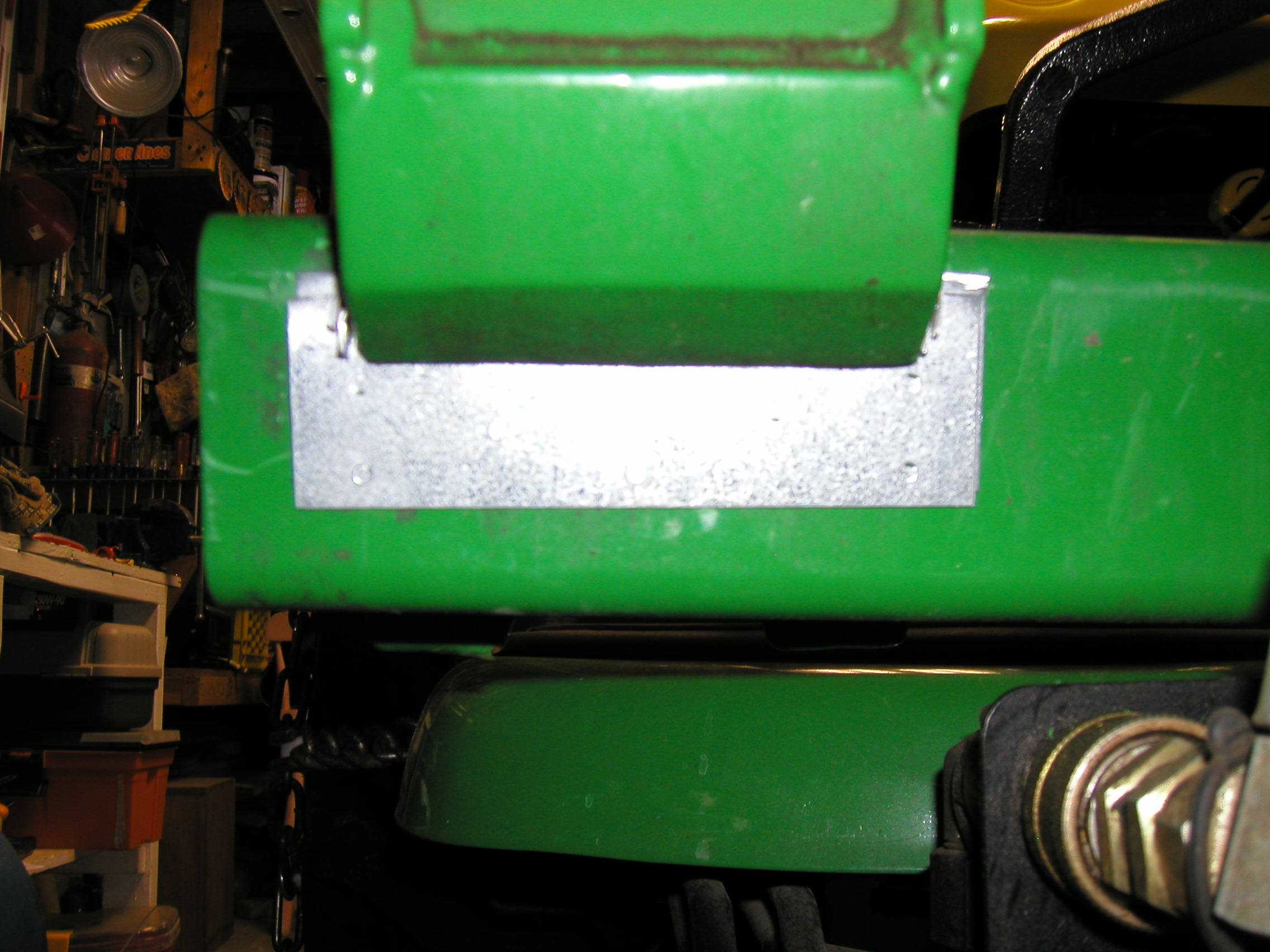

JD4300; The loader is used for snow plowing, bucket work with toothbar and with forks for logging. I am also suprised at how fast it is wearing. Both towers can be swayed back and forth.
Joec; Thanks for the info on the shim kits. It's probably going to happen one day.
Meantime I've come up with a very temporary fix for the winter using Simpson gusset plates. I bent them as shown in the pics and slid them into place bending the "tabs" over to hold them in place.
I only tried this on the front claw as these are the worst. I fit two in the right side and one in the left.
The loader stays on most of the time so the plates should stay ok.
It's too cold out to try it out today but I'll let you know how it works out.
I could only fit four pics on this post so I will do the rest on the next.
Chuck

Update.
Well, I plowed last night and today. We got about 18".
The temporary shims took A LOT of the slop out of the loader operation. I was pleased and a bit suprised. They held their position just fine with vigorous use of the loader.
I am going to pick up a slightly thicker gusset plate and try and get it down to just one on the right side.
Chuck

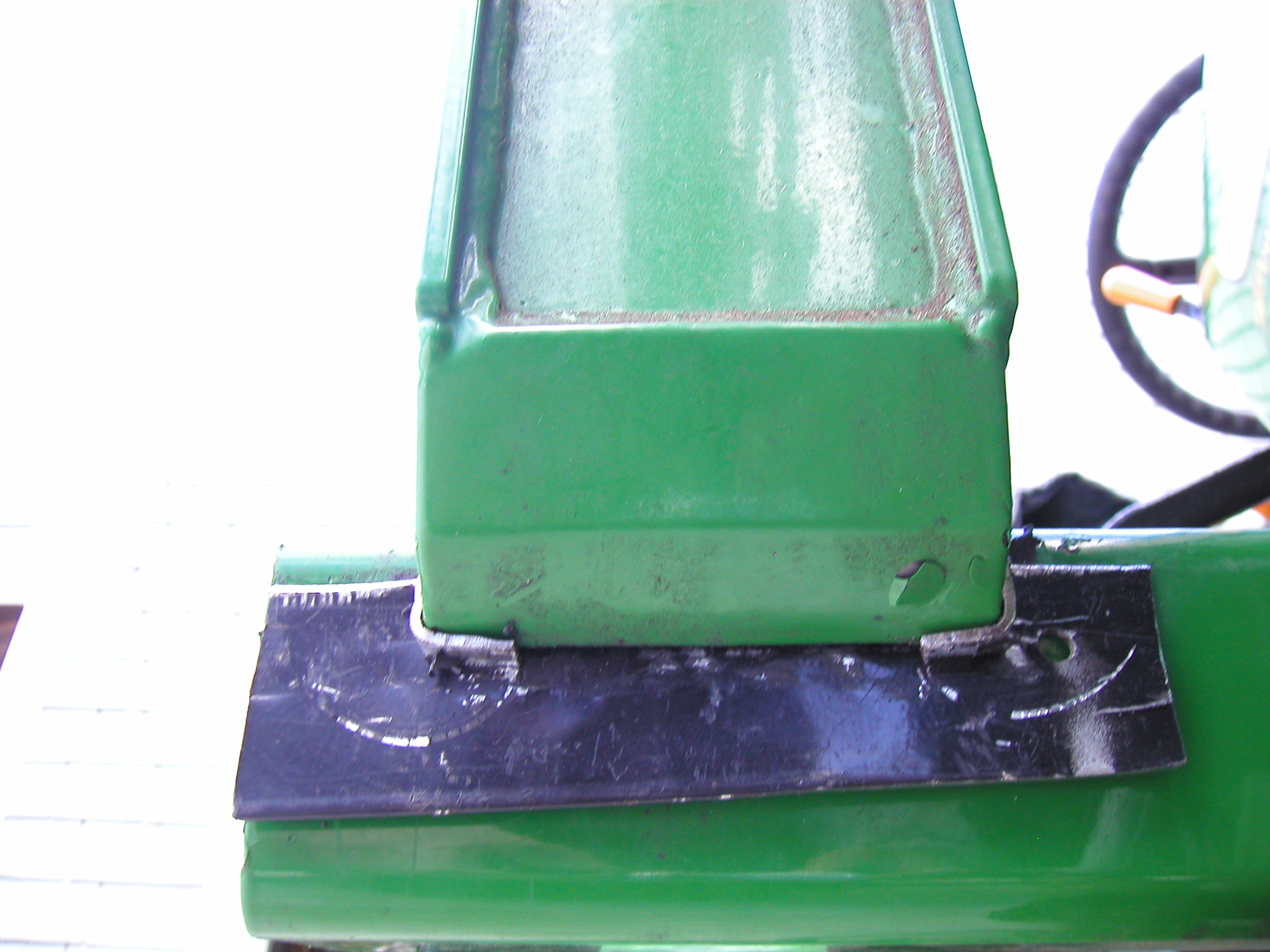

Just thought I would give you an update.
I found some thicker flat stock and changed the length and bends slightly to hold in position better. Works better with one piece of material on each side.
It also seems to have reduced the gaps in the other contact points.
This "fix" is only temporary, but it sure has tightened things up. I've been moving a lot of snow lately, and I can feel the difference.
Chuck
