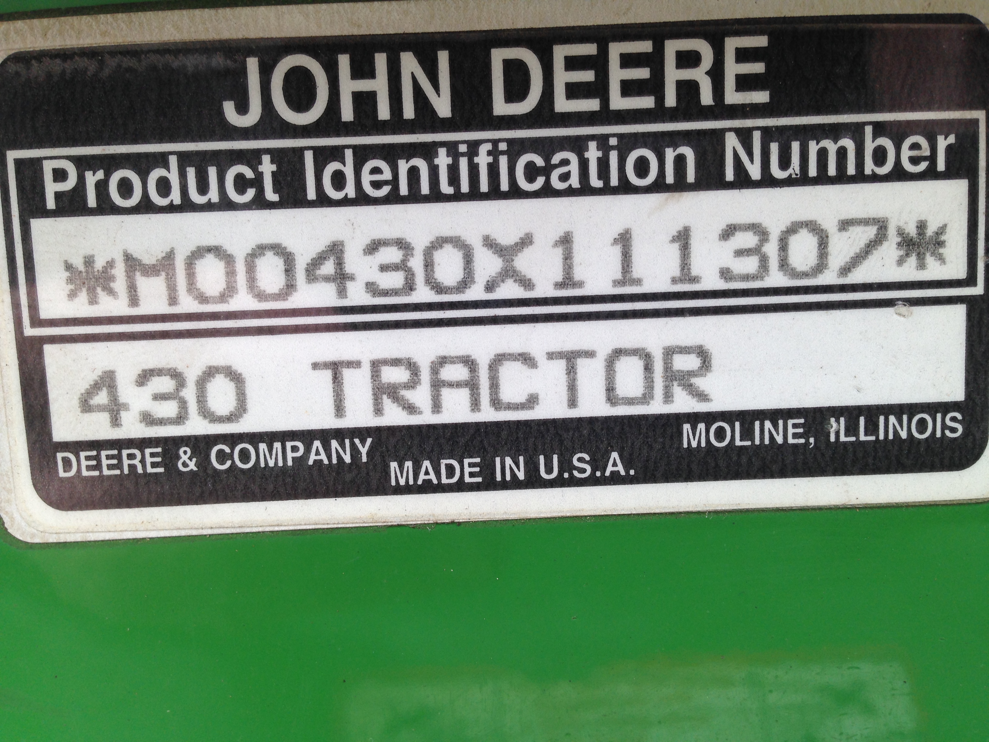

Here is the a picture of the actual serial number of the 430 I mow with. IMG_0352.JPG
Maybe some body can tell me if I am reading the serial number incorrectly or if the chart on TractorData.com is incorrect. We got the left front spindle replaced last year when it broke - the parts were available. We checked with our John Deere Dealer Tuesday and they told us that only one of the two makes of 430 front wheel spindle is now available. My concern is if the available spindle is the one that does not fit. What options would we have to replace or repair the broken spindle? I personally do not know any machinists or welders. If the part was welded my guess is that some of the existing material would have to be removed (machined off) to create a clean surface for welding. Plus, how does a person weld a part that is a 1 inch thick (diameter) solid steel? Maybe that is easy (I don't know. I'm not a welder.)

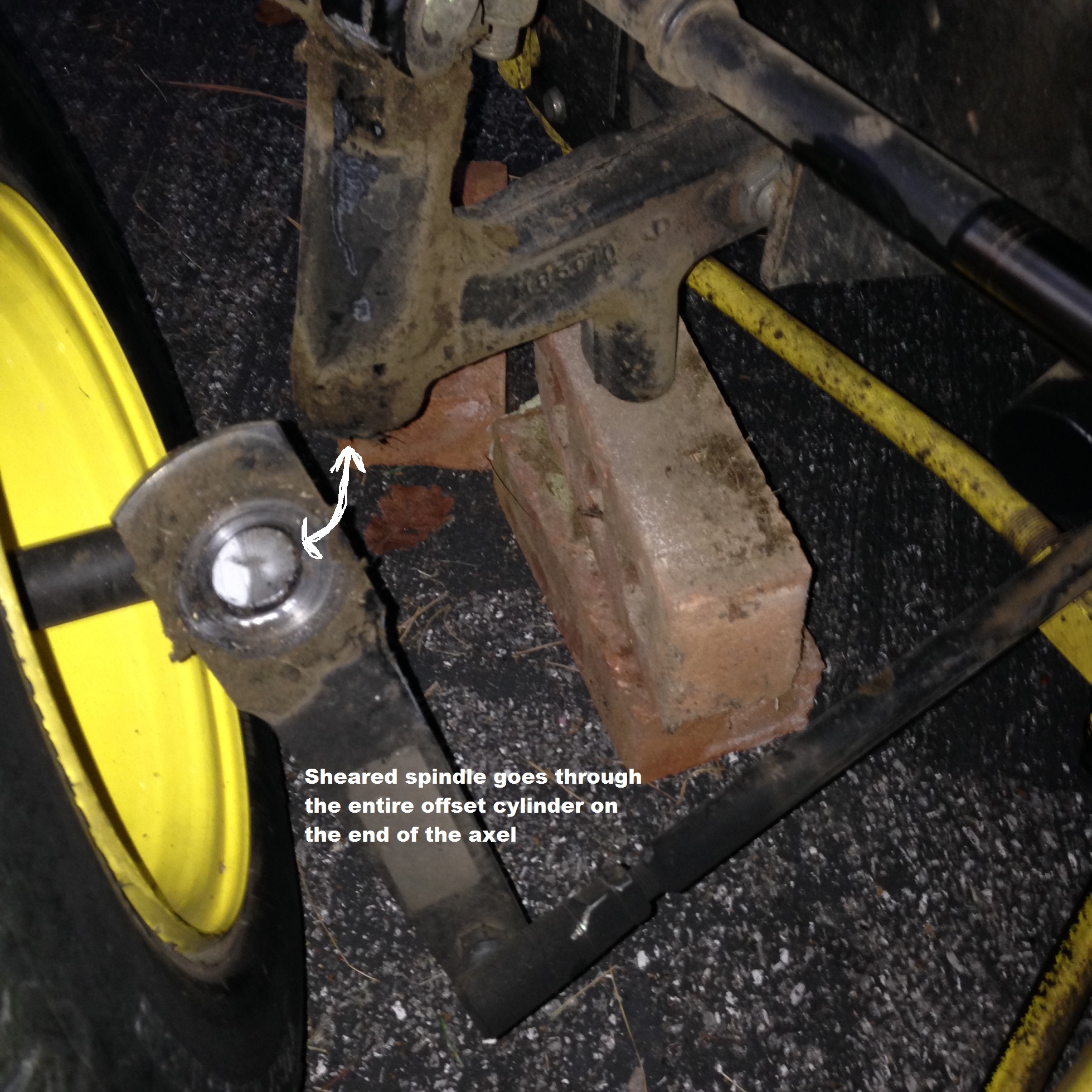

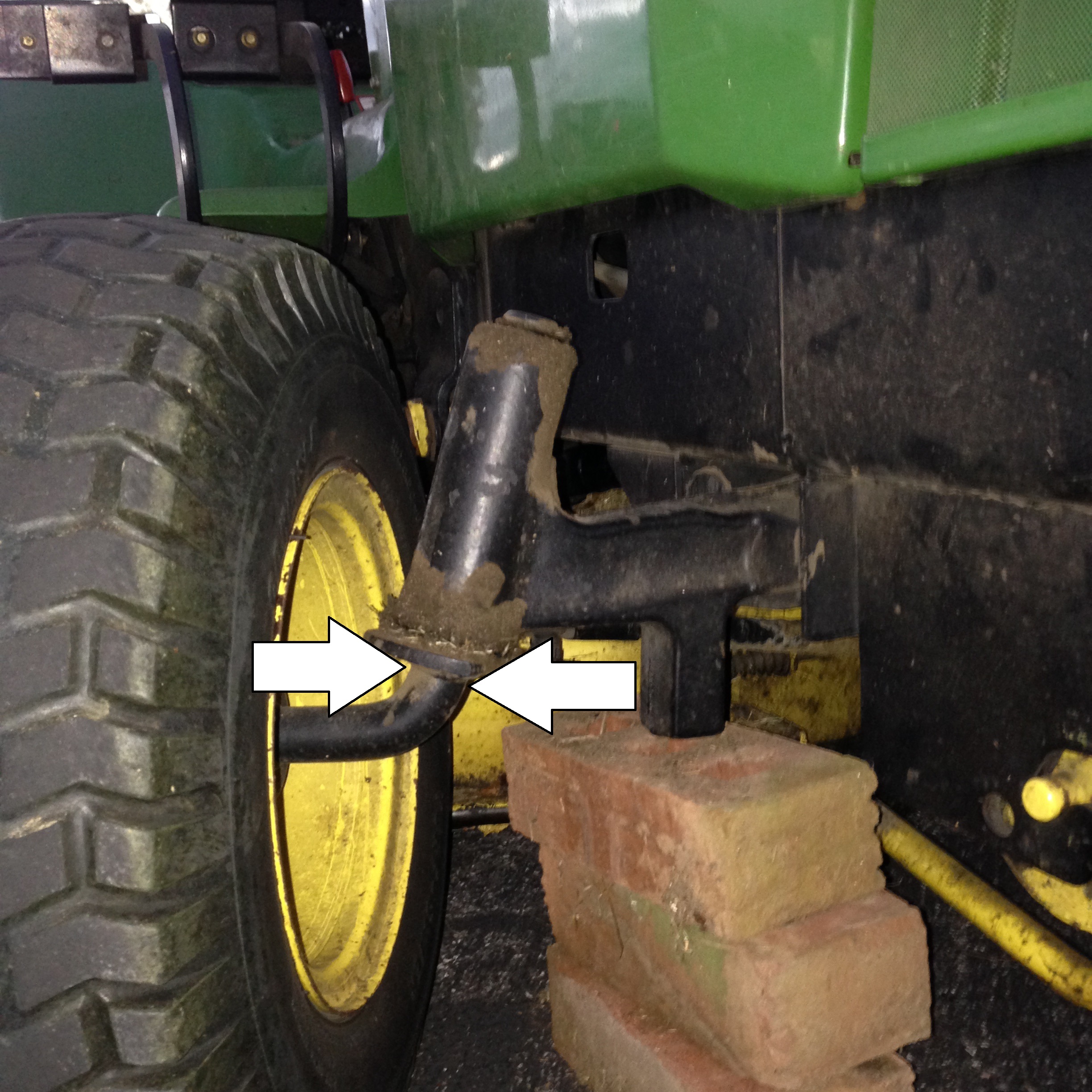

Below are a couple of pictures that I took last year that may help you visualize the area(s) where both spindles broke.
One quick comment: in the picture above that shows the actual place where the spindle broke - in the light colored area on the left of the spindle you can actually see the grain structure of the metal. The darker colored on the right of the spindle is fairly smooth with slightly raised "ripples" - no metal grain structure is visible (a shearing of the metal?). Both broken wheel spindles appear this way which puzzles me. To me I would think the grain structure would be visible across the entire cross section of this broke metal part. Any idea why this appear the way it does?

A puzzlement for sure. The s/n that I see is 111307

Thanks for the reply "beenthere". Yes that is the correct serial number of the tractor.

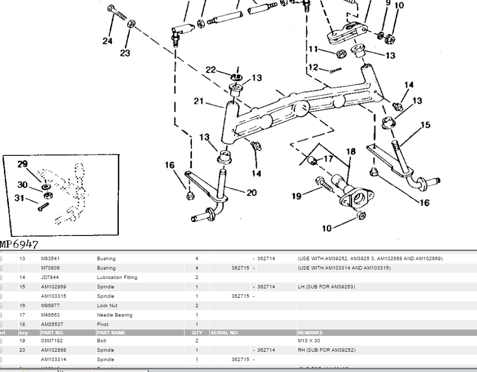

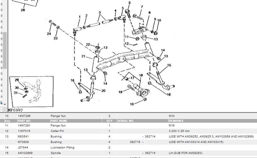

There are bushings up through the axle. See jdparts.com
And your dealer parts person should know just what is needed. Put some pressure on whoever is looking up parts for you. More info included in second attachment.. with reference to bushings and spindles.
