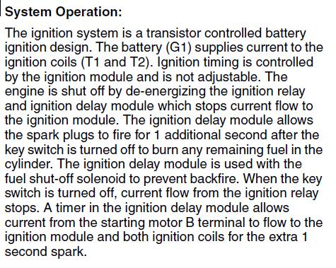

A portion of the system operation dialogue. See the 4th line down.

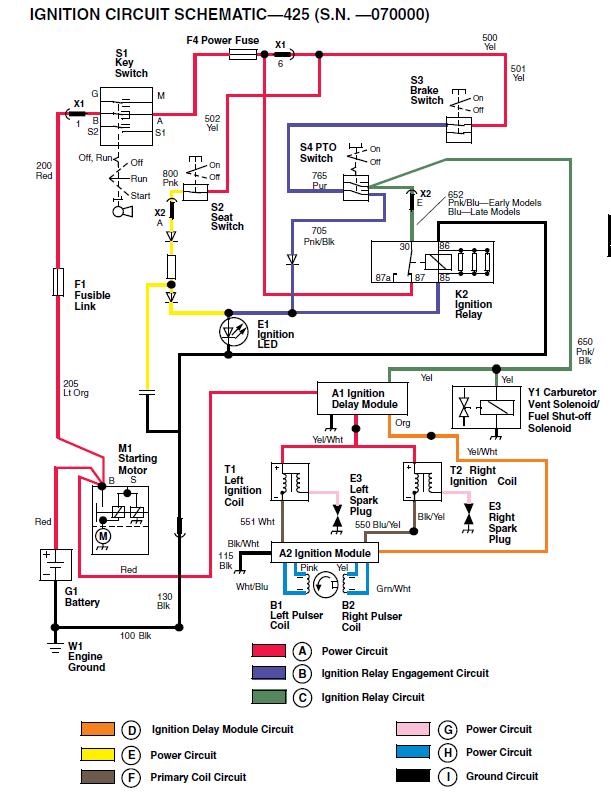

Which part of the diagram do you want to peek at? Here is the ignition schematic up to s/n 070,000
/ 425 will not shut off
Thanks been there, looks like that schematic shows the start circuit with all of the safety switches. Just have to start chasing wires and see if we can determine what component is faulty.
Roy

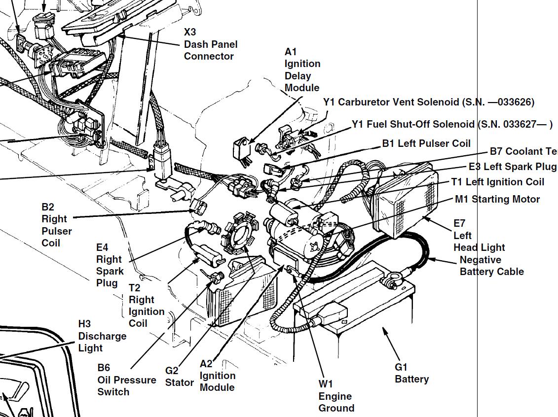

If below 70,000 then this shot of the component locations may help. A1 is the Ignition Delay Module and A2 is the Ignition module located on the engine. I'd start with wiggling the components and wire connectors leading to them while key off and engine still running.
thanks beenthere,
s/n is in the 40,000 so this info is greatly appreciated. Friend is out of town on family business but thought he would be back tomorrow. If not I will probably take my BX over and mow his hayfield/ lawn.

Look for the diode by the ignition relay, it's probaly bad. That diode stops power from backfeeding the relay causing it to stay on. It's shown in the wire diagram. Good luck
/ 425 will not shut off #10
Greenblood2011
Sounds like you are onto the possible problem.
Would the ignition LED (lit or unlit) on the control board be a clue to a bad diode?
Is the location of that diode shown in the tech manual? Or just trace it along the 706 pink/black wire shown in the schematic.
This is what the tech manual says about tracing the signal through the ignition relay (doesn't point out the diode tho).
With the operator off the seat and the key switch in the
run position, current flows from key switch terminal B to
terminal A, power fuse (F4), ignition relay terminal 87,
brake switch (S3) (brake pedal depressed), PTO switch
(S4) (PTO disengaged), ignition relay coil terminal 85, <<--( diode here)
and ignition LED(E1). The ignition LED indicates that
power is available to the ignition relay coil. With the
ignition relay energized, current (C) flows to the PTO
switch, and ignition delay module. The ignition delay
module allows........

It's probly easier to just trace the wire... Deere puts there diodes any where they fit. It'll most likely be small about an inch square with two wires that plug in. Could be black or yellow. Check and make sure he didn't bypass the seat switch, that could also cause this issue. Let me know what you find.
