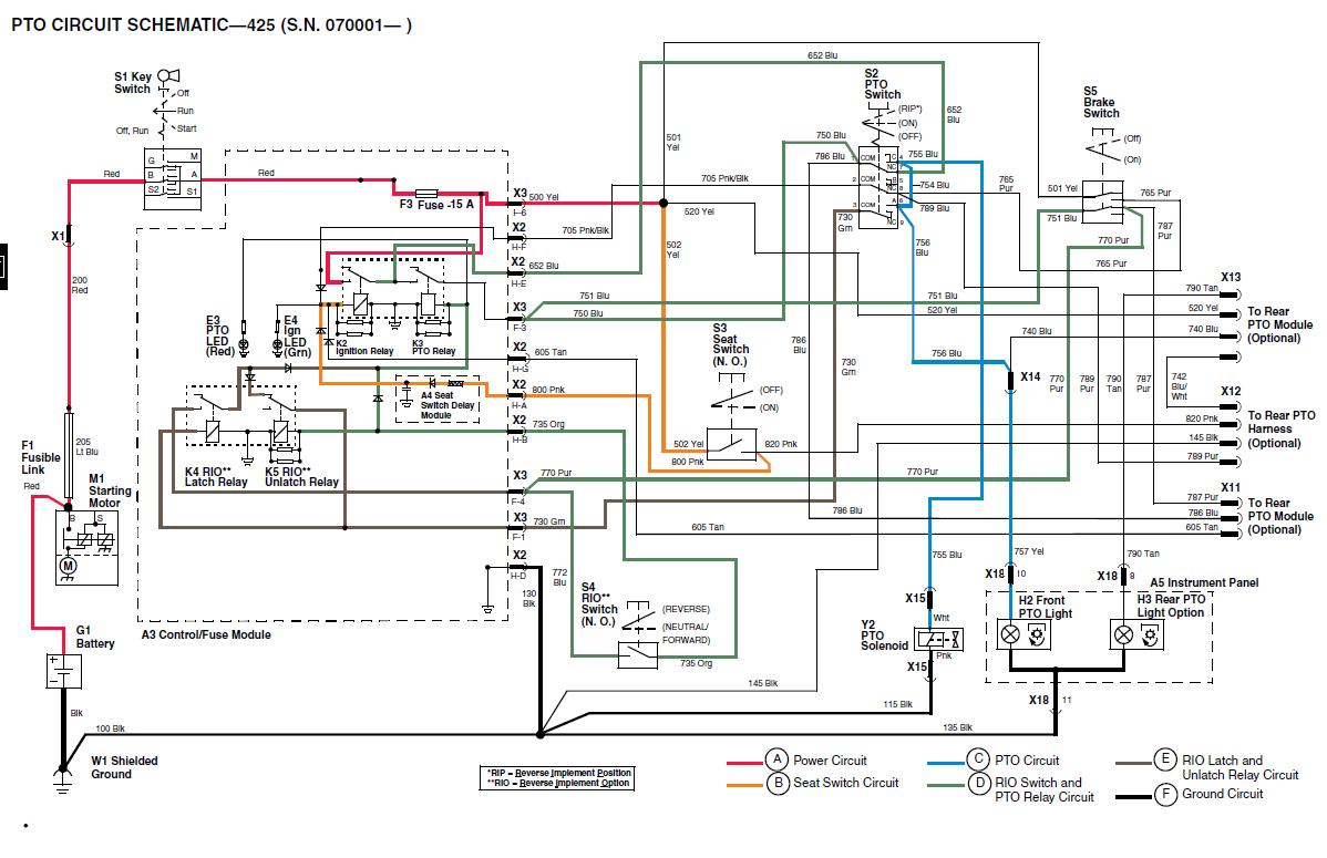

Appears this tractor has the reverse shutdown switch. Has it been disabled, and is somehow acting up now?
Attached the PTO schematic if that might help. If more on the trouble-shooting section of the PTO is of interest, I can post that as well.

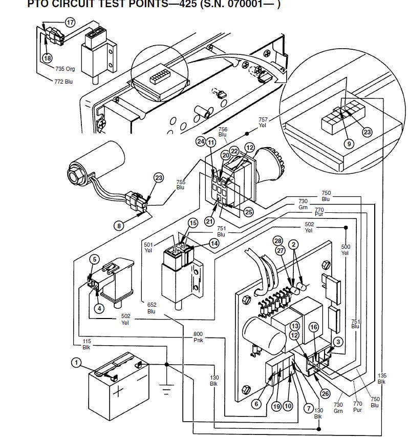

Here are some additional pages from the tech CD that might help. Wondering if it could be the solenoid valve too, or a wire going to it?

Book says to put 12v on the pto clutch solenoid after disconnecting from main circuit and listen for a click. Check clutch ground, too.

Ok. Got it figured out. It was the solenoid in the rear of the transmission that engages the PTO. It was bad and replaced. Works great now :thumbsup:
