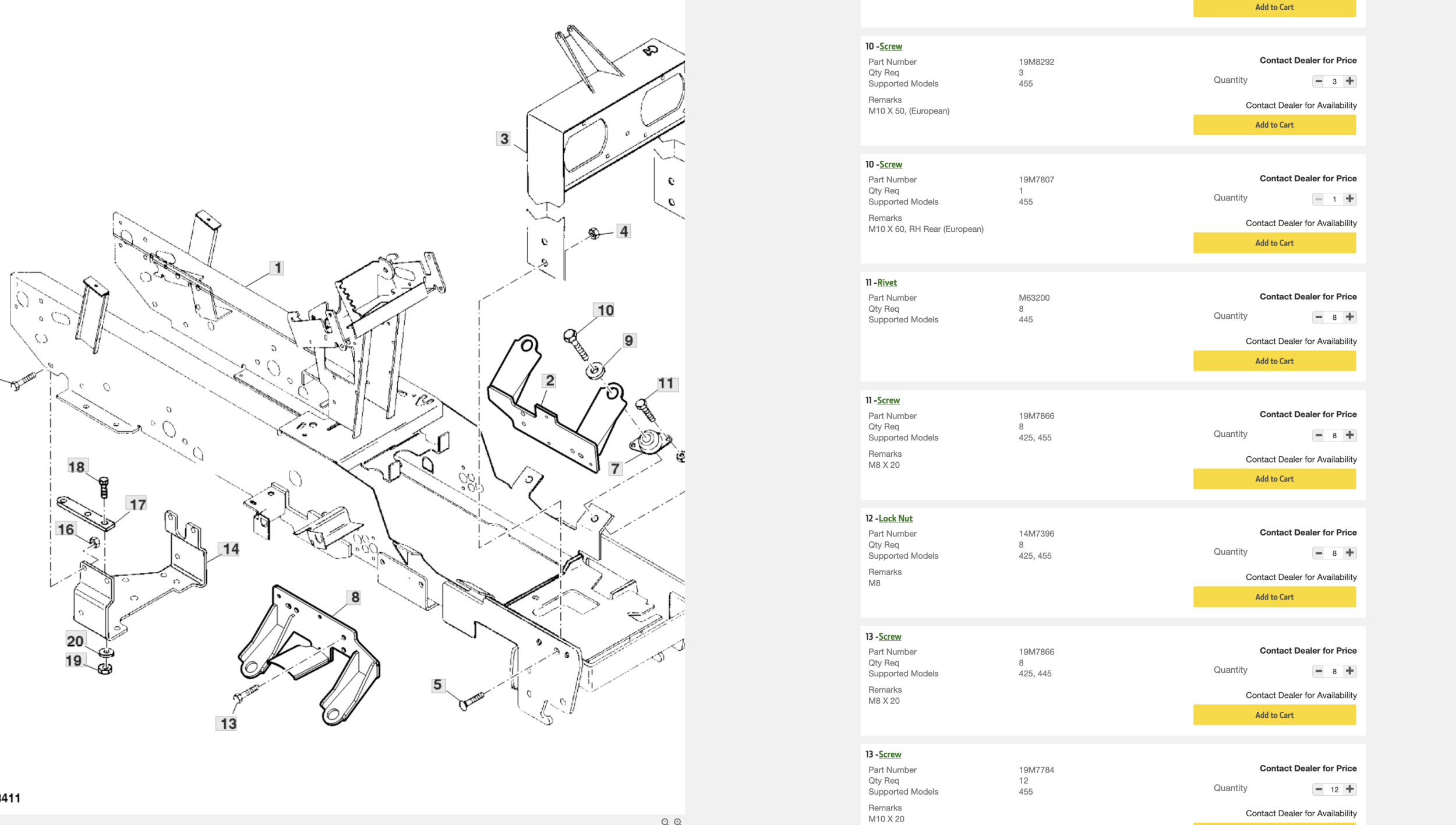

The motor mount bolts that bolt to the engine side of the mount vibrated out on my 425. Does anyone know the size of these bolts.
/ 425 engine mount bolts #2
#13?? BOLT - FLANGED HEX M8-1.25 X 20 bracket to block
#10? BOLT - FLANGED HEX M10-1.5 X 50 bracket to motor mount center

Thanks. I couldn't find that diagram on JD parts. I need the two bolts that attach the bracket to motor. #13 M8 x 20 is it.
Thanks. Got them installed yesterday. Cured my exhaust melting the side panel issue. Motor is solid now.
