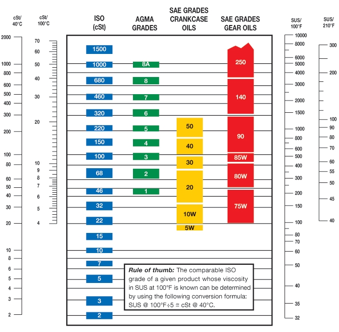

Mobile equipment if designed properly can and will operate well below 40 degrees F. This becomes a factor of pump inlet conditions like hose diameters, lengths, etc. along with oil viscosity.
If you are having issues with cold weather starts maybe consult with manufacturer to see if there is an option for lower viscosity oil like 5W-40 for colder climate vs 15W-50 for warmer climate. What is your ambient temperature in summer since you also need to consider that when selecting hydraulic oil for your equipment.
While this may be generic advice, it does not apply to these machines.
It is worth examining an oil viscosity chart for the data.
There is almost no difference in cold weather viscosity between 10W40 and 5W40, and the exact same viscosity at higher temperatures. (The two columns on the right are cold, then high temperatures viscosity. A 10W40 oil might be 120SUS cold, and 70SUS hot, while a 5W oil is closer to 95SUS cold.
@Modrob don't use less than 10W40, per the factory. (And great advice from @m5040)
