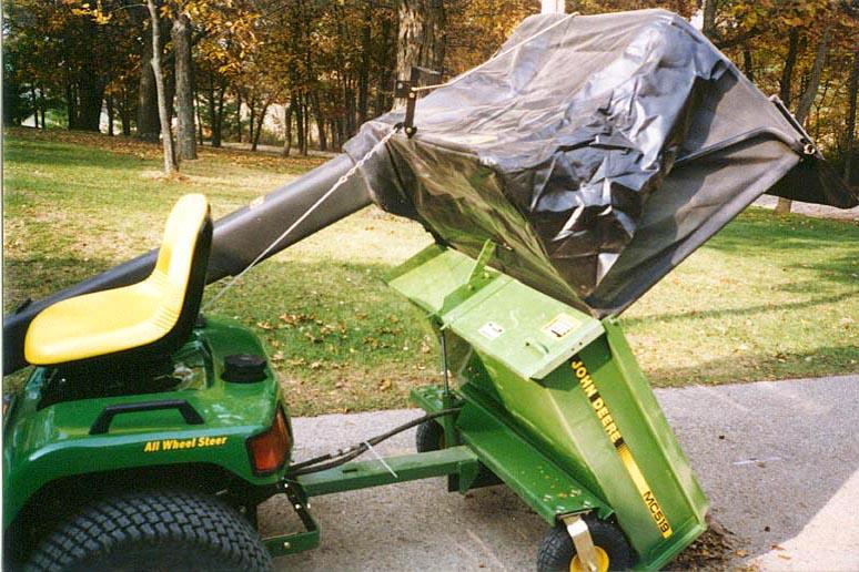

Not exactly sure what you are asking, but JD has always had a power flow blower for their bagger system for these tractors.. such as the MC519 cart that I use very successfully.
Bags are also available to carry and hand dump.

Thanks Beenthere, just not sure if it fits on a 48" mower deck? Looks like it might interfere with the rear wheel or side of tractor as it's off a 54"?
Thanks
/ 425, 445 or 455GT mower deck bagger #6
The same Powerflow for the 54" also fits the 48", according to jdparts info.
Deere dealer should also be able to confirm.
