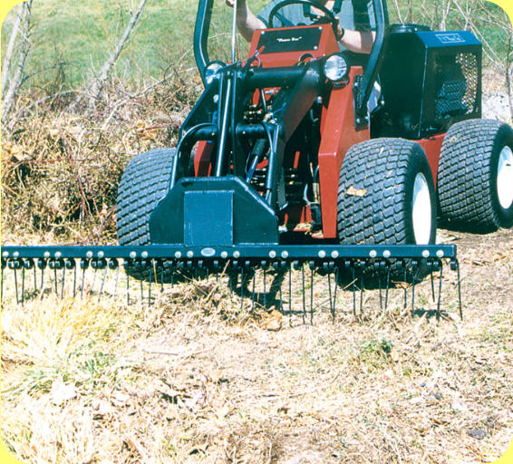

Has anyone had any experience with the rake on lawns? Does it rip it up at all? Does it do a good job at moving small twigs or is it better for leaves?
I'm having a hard time posting a pic but I'm not talking about the power sweeper but the thing that looks like a spring tine leaf rake but bigger.

The rake like this?
/ 422 Rake
That's it. My phone was taking screen shots in some format that Tapatalk doesn't like.

I've got the rake and I love it. I have tested it with the tines staged for pulling, pushing, and alternating. Ultimately, pulling and in float works best for me. If the pile of what you are moving gets too big, it will float over the top so then you get to go to manual. I have used this for mainly leaves and cleanup after dropping trees. It will handle pretty good sized stuff.
As far as tearing up the lawn, I think that depends on the operator and the lawn. It will leave little slices/scars through bare spots but those disappear with the rain.

Thanks! This is exactly the feed back I was looking for. I think I'd like one but not if it was total junk.
/ 422 Rake #7
I don't think the price is too bad and it is one of my most used attachments. It had its faults like anything else but I find it indispensable. The tines are also easily replaceable. Go for it.
