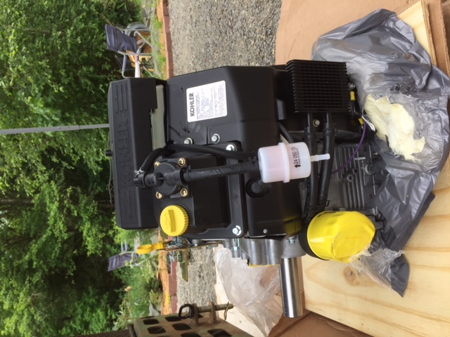

   / 422 need to tow out of woods #68

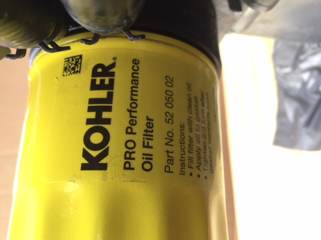

Nice job! Can you post some pics of the new engine installed? Otherwise it never happened!
Also, the crushed oil filter comes up invalid attachment- could you repost that too?
I'd give you a ++ on shade tree mechanic. I've replaced a lot of engines over the years as a pro mechanic, and cutting the shaft length would have me sweating; oh darn it's too short!:duh:

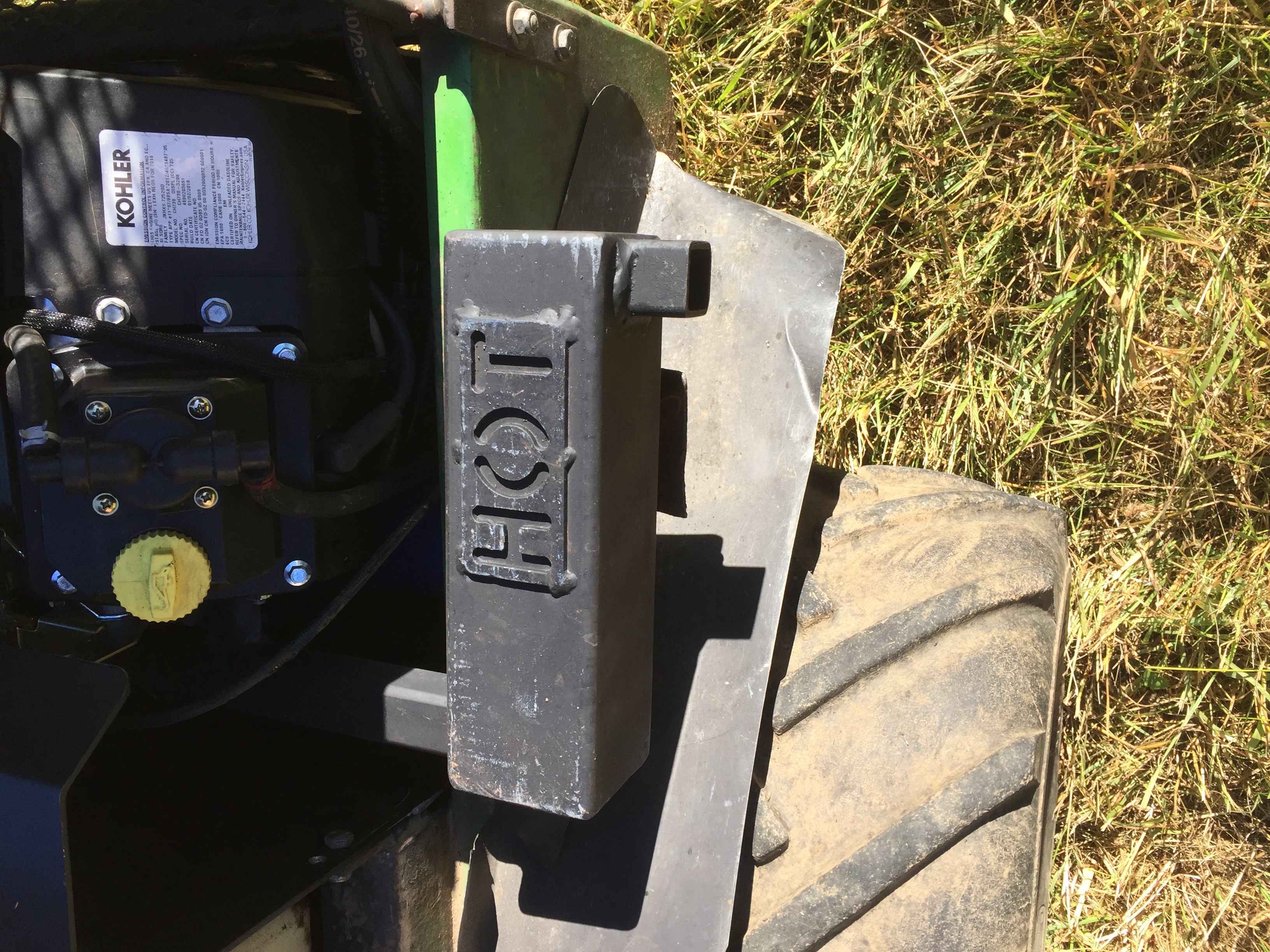

#69
For sure, cutting the shaft had me worried.
Lets try that oil filter again.
This is a closeup of the engine installed. I was taking a picture of the "new improved" muffler. Notice the HOT, that's new.:laughing:

   / 422 need to tow out of woods #70
Did you pull the old engine then measure for the correct shaft length, or what was your procedure?
Yikes, looks like they tried to punt with it for a field goal! At least it landed on something unimportant?!:confused2:
That's easily explained, the woman from McDonalds used something similar as a step with bare feet, and sued the company for not telling her it's hot!:shocked:
A new heat shield! Now the tire won't get soft when the machines sitting:laughing:

#73
Lol, i added the heat shield when my nephew made a muffler out of a fire extinguisher, it hung down a little too close the the tire. That thing got flipping hot, and started to soften the tire, so the heat shield. I might take it off, as it's not needed now, but....
