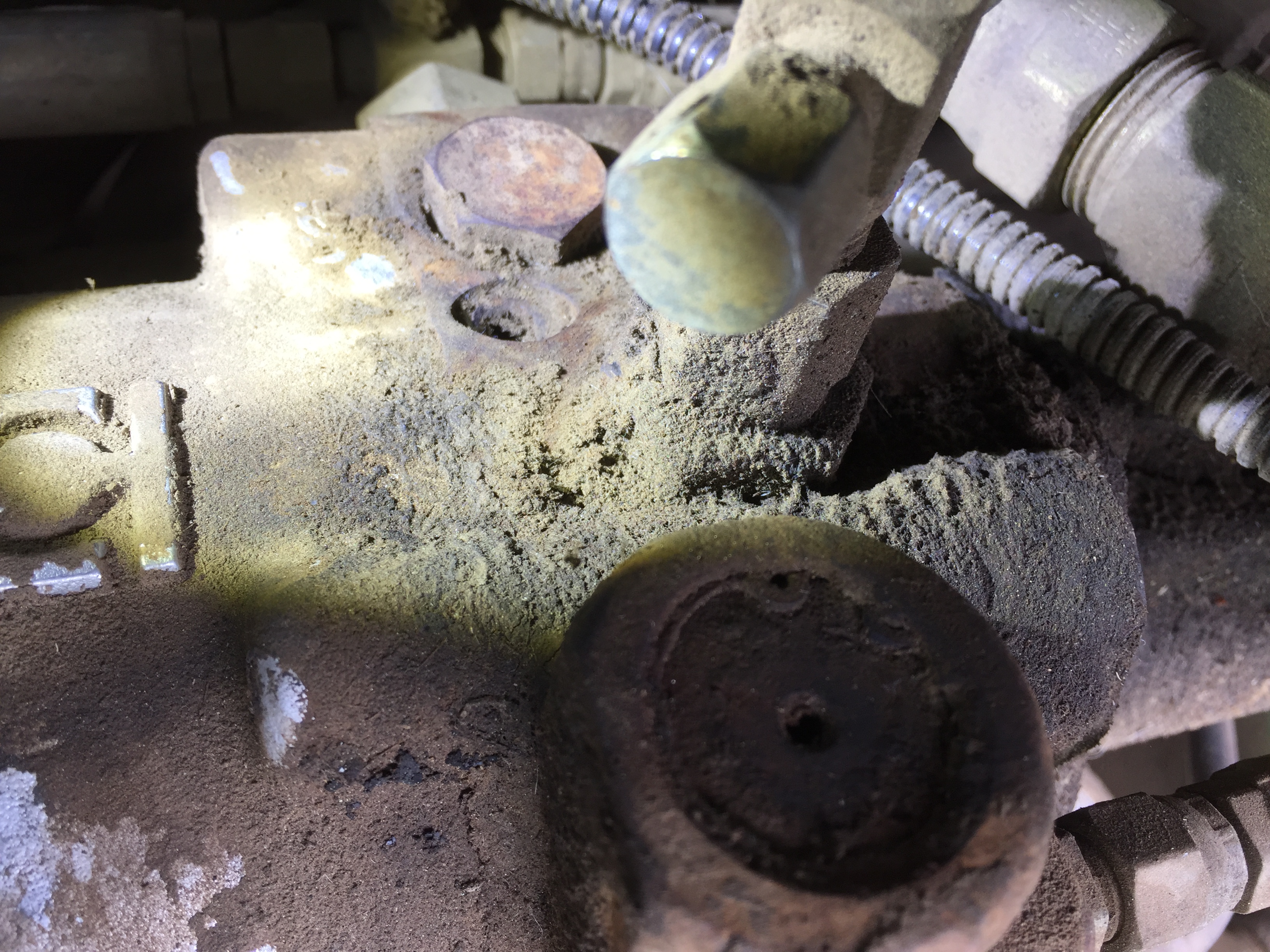

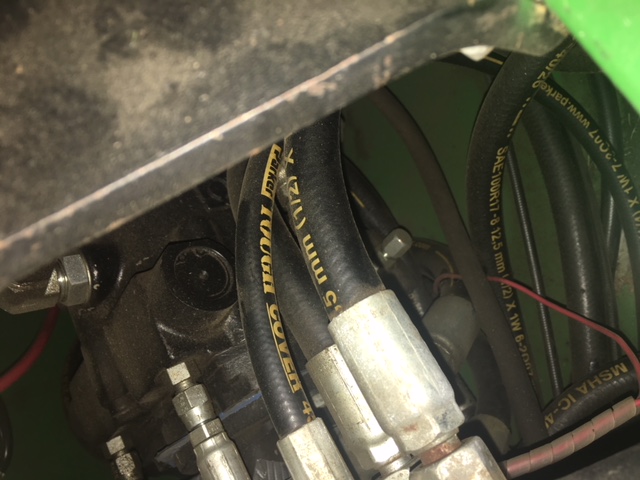

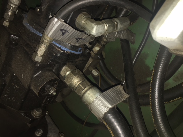

Ok just to clarify i do have the 425 so it could be different but I have had that pump in and out 4 times and it definetly looks like your pump as well . I am pretty good at it now. The little cap that MossRoad is pointing at is what I am talking about. On the bottom of the pump if it is like mine there are 2 of the larger hoses that go into the bottom of the pump. My has a manufactured steel blocks (2) that they attach to, one on each side of the pump. On the side of the blocks is that little cap covering one of the bypass connectors. There is one bypass connector on each side on the bottom side of the pump on these steel blocks. I am attaching a picture of each side of my pump of the connectors.

You shouldn't roll these machines without bypassing the hydraulics first. You can do serious damage to the drive pump if you pull it on its wheels with that pump not bypassed. Once you figure out which two ports to connect the bypass hose to, it's an easy operation and the machine rolls very easily... so much so that you'd better have a way to stop it if its on a hill... ;)
I had mine for about 16 years before I had to roll it around in my garage. Once I figured out the ports and got a correct hose made (the factory supplied hose was missing a fitting), I was a piece of cake. :licking:

Terry gave me a call and described the location of an allen screw adjustment that can be backed out 1 to 1 1/2 turns, to allow the PT to be moved. On the side of the pump where the air bleed hose is attached, below and to the right of the bleeder T and just above a bolt or cap. I'll include a couple picts.
Allen for towing.JPGAllen Head
wide view of allen.JPGWide view
Foreground of the wide view is the cap where the bleeder hose goes on.
