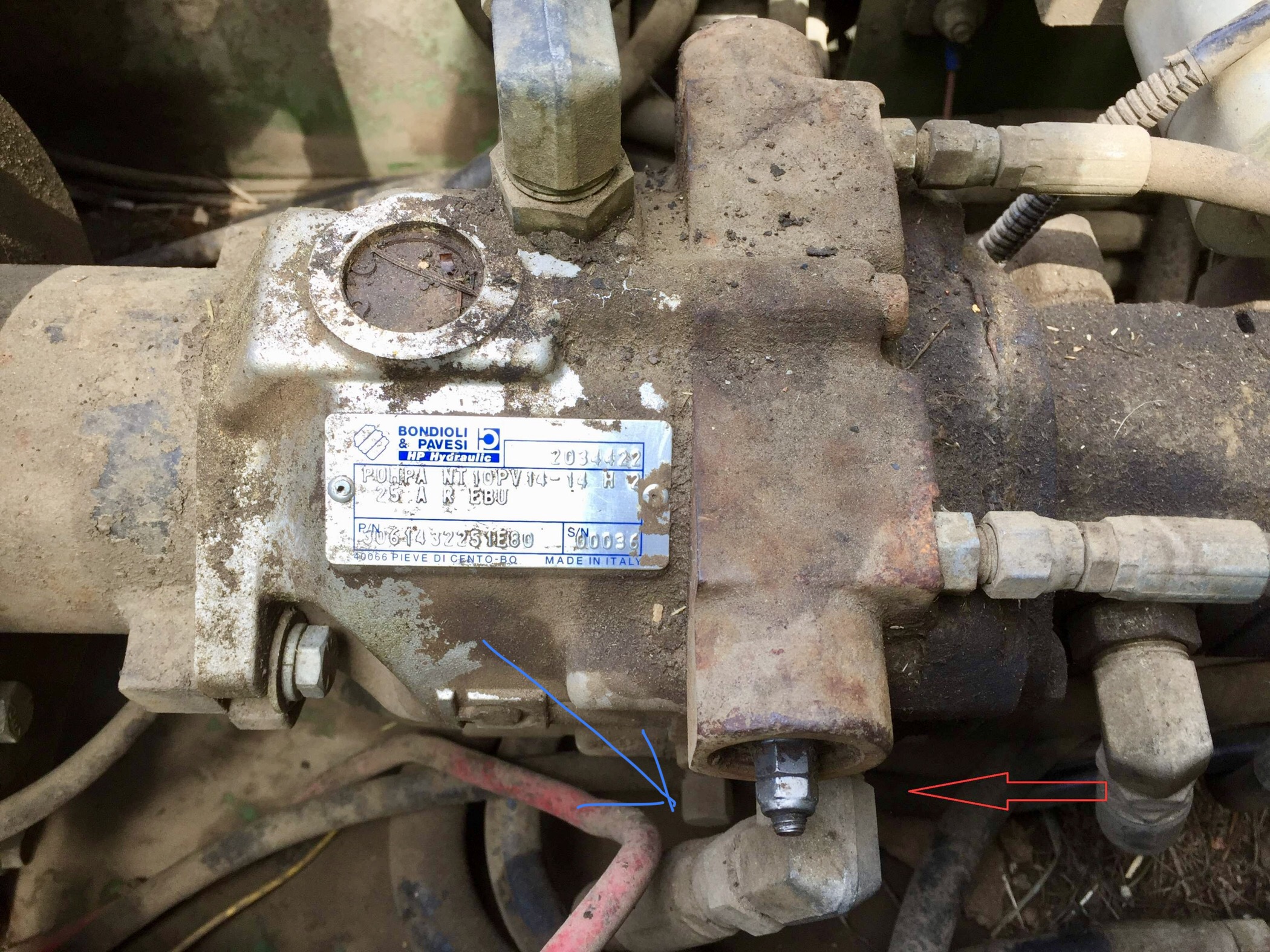

Oh. Not to complicate matters but on my entirely different machine the release is on top of the tram pump control. I don’t think yours is the same but.
   / 422 need to tow out of woods #13
I think the nut you are red arrow pointing at is your idle position or neutral adjustment.
   / 422 need to tow out of woods #17
Maybe this?

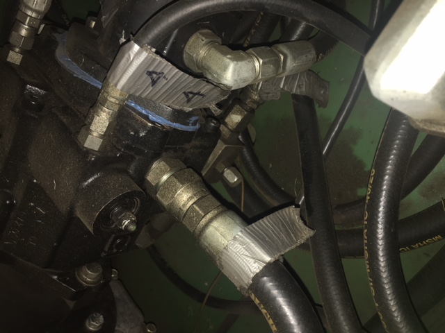

   / 422 need to tow out of woods #18
Ok just to clarify i do have the 425 so it could be different but I have had that pump in and out 4 times and it definetly looks like your pump as well . I am pretty good at it now. The little cap that MossRoad is pointing at is what I am talking about. On the bottom of the pump if it is like mine there are 2 of the larger hoses that go into the bottom of the pump. My has a manufactured steel blocks (2) that they attach to, one on each side of the pump. On the side of the blocks is that little cap covering one of the bypass connectors. There is one bypass connector on each side on the bottom side of the pump on these steel blocks. I am attaching a picture of each side of my pump of the connectors.
#19
Ahhh, now i see what you mean! So a hose attached to those two, one on each side, connected together.
