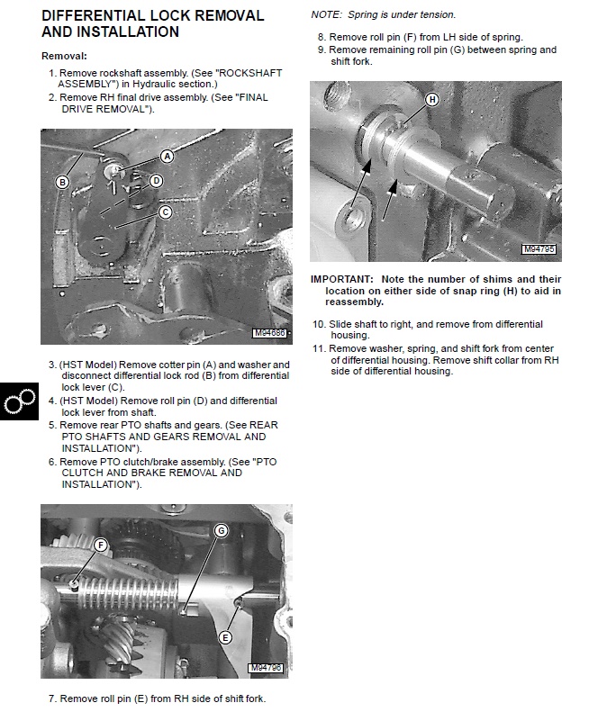

Is the part you reshaped listed as an item # in post 3 of kennyd and if so, what is the item? Am thinking #12 is one or the other.

Is the part you re-shaped listed as an item # in post 3 of kennyd and if so, what is the item?
Here is image of service book on removal. (sorry for TBN's double post)
Item #12 in the diagram is what I am holding in my hand in my photo. This side of the dog clutch
meshes with the 4 teeth on the ring gear, not in the diagram.
