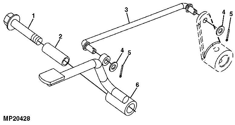

Look at the linkage on jdparts.com and see if you can decipher where the problem might lie. Might be something broken.
/ 4200 Hydrostatic positive lock won't engage completely #3
Here are the two breakdowns from JDP, if you can "feel it going in and out" then I'm afraid it might be internal.:

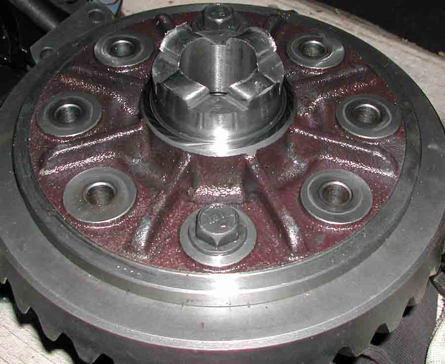

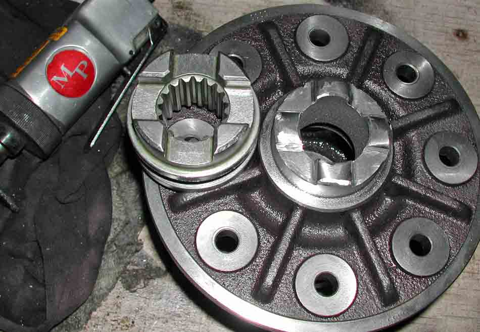

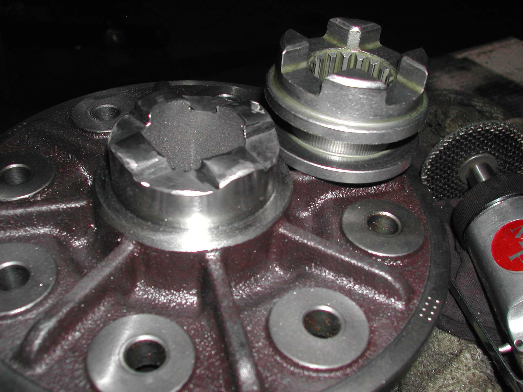

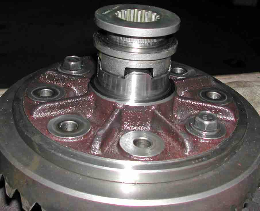

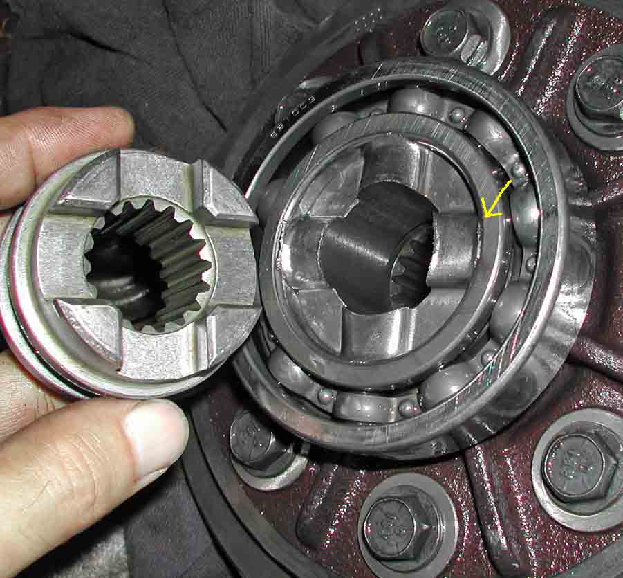

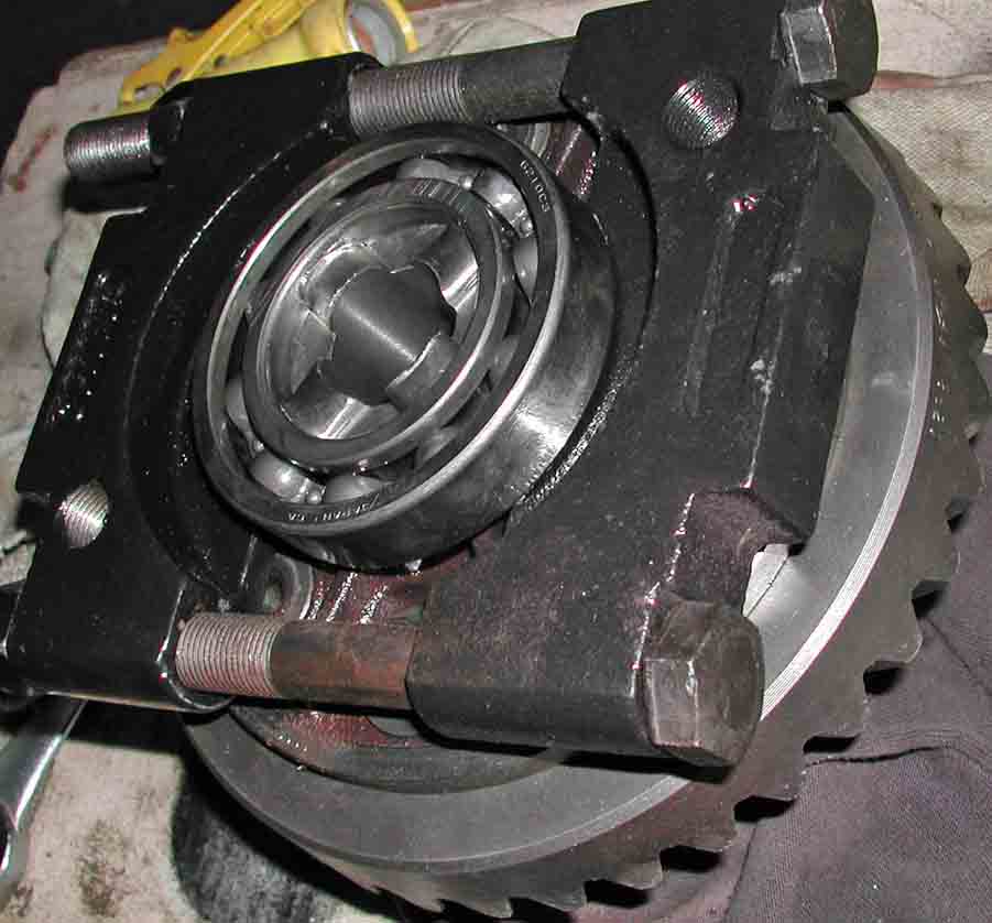

One side of the diff-lock mechanism is soft cast steel; the other is harder/tougher steel.
So the former wears a lot when rubbing against the latter. If there is enough meat left
on the cast part, then you can shape it with a grinder to make it grab better, as I
did for one of my 4300s.
Otherwise, you are gonna have to buy the whole ring and pinion set. $$$$

Wow, great pics! I'm assuming you're holding a new piece in the second pic? What did the original one look like?
/ 4200 Hydrostatic positive lock won't engage completely #8
That IS the original piece. I just reshaped it with a die grinder and an angle grinder.
/ 4200 Hydrostatic positive lock won't engage completely #9
I mean the smaller piece in your hand in pic 2 (not with the arrow), it looks like you ground the ring/pinion side.
/ 4200 Hydrostatic positive lock won't engage completely #10
Yes. Only the part attached to the ring gear was reshaped. It was an error on JD's part to use
such a soft steel as part of the diff-lock dog clutch.
It seems to work OK after this repair. No new parts were purchased.

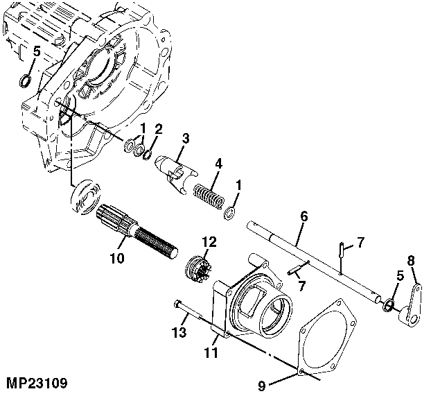

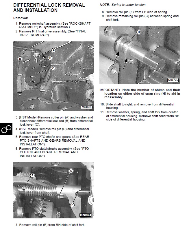

Is the part you reshaped listed as an item # in post 3 of kennyd and if so, what is the item? Am thinking #12 is one or the other.

Is the part you re-shaped listed as an item # in post 3 of kennyd and if so, what is the item?
Here is image of service book on removal. (sorry for TBN's double post)
Item #12 in the diagram is what I am holding in my hand in my photo. This side of the dog clutch
meshes with the 4 teeth on the ring gear, not in the diagram.
