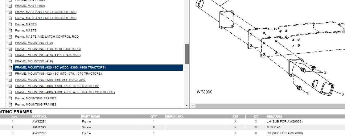

Are the quick attach the same? I am looking at buying another 4400 hydro with a 420 and selling mine 4400. I have a 430 loader and was going to switch them before I sell my other one.
/ 420 vs 430 loader #2
Should be no problem.. make the switch before letting your 4400 go down the road, just to be certain the mounting frames bolted on to the tractor frame are the same. A check with jdparts.com may confirm that they are the same part numbers of not. Appears they are the same for both FEL's. There is a difference right from left, and can be mixed up..
