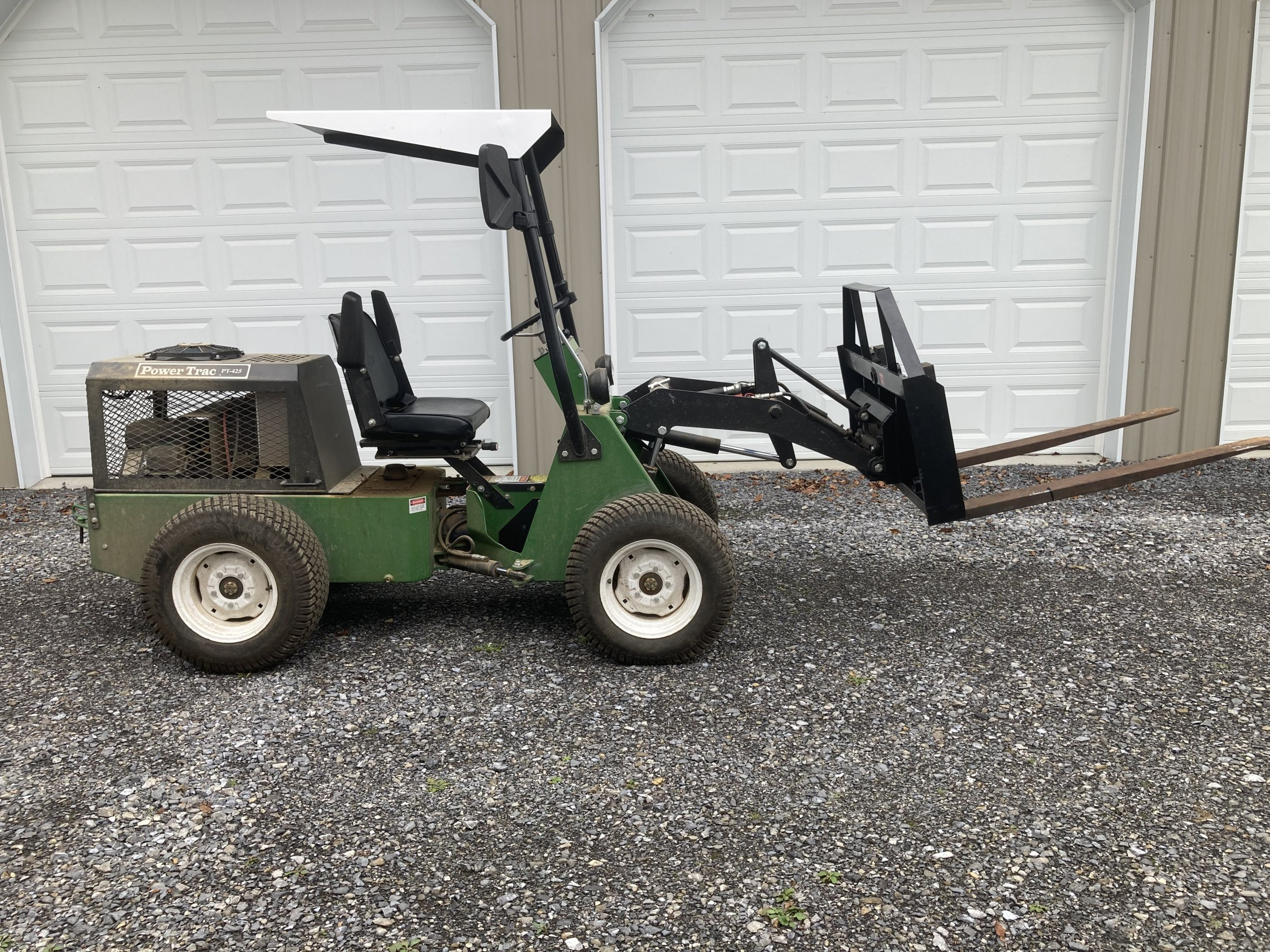

I added these 42” frame and forks today. Lifting bigger stuff but not heavier. Got to watch the steering.
Depends on the model.how much weight can that handle, before rears lift up? just wondering. power tracs are pretty cool
For example, my 2001 model year PT425 says it can lift 800# at the quick attach plate. They have a model that'll lift 2400#.
What's kinda quirky about articulated machines like this is the center of gravity changes as you turn, even while sitting still. So if you pick up a heavy item, and turn the steering wheel, it'll tip forward and the rears will come off the ground. Turn the wheel back towards straight, and the rears go back down.
You get used to it.
Yep. They start flapping their arms and waving while doing jumping jacks to get your attention.Fun to watch peoples faces the first time they see you do that and they think something bad is about to happen.
I have always wondered why more people haven’t done this and if this was also the reason why not???I have it set up so can add 400lbs on the back if needed but I avoid doing so because I believe it stresses the articulation joint.
Wondering about the forks or the weights on the back?I have always wondered why more people haven’t done this and if this was also the reason why not???

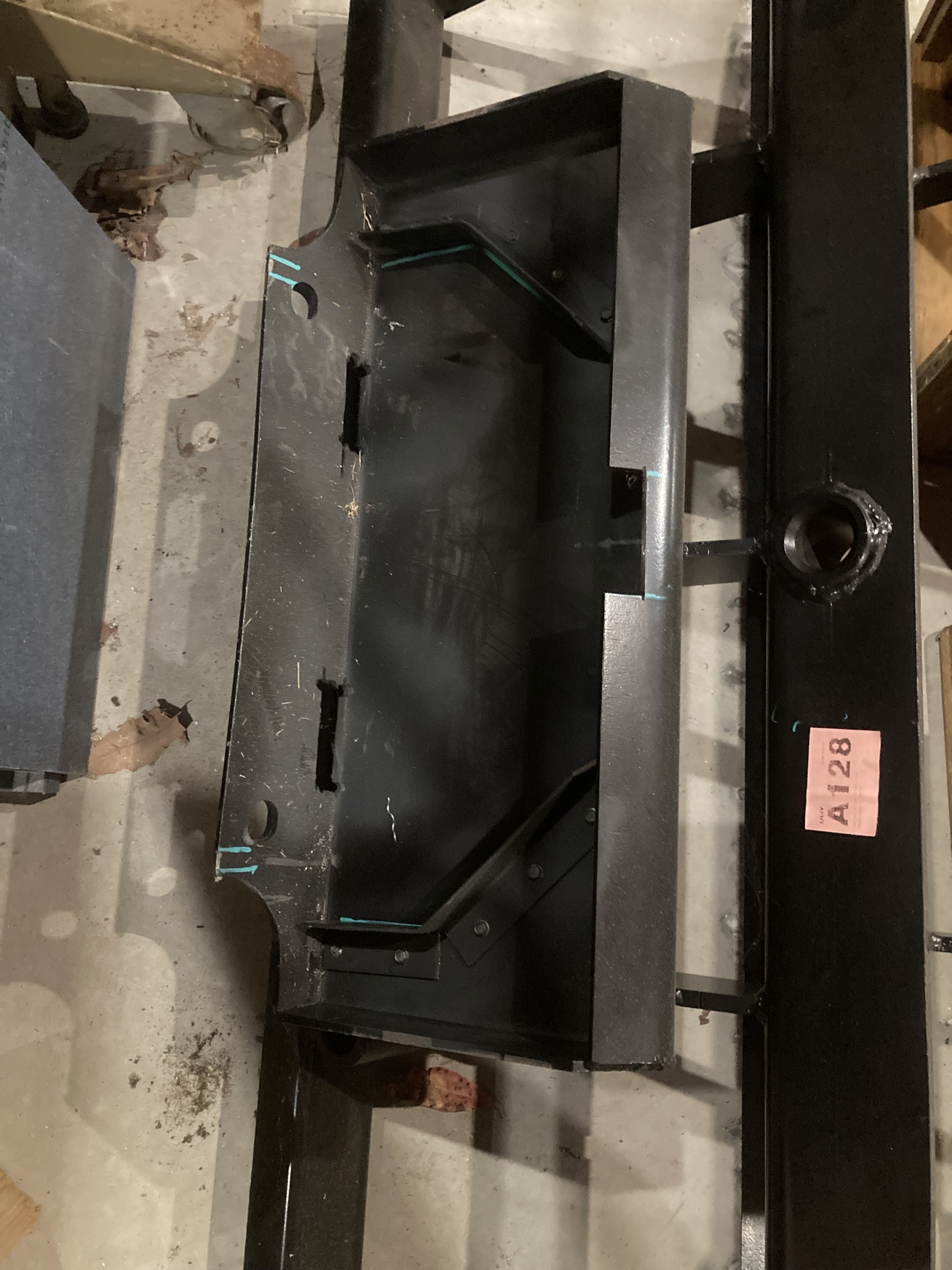

Are you using the universal/dingo quick attach that’s on the forks? Did you just have to cut that notch on the top of the plate to accept it?View attachment 718255
Thank you! Might have to start doing this so I can use dingo attachmentsI notched the top, add holes in the bottom and added angle iron at the correct locations
