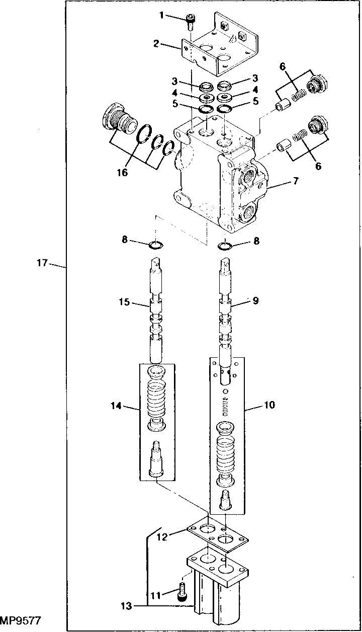

My loader on my 790 has always slowly leaked down, but lately it is much worse. Not only does the bucket slowly turn to dump (especially with a load in it), but the bucket goes down toward the ground as well. I had to raise and turn the bucket every 10 minutes while running the tractor yesterday. It does the same with the tractor not running too.
Any ideas on what is causing this and what needs to be done to fix it?

There are two things that can cause your FEL to leak down. One is the cylinders and the other is the valve.
If it's the valve-then unfortunately there is no easy or cheap fix. The valve has NO internal wear parts that can be replaced. There are no O-rings or seals in it. The spools (the metal part that moves when you operate the joystick) is a precision lapped fit into the valve body and cannot be bought as a separate part. When the tolerance gets out of spec than the only solution is to replace the whole valve assembly. All of the valve used on CUT's are like this and can be expected to leak a little...JD even has a published document of "acceptable" leakdown times.
If it's the cylinder's, then they can be rebuilt with new seal kits. The kits are about $25 per cylinder from JD-or you could take them to a hydraulic shop and have them do it.
The best way to determine the cause is to raise the loader off the ground and rest it on something like a jack or pickup truck bed, then unhook the QD's from the tractor. Now remove the jack or pull the tractor away from the truck and observe the time it takes the loader to leakdown. Most likely the loader will still fall indicating the cylinders are bypassing internally.
Since think the problem has gotten worse recently...then I would assume the cylinders are your problem and not the valve. This is not unusual...
/ 419 Loader - Leaking? #4
Actually, there are a number of seals and o-rings in the valve body. The attachment is from the JD parts website.
I'm pretty sure the shop manual discusses rebuilding the valve...also the measurements.
You'd need the shop manual to rebuild...mostly for the spool's wear measurements
Kennyd's 4110 may not have a rebuildable valve...but the 790 does.
Good point about the cylinder internal leakage...something to check out.

/ 419 Loader - Leaking? #6
That pic shows no seals between supply and return ports.
Those o-rings shown are for valve shafts exiting the valve body.
Read the two posts again. Kenny stated there were no seal or o-rings in the valve....there are. If the body is torn down to measure the spools, you'd want to replace them. It's be nice to have a schematic on hand to see the flow... However, there are multiple seals so, yep, I'd suggest a torn or worn seal could cause the leakage.
Measuring the spools wouldn't be so bad, if you have the specs and a tenth micrometer. Measuring the bores would require more specialized measuring equipment. Of course, the valve body itself could be defective (cracked, for example)
But again, check the easy stuff first. Might fix the problem. Also, I don't have that CD-ROM handy, I think there's a check valve in the system. That could be leaking down and would be cheaper and easier to fix.
