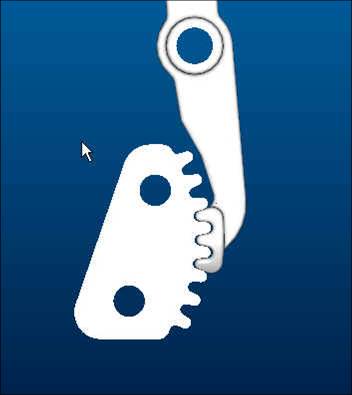

On my 2005 4120, there are two springs that apply tension to the adjuster teeth. They're right under the column boot. To date, I've needed to replace two of them. Usually when the wheel starts dropping down, I've had a broken spring. They have done some updates to the steering system since mine was produced, but I don't recall what they were.

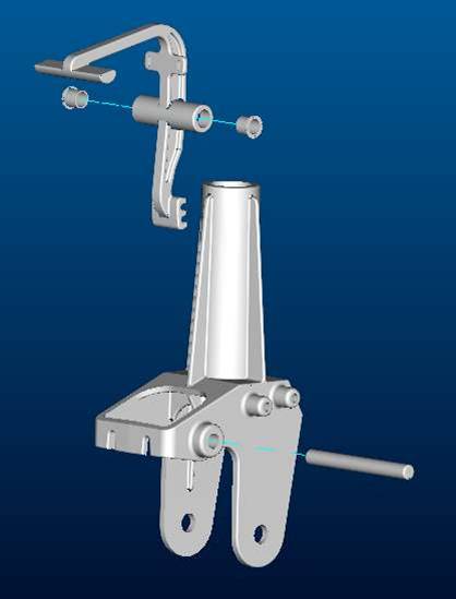

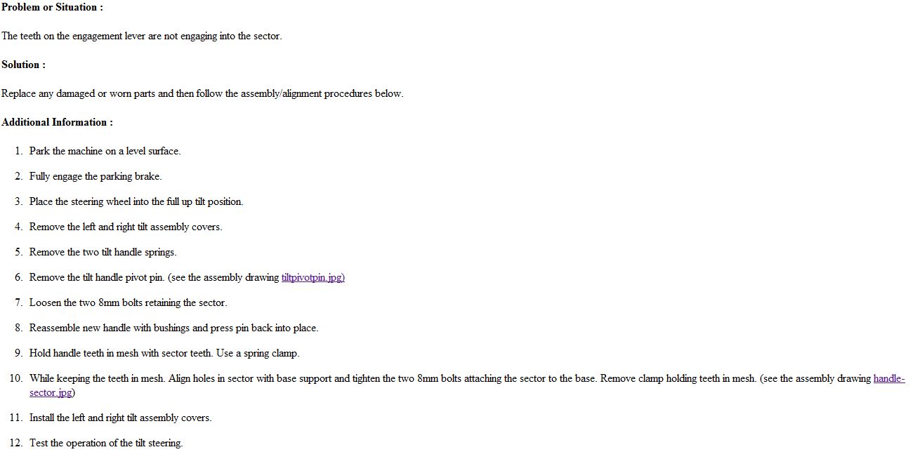

/ 4120 Tilt Steering Issue #6
Check this out.
Tilt pivot pin
handle sector

My 08 3320 had the same issue after about 9 months of light usage. At that time the service guys said the repair was to take a die grinder to the teeth to remove the rounded edges.

Yeah thanks a lot for the info & there is some good tips there. I got mine fixed. I put stronger springs on the lever you lift up to tilt it. Works a lot better now it will not budge no matter how hard you move it.
