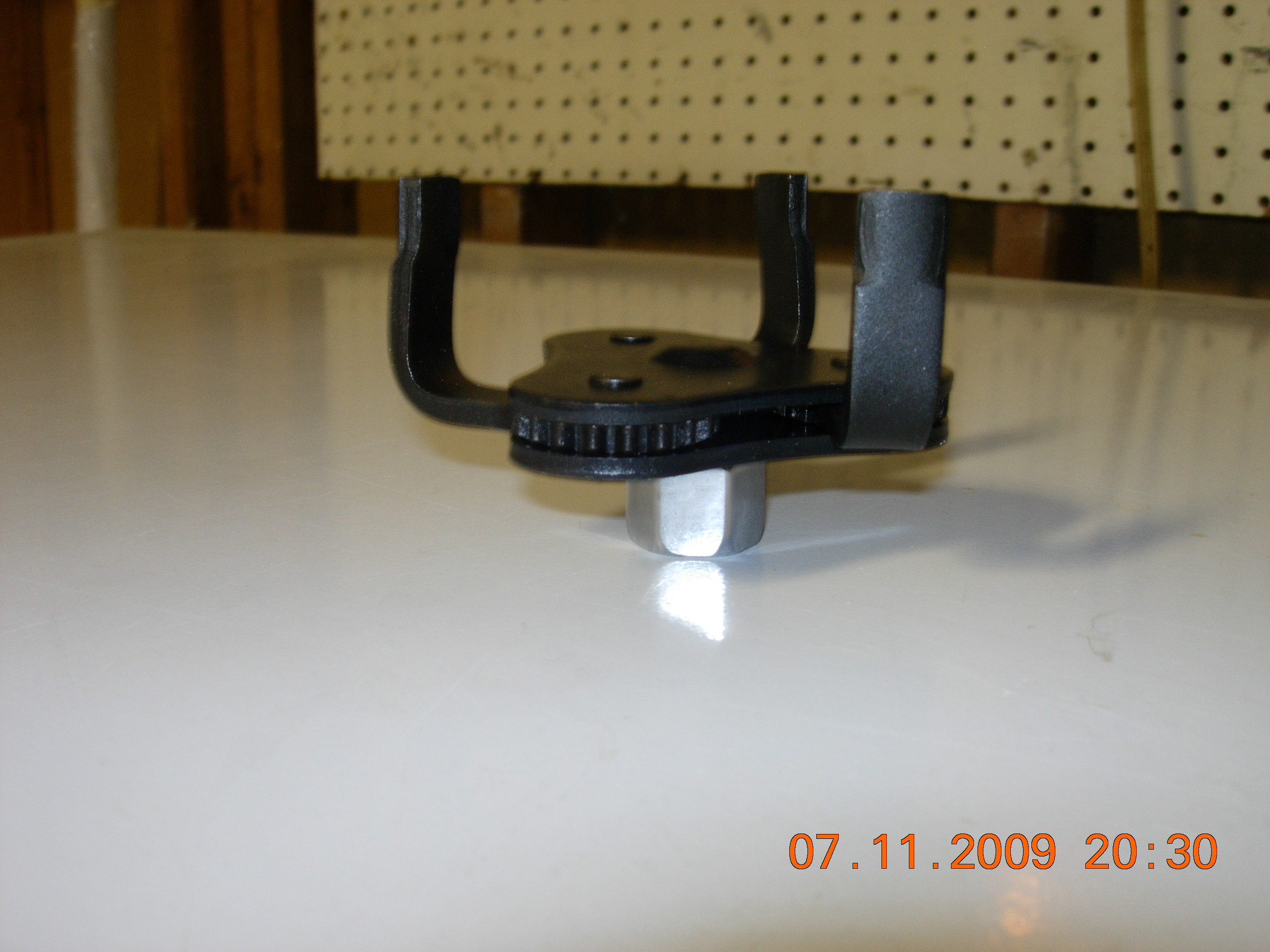

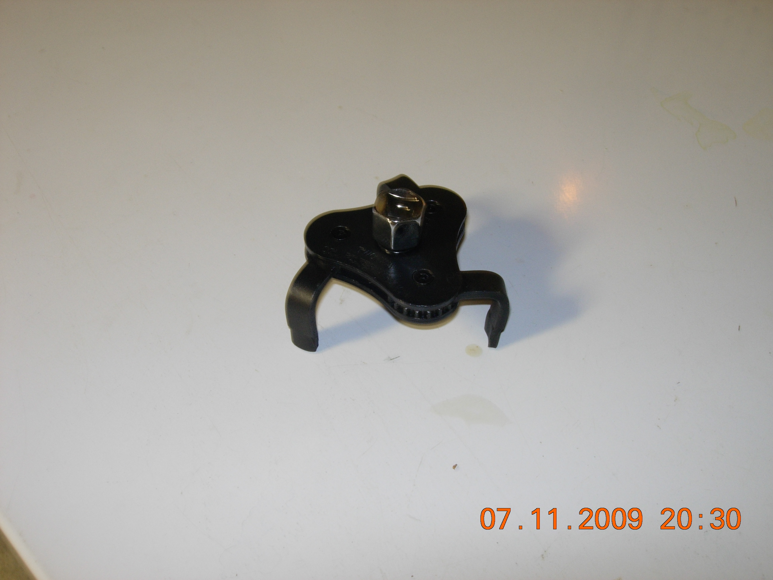

/ 4110 Oli filter removal #7
Sounds like you were able to get the filter off.
I have an 1815 tractor and I had the same problem on my first oil change, but I couldn't get a band type wrench on the filter just not enough room.
I found a different type of filter wrench that worked pretty well.
It's adjustable for different sizes and gets a good grip on the filter.

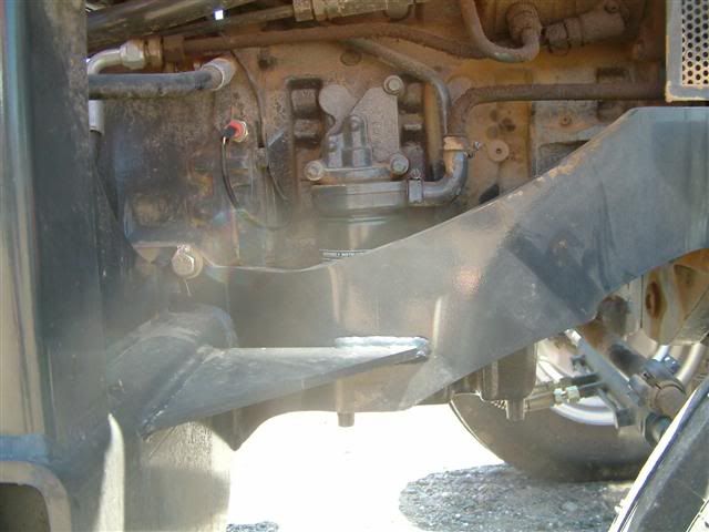

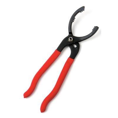

The oil filter on my Mahindra 5525 is almost completely obstructed by one of the FEL support members.
I can get to the bottom of the filter and to the top 1" of the filter. So I use this $9 Fram filter pliers from Walmart to grab around the accessible top of the filter.
Works fine.
Works fine.
This is what seems to work for the 4530 too. The designers of these tractors didn't seem to take filter access into their design criteria.
