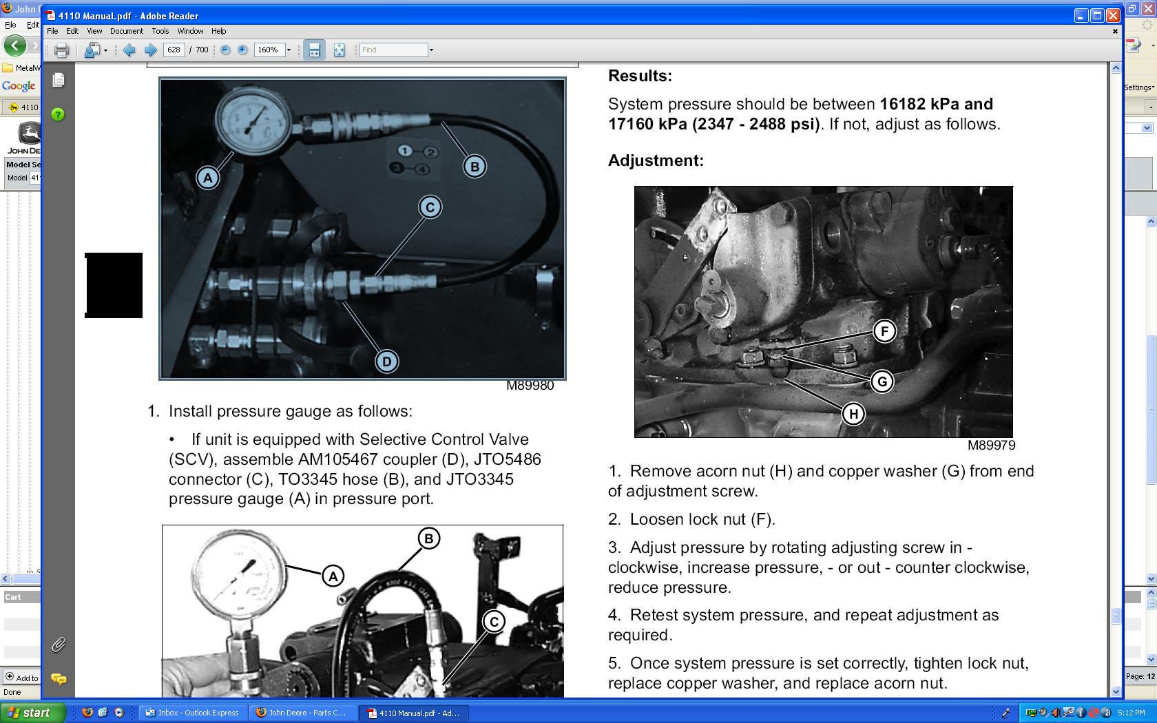

I recently checked the pressure on my little kubota and found it low. I shimmed it back to top spec and it made a pretty good difference. My neighbor has a JD4110 and he thinks his might be low and wants to check it.
I told him I would ask on here.
What should the pressure be at the loader lines?
Where is the relief valve for the loader hydrualic system?
I searched and found a thread where someone was having trouble with the steering system. The valve they shimmed was right in front of the operators seat. Would this control the whole system or is there a separate valve for the loader?
Thanks
/ 4110 hydrualic pressure? #2
Going by memory, it's about 2450PSI. The PRV is under the seat on the right side of the tranny. There are no shims for the 4110, just a bolt with a jam-nut. I have more info at home and get more specific later if needed...

/ 4110 hydrualic pressure? #4
Bernie,
It's on the right side, but must be reached from under the tractor. Just under the rockshaft valve...it's up there and its a long reach-but doable. Look for the acorn nut;)
See picture attached, spec is 2466 PSI.

Thanks very much this is exactly what I was hoping to find.
