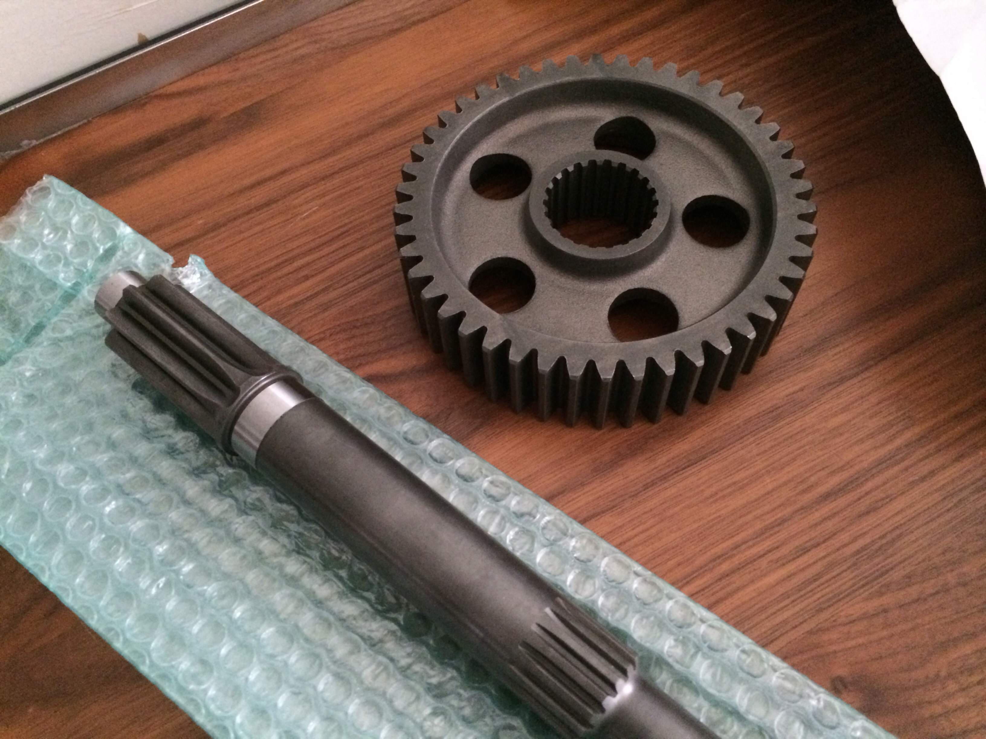

Okej, so parts (gear and pinion axle) ordered from Green Farm Parts: John Deere Parts Online Discount Store for delivery to my friend in Philly, who will bring it to me when we meet on a tradeshow in Germany next wednesday.
A total of $527
If I had taken the easy way around and ordered this as Hako spare parts in Sweden, the total equvalent in USD would be $1304. That is just slightly less then I payed for the entire tractor. That's how bad it is with parts over here, so you can imagine that I happily went through some work in order to verify the fit. :)

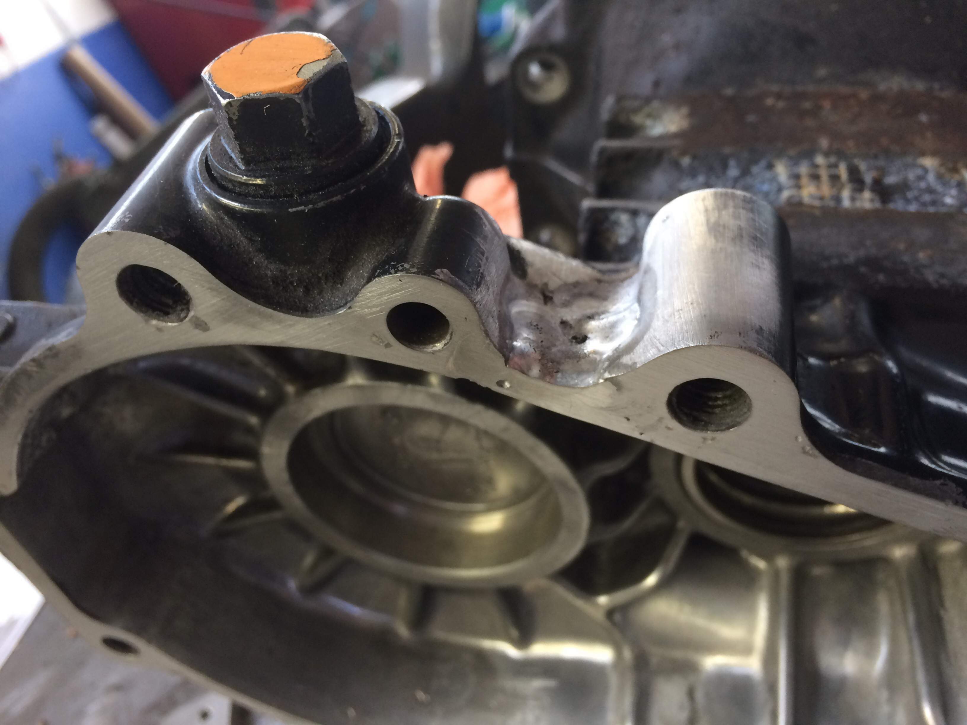

OK, if you like, I will document it here :)

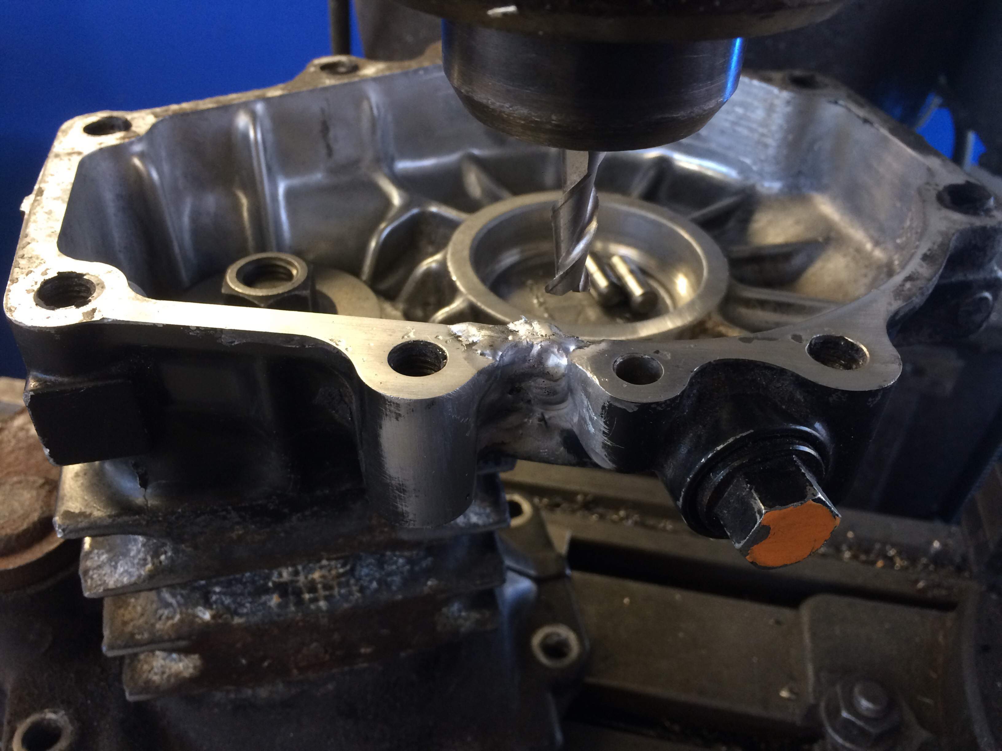

The plan is not to change at all. I'm going to weld it in and mill the surface flat again. I can only hope for a good result when it comes to welding, alumium can be tricky. But from the looks of it I think it is pretty weldable and with some extra care with the sealant I'm hoping to get it to work.

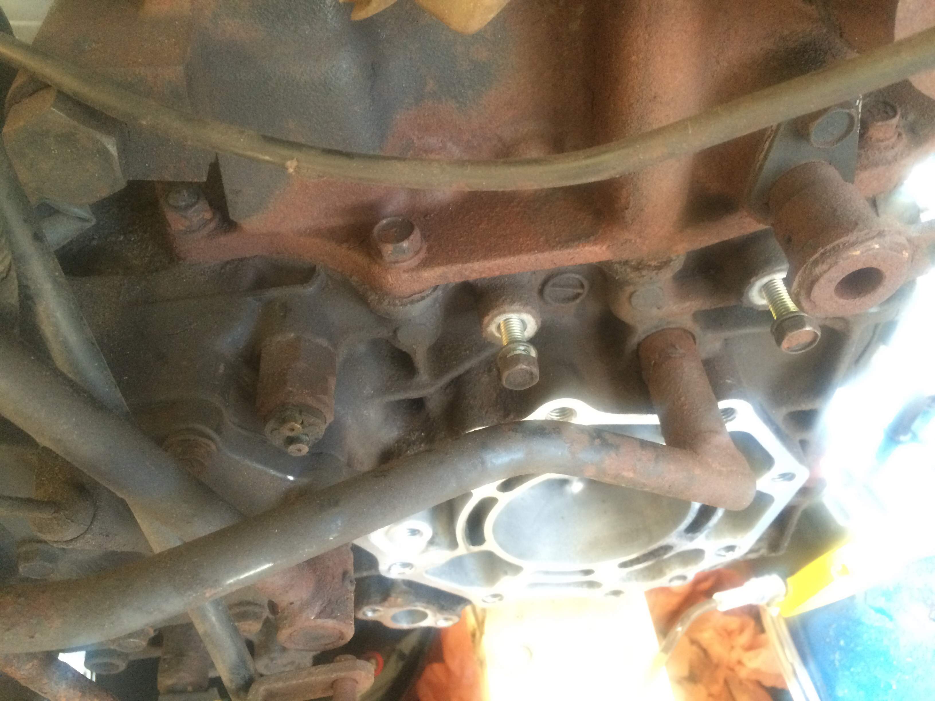

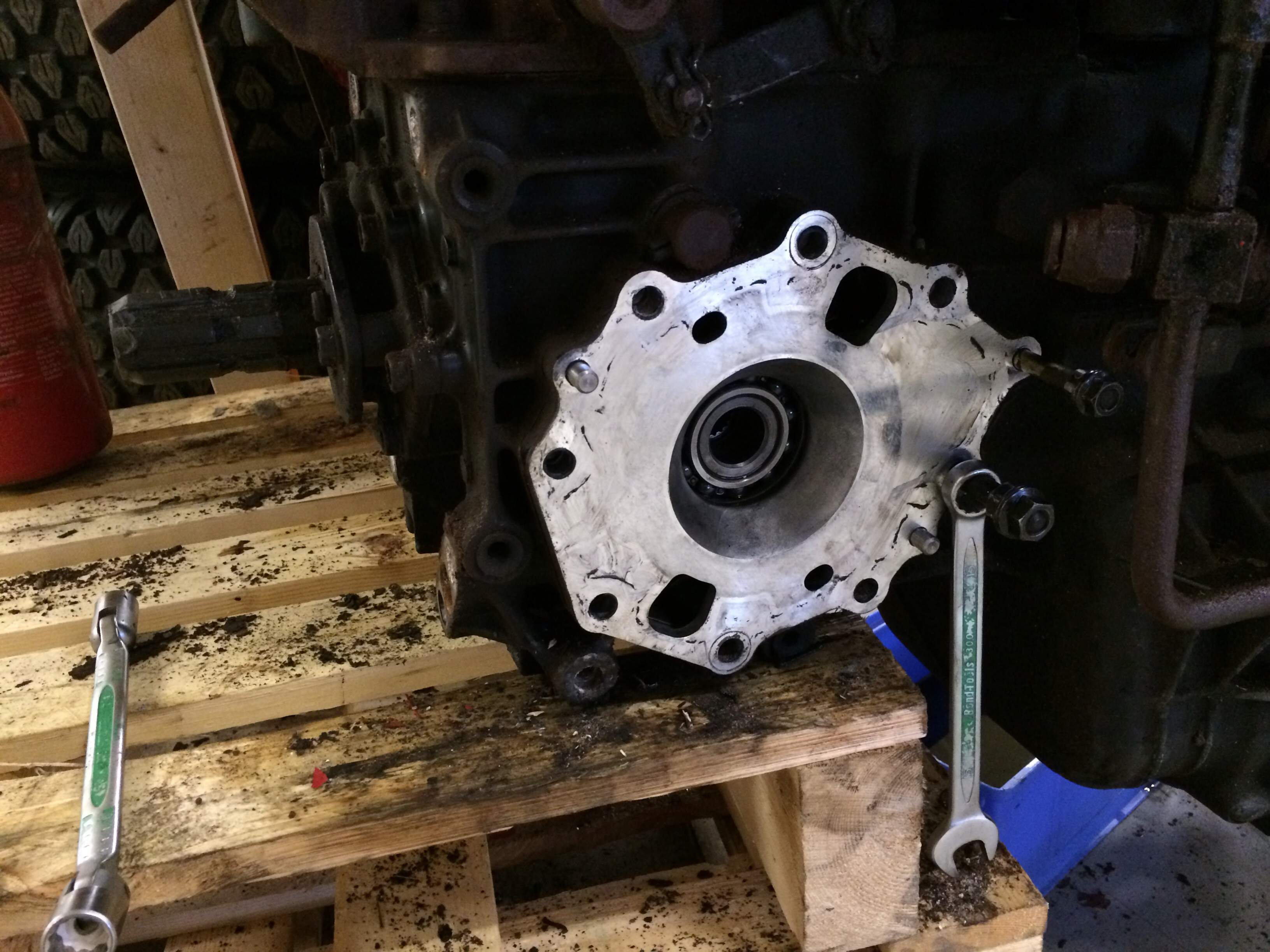

A bit more has happened.
To start with I've had delivery of the parts and it was indeed the right ones. Yay!

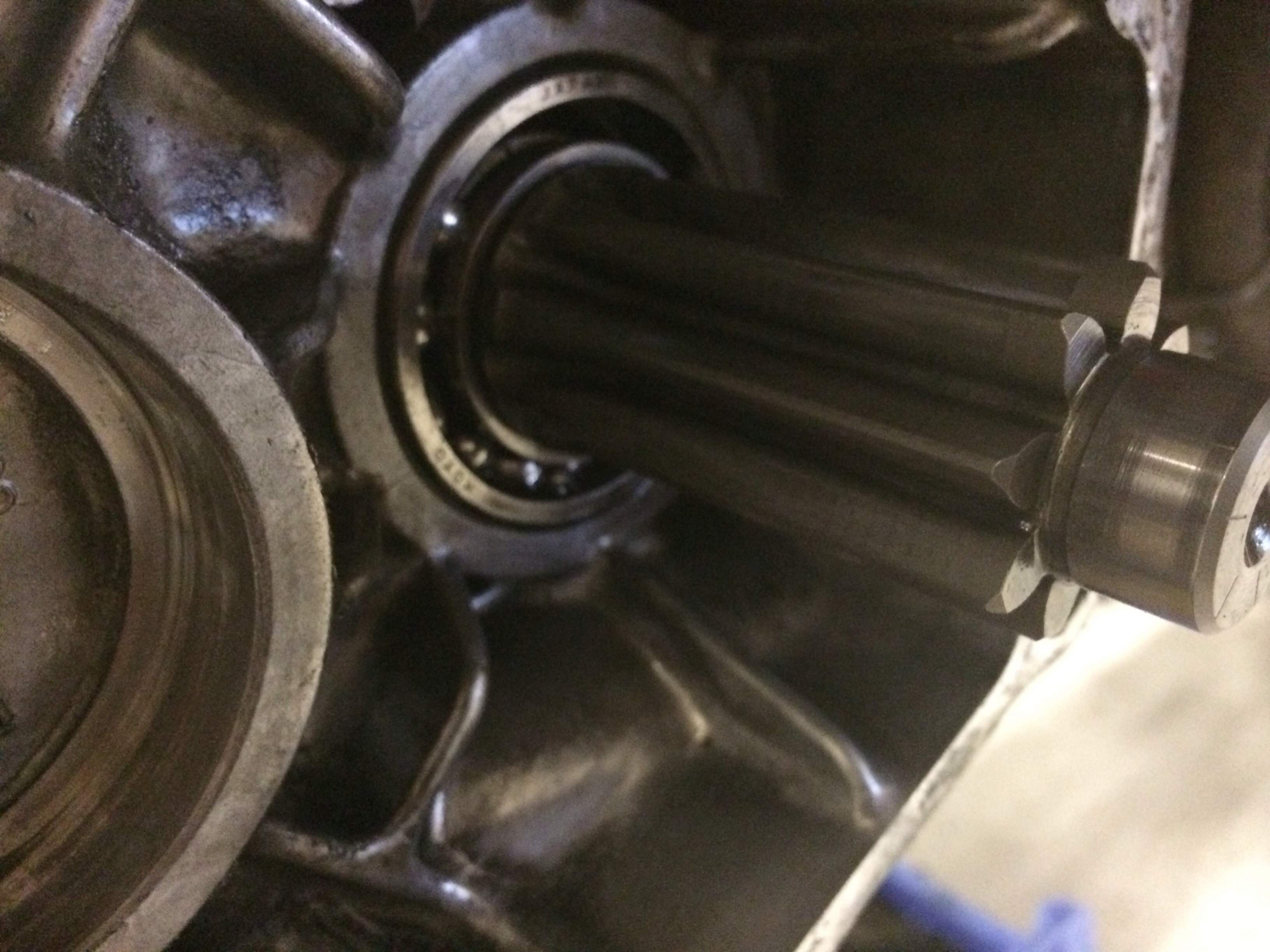

Also I've removed the right side final drive where there was also metal chips coming out of the drain plug. Not a very nice surprise. Here as well the bearing was busted but luckily there were no harm done to the gear and pinion.
So the plan now is to start with removing the differential which is hiding behind the shiny holder plate thats on one of the pichtures. Just need to fabricate some sort of puller tool to get it out. After thats gone I will get a good view into the gearcase where I can inspect all the gears close to where the debris has flown around and also clean the gear case thoroughly.
When this is done I will decide if I need to remove more for cleaning or if it is time for re-assembly.

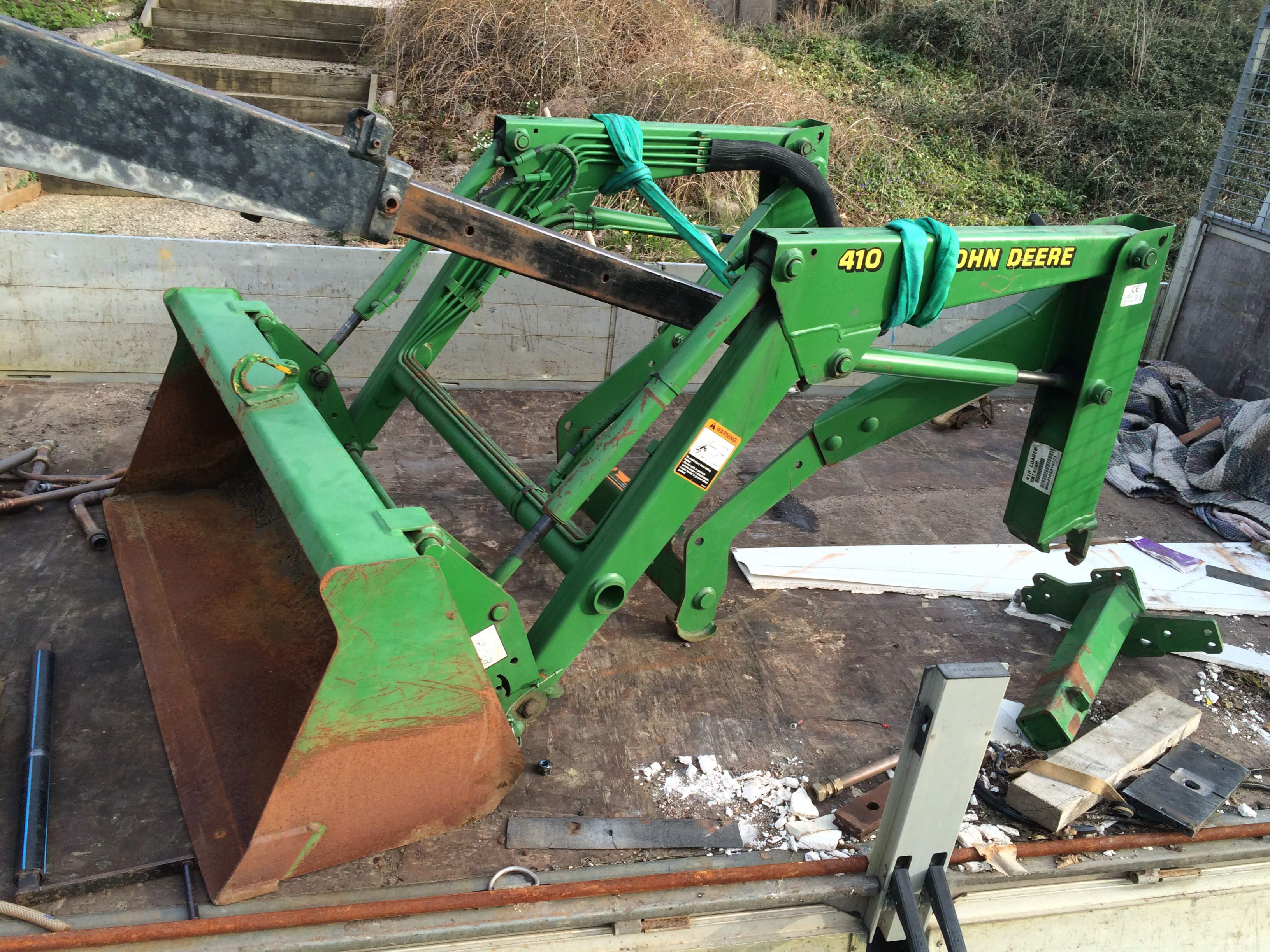

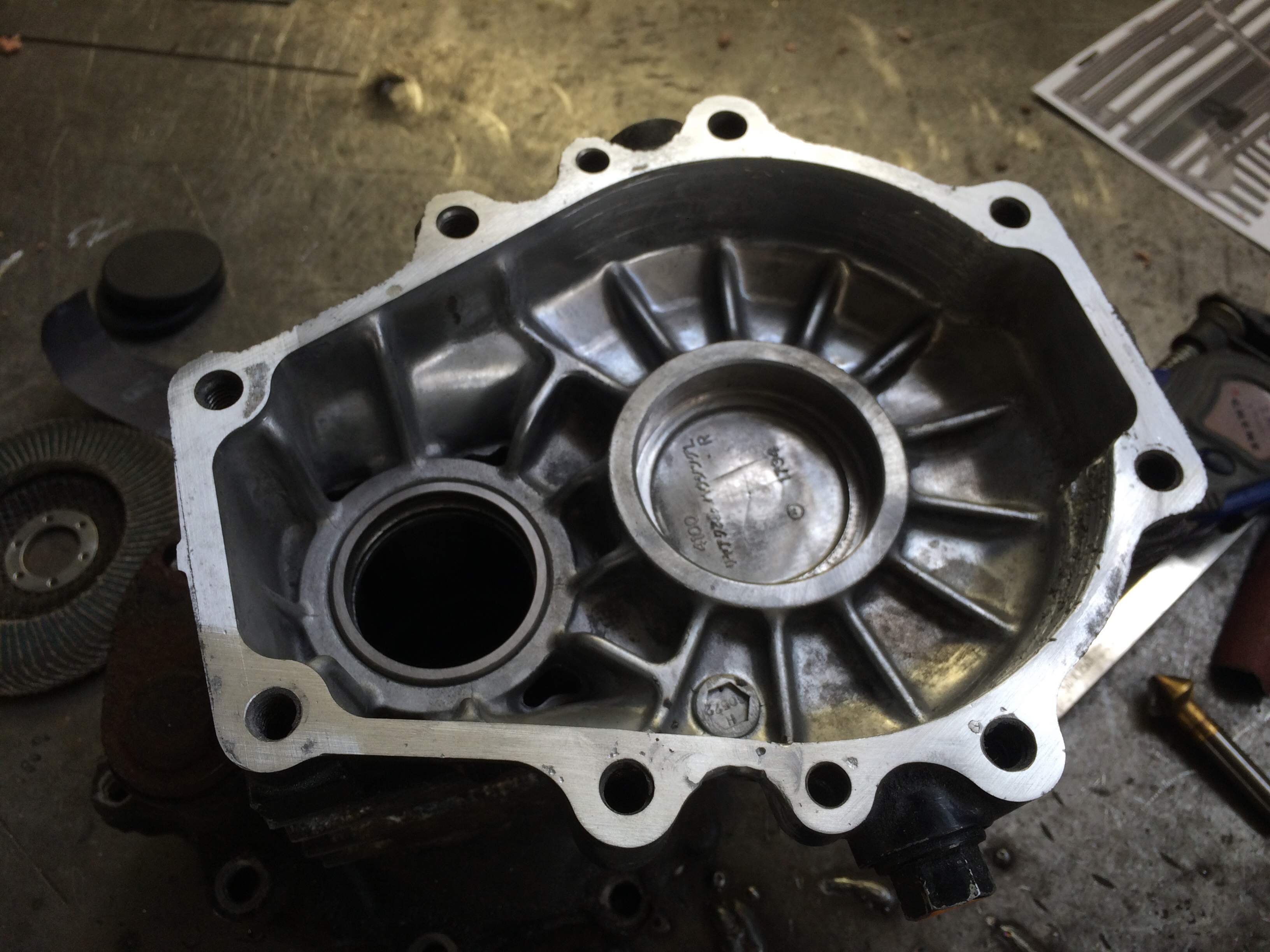

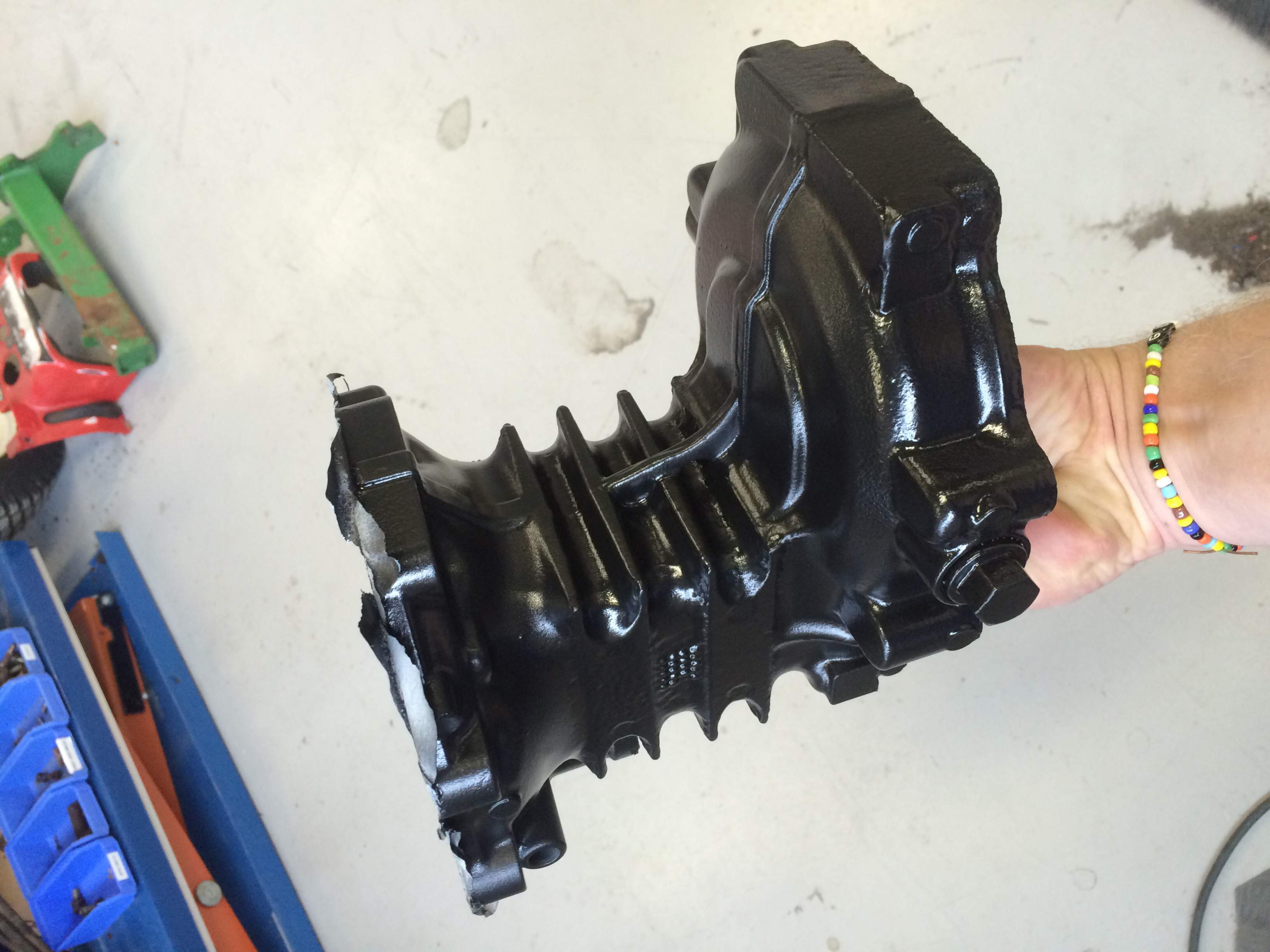

I'ts been a while and basically other projects ended up taking all my time and I haven't made any progress in the past year. Up until a few weeks ago where I stumbled on an ad for a 410 loader including the bolt-on frame mounts and everything. To make such a find in Sweden is very unlikely and on top of it, it was only 80km from me so I had to have it. Payed equal to $2000 and I don't think I've seen anyone around on eBay cheaper so I'm very happy with that deal even if it was more than the actual tractor. It was in nice shape too.
As could be imagined this gave me quite a bit of motivation and I'm now pretty close to getting it up and running. The PTO shifter problem was just a matter of a jammed lever, the actual axle that goes into the tranny could be moved by hand no problem once disconnected from the lever.

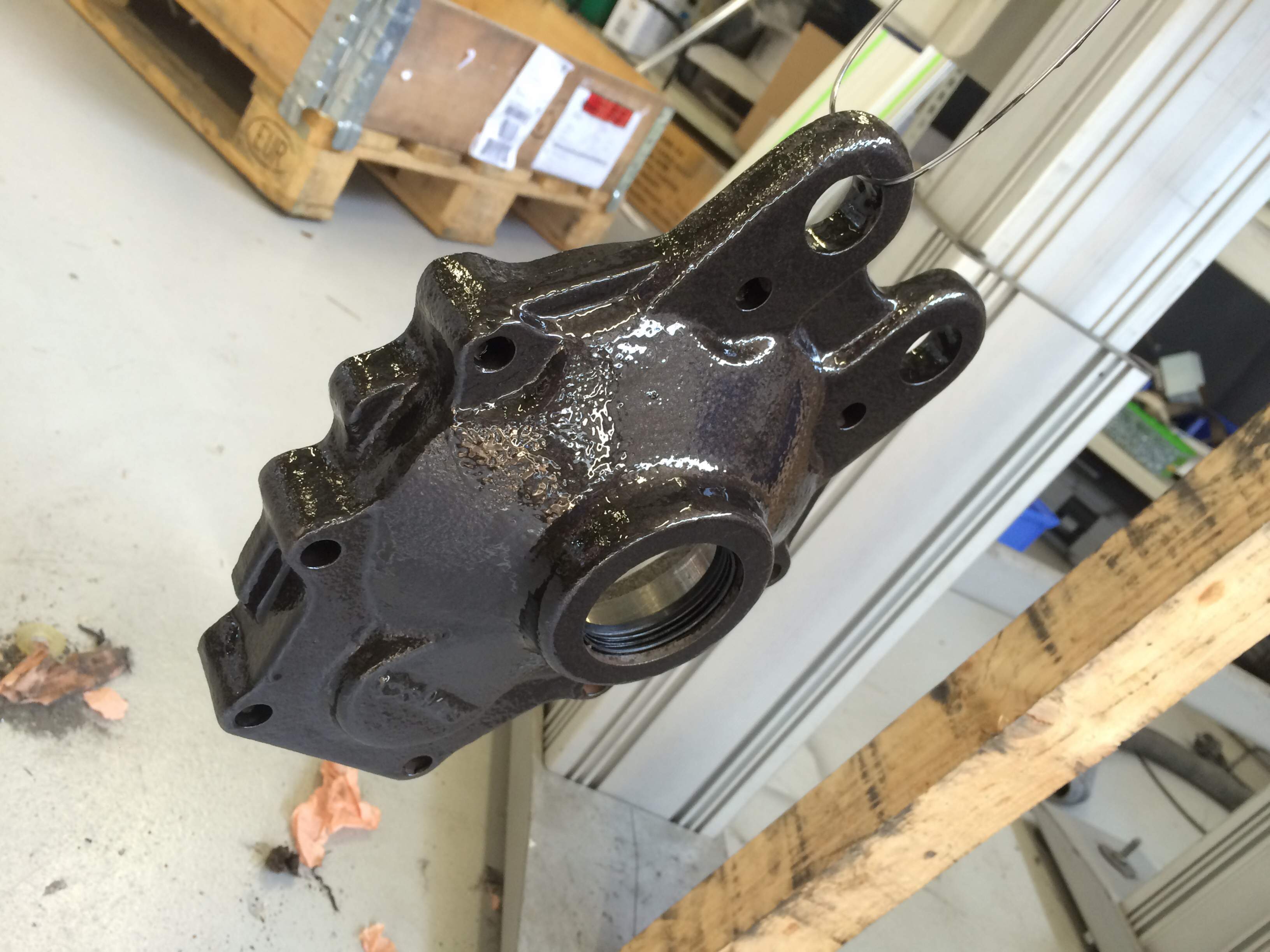

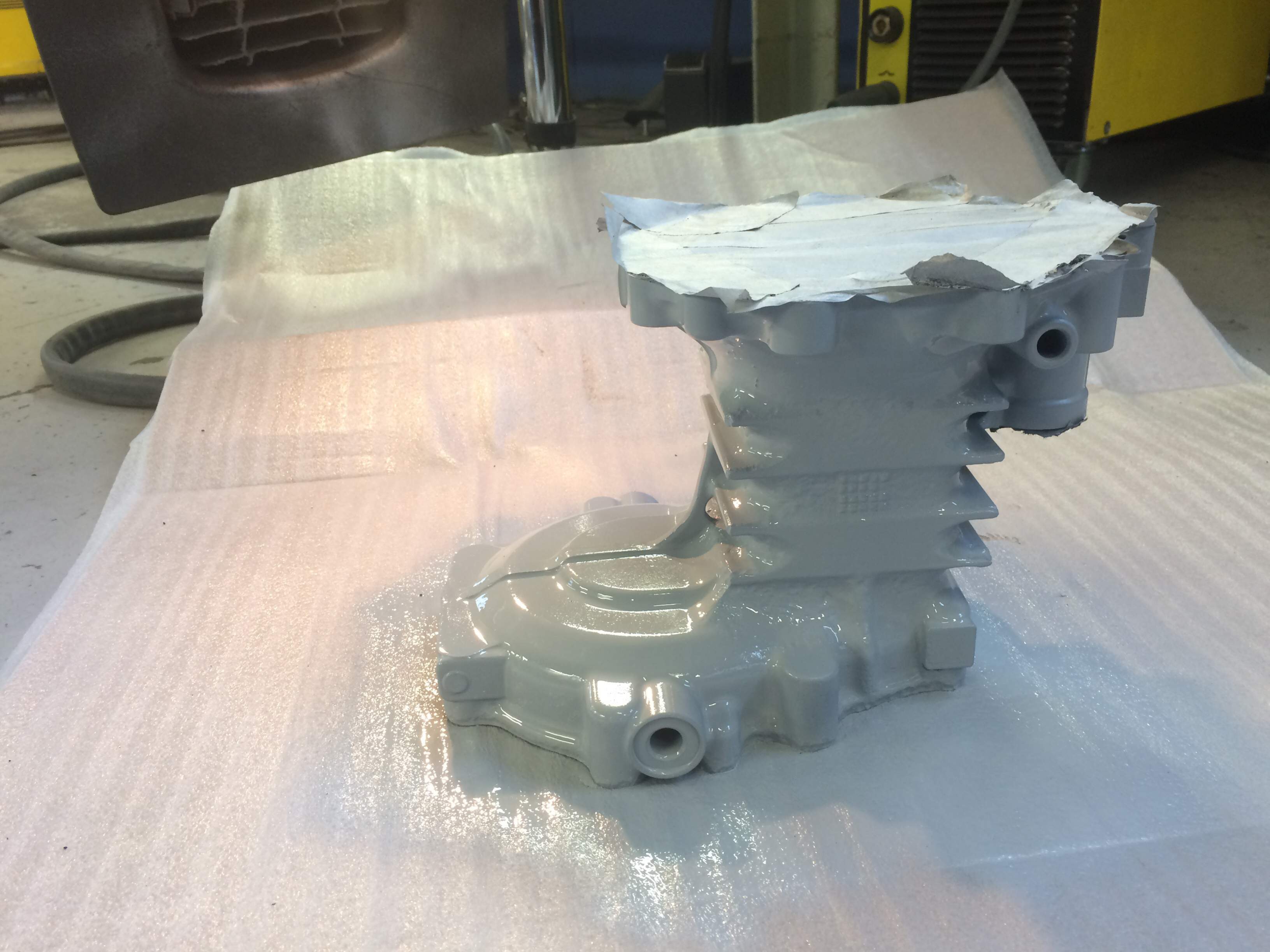

Right now I've welded and milled the broken aluminum gear case. It was a pretty weldable material however I managed to get a pore in the sealant surface. Nothing the sealant won't take care of but still disturbing. Today I've sand blasted and painted the parts and with a full set of new bearings at hand I'm looking forward to assembly and tryouts this weekend. I'll probably continue with some restoration since I've got it apart but I'm really excited to get it operatioal.
Let's just hope there's no negative surprises. :)

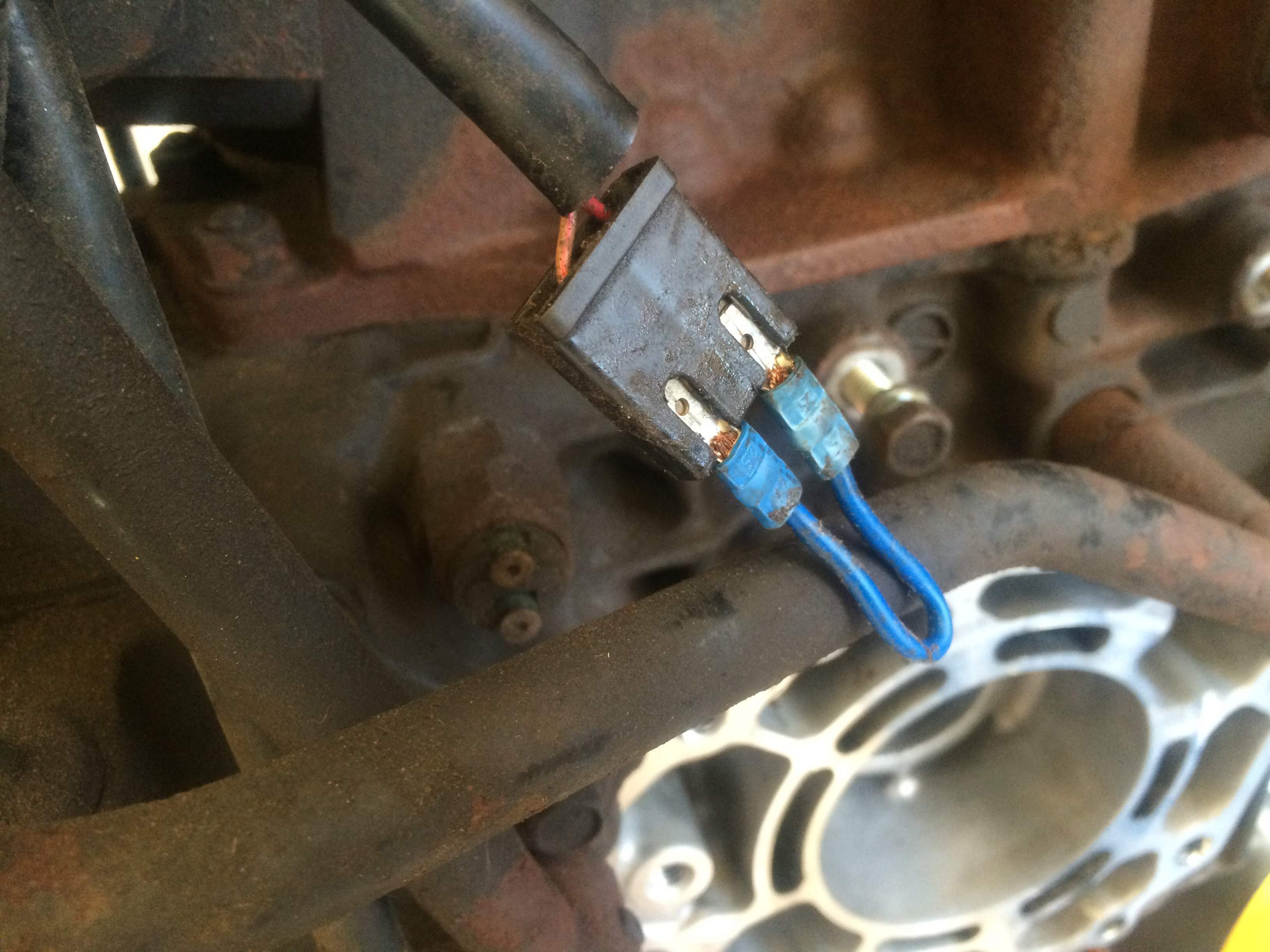

Ah.
Makes sense it should be some starter breaker since I found this under a few layers of tape on the connector. For some reason it has been jumped. Maby I will find out what's not as it should when I get it started. Should try to locate some schematics to be sure too.
Perhaps this thread should be moved somewhere else in the forums?
Forgot the pichure.
