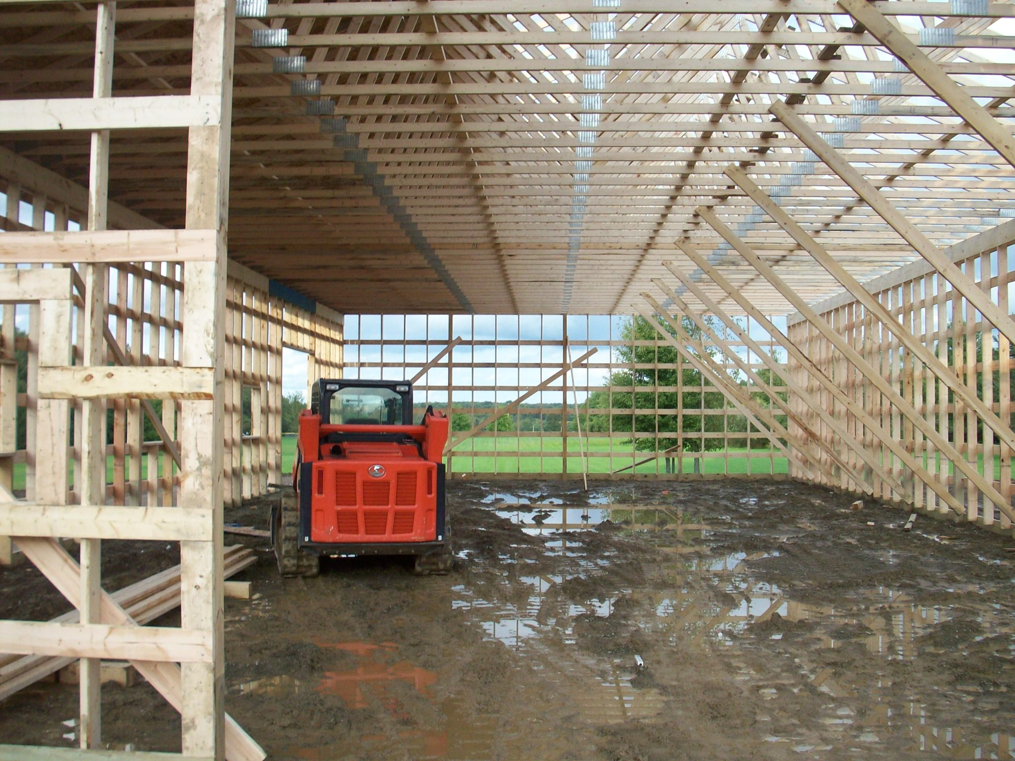

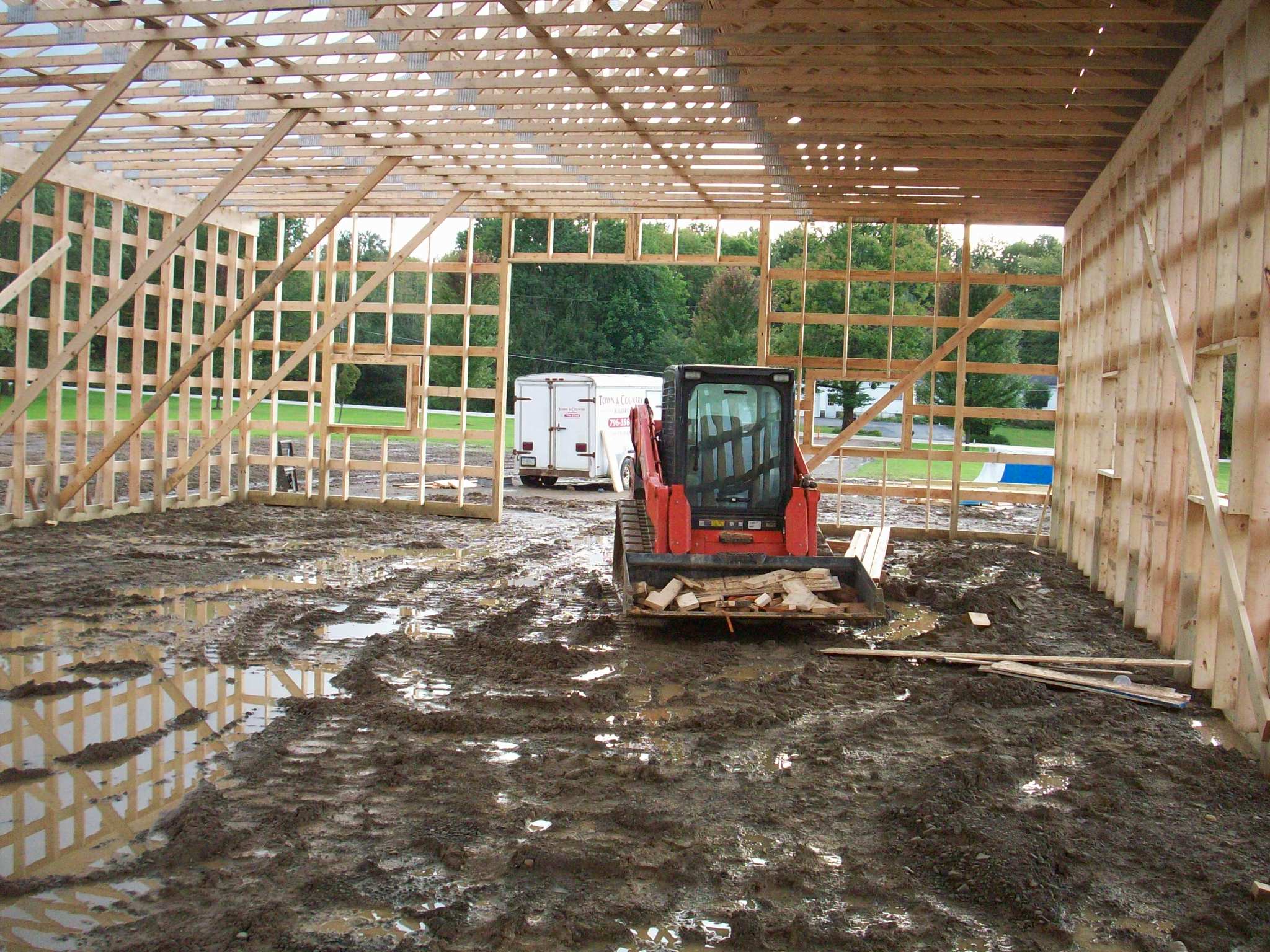

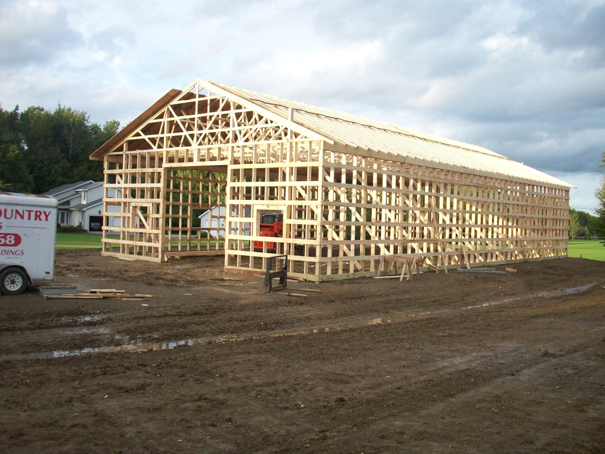

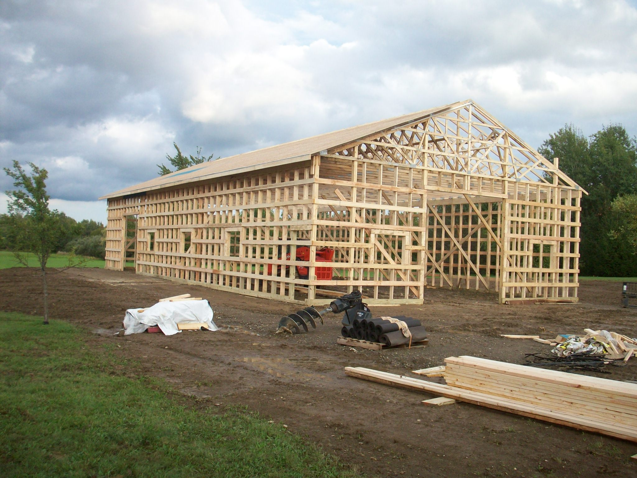

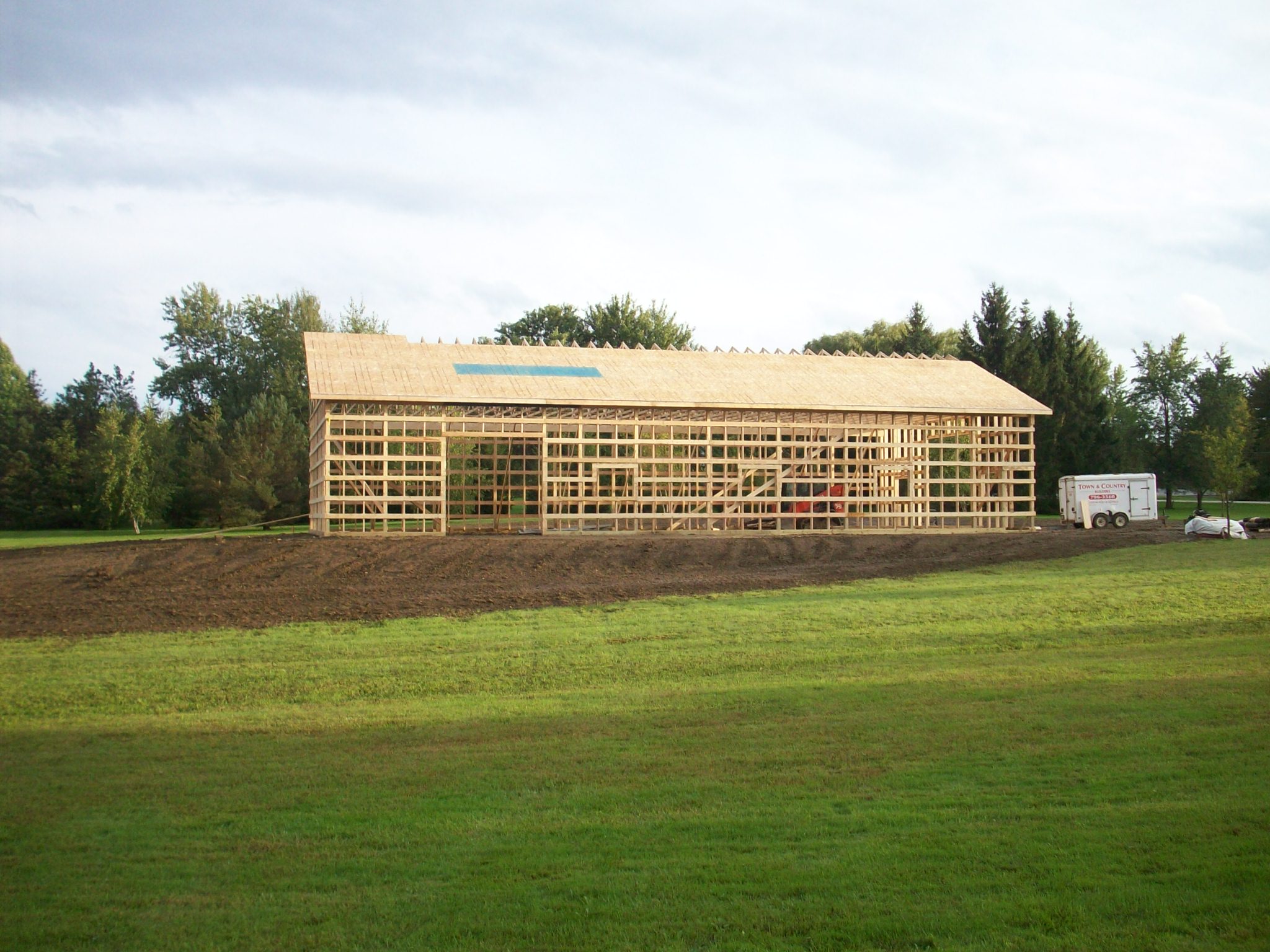

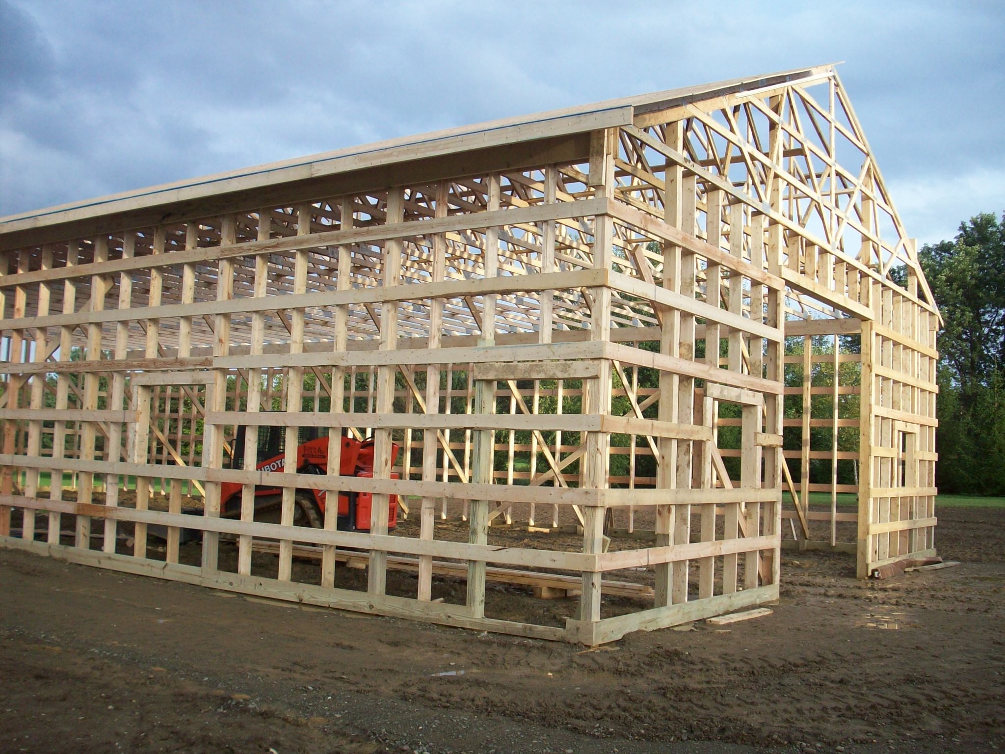

The contractor started on Monday, the weather was great.. then we got a day and half of heavy rains, This is how much they got done.

That's a really good looking barn, not nearly as cheap-looking as a lot of pole barns, it looks more like a stick-framed building. I'm trying to figure out the framing from the pictures. It looks like a pole every 8 feet, poles are 3 2x6's built up with pressure treated below ground and untreated over. A 2x6 stud every 2' between poles and 2x4 girts and purlins. Trusses on 24" centers. Sound about right?
/ 40x80x14 #6
Impressive looking building. I've never seen studs installed like that on the purlins, between the posts. Will you be pouring concrete?
/ 40x80x14
The girts are treated 2x8's and the purlins are 2x6's,but your correct on everything else.
