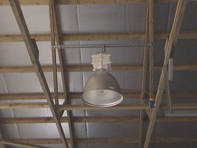

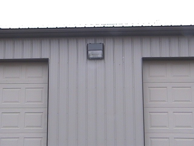

</font><font color="blueclass=small">( <font color="blue">RedDog - I like your outside lighting fixtures! Could you ask your contractor friend as to the manufactuer and where he got them from. </font>
I like the clean "commercial" look of them. I will ask him soon, probably next Nascar race, as he is a Ford fan and I'm Chevy. Makes for interesting conversation between us. /forums/images/graemlins/wink.gif I still have some of the boxes laying around.
All my light fixtures were purchased at Loeb electric in Columbus, Ohio.
<font color="blue"> Also, an estimate of per fixture costs. </font>
The one outside light was $154, and I still need to buy another one. /forums/images/graemlins/frown.gif The six interior lights were $740. /forums/images/graemlins/crazy.gif So as you can see I have quite a bit $$$ in lights. /forums/images/graemlins/shocked.gif
RedDog )</font>
Bluecreek, I think reddog has shared the cost of the fixture.

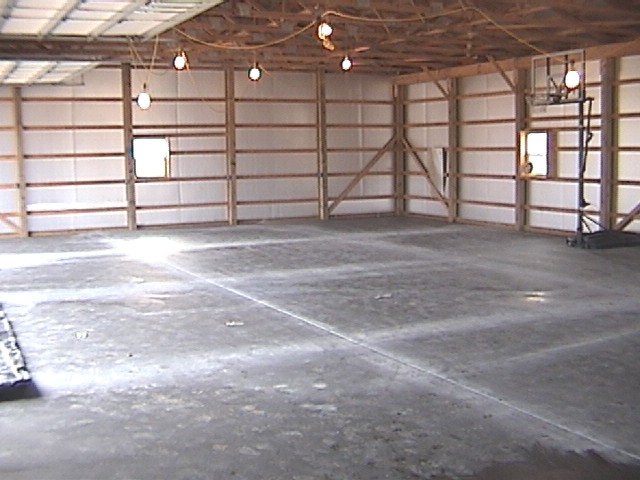

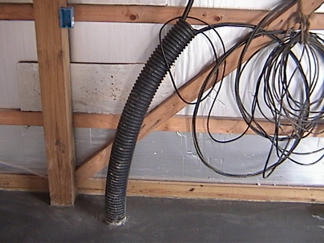

</font><font color="blue" class="small">( Great looking barn Reddog. I hope to build one in the next few years and what I have planned is very similar to yours. )</font>
Thank you! /forums/images/graemlins/smile.gif I'm not finished with it yet. I still need to get the aprons poured, and a couple more lights.
As of right now, I have 36 electric boxes wired. /forums/images/graemlins/blush.gif To me you can never have enough outlets.
RedDog

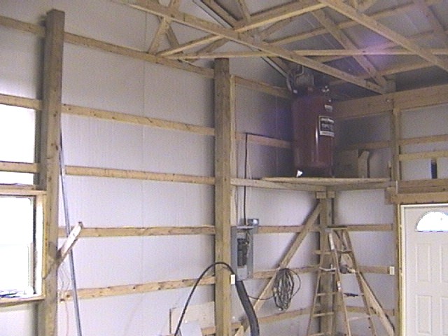

</font><font color="blue" class="small">( I mounted the air compresser up in the air. I like it up out of the way, plus a refrigerator will be going beneath it.
My brother brought me a bunch of rough cut lumber that I figured I my as well put to good use. /forums/images/graemlins/grin.gif
RedDog )</font>
Interesting method of handling the compressor, did you consider mounting it outside under it's own small roof? I'm thinking about doing that to reduce the interior noise when it runs.
Oh, and laying out a 40'x72' pole barn myself using the same construction techniques.
/ 40'x64'x12' Pole Barn
#69
Re: 40\'x64\'x12\' Pole Barn
<font color="blue">did you consider mounting it outside under it's own small roof? </font>
No I didn't. I knew all along where the compresser was going to go.
A friend of mine did his that way. I figure he forgets it is even out there!! Probably forgets the maintance on it also. /forums/images/graemlins/crazy.gif
Good luck on your building. RedDog
