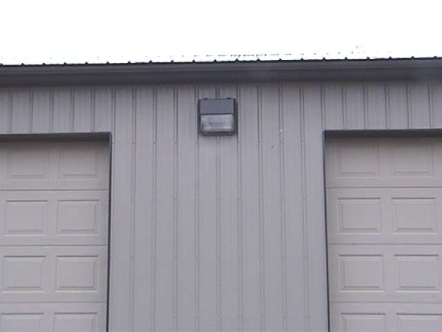

A picture of the 175 watt outside light. There will be another one added to the other end of barn, along with a 70 watt by the walkin door.
I like commercial looking lights. /forums/images/graemlins/laugh.gif

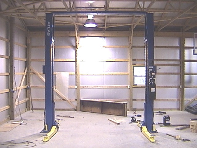

Here is my 10,000lb automotive lift. Before I had the concrete poured, I dug out two 2'x2' pad areas 8" deep where I thought the 2 post would be located at. The manual states 4" of concrete, but I thought more (8") is better.
RedDog
/ 40'x64'x12' Pole Barn
#52
Re: 40\'x64\'x12\' Pole Barn
Another shot of the lift. The Kioti also came in handy setting the post up. /forums/images/graemlins/cool.gif
I must have been pretty close on the pads in the concrete. I drilled all holes 5" deep for the two post, but did not go through the concrete. /forums/images/graemlins/laugh.gif
I have already had 4 or 5 vehicles on it.
RedDog

RedDog - I like your outside lighting fixtures! Could you ask your contractor friend as to the manufactuer and where he got them from. Also, an estimate of per fixture costs. I have the identical lights for the interior and I agree that they give a tremendous amount of light. I can readily obtain an exterior version of the indoor lights readily, but, as with you, I like the clean and sealed version of yours. Thanks - Clyde

Based on the white lite, they look like metal halide units, are they running on 220V or 110V?
I think they're a great way to lite up a work area, better (but more expensive, and more expensive to run I think) than flourescents.
I'd love to have that much clean, concrete, dry, lighted workspace!

<font color="blue"> Based on the white lite, they look like metal halide units, are they running on 220V or 110V?
</font>
The light they produce is very white, which I like. /forums/images/graemlins/cool.gif My panel box was a freebie that my brother gave me. I was a little concerned on space for breakers, so they are on 110V.
I really do not know if they are more expensive or not. /forums/images/graemlins/confused.gif I'm sure if I change them to 220V, it would be cheaper.
<font color="blue"> I'd love to have that much clean, concrete, dry, lighted workspace! </font>
Thank you.

<font color="blue">RedDog - I like your outside lighting fixtures! Could you ask your contractor friend as to the manufactuer and where he got them from. </font>
I like the clean "commercial" look of them. I will ask him soon, probably next Nascar race, as he is a Ford fan and I'm Chevy. Makes for interesting conversation between us. /forums/images/graemlins/wink.gif I still have some of the boxes laying around.
All my light fixtures were purchased at Loeb electric in Columbus, Ohio.
<font color="blue"> Also, an estimate of per fixture costs. </font>
The one outside light was $154, and I still need to buy another one. /forums/images/graemlins/frown.gif The six interior lights were $740. /forums/images/graemlins/crazy.gif So as you can see I have quite a bit $$$ in lights. /forums/images/graemlins/shocked.gif
