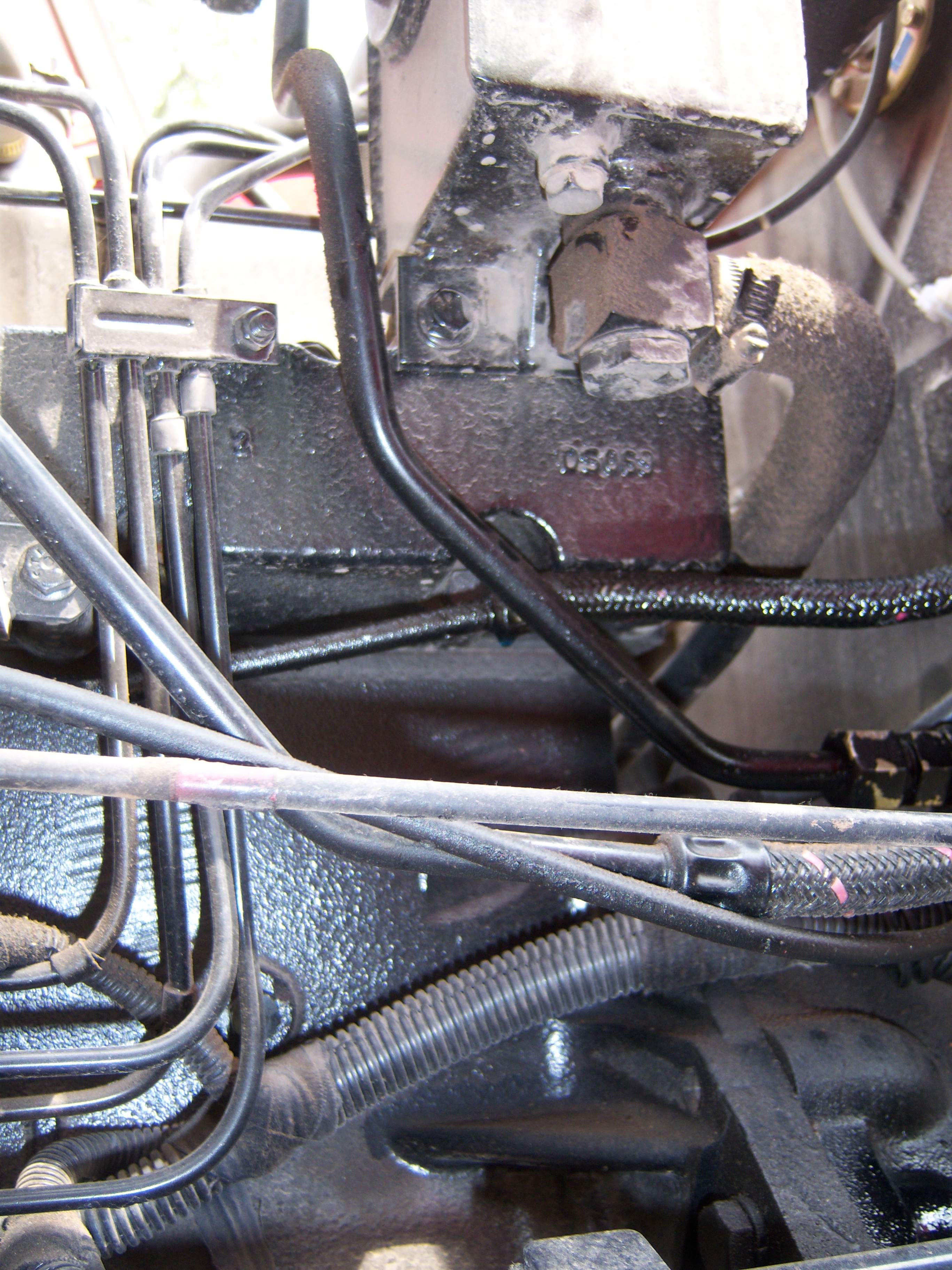

Burzynsr, I think I may have the same leak on my 4025. If I can I will attach a picture. I'd appreciate your letting me know if it looks like the leak you had. I am over a hundred miles from dealer so I'd like to deal with it myself if possible. Thanks

Sorry that I did not reply earlier, I was out of town last week (way out as in South Dakota). My power steering reservoir was leaking around the bracket on the bottom and really was not bad but over time it was making a mess, collecting dust and dirt and also making a mess on the shop floor. I looked at your picture and see a drip on a line below. Mine was dripping on the starter and spred out from there. I cleaned it off a couple of times to verify what was happening. I even went as far as putting new teflon tape on the drain plug to eliminate that. I got the tractor to them before the front to back warranty was out, 5/15/12 was the deadline.

Hey Mahindra One, I might be mistaken and I am sure you checked the fluid leak but that looks to me like diesel, not hydraulic oil. Similar hoses, metal braided sheathing, on my 5035 all carry diesel. I have not seen this type of hose carry hydraulic fluid.
