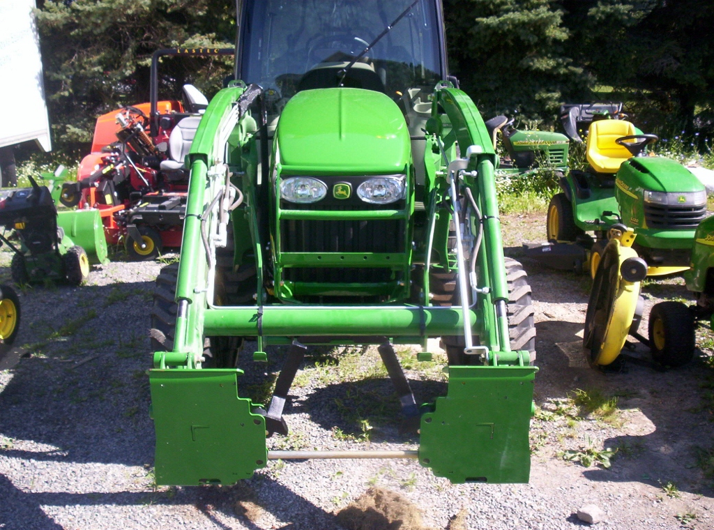

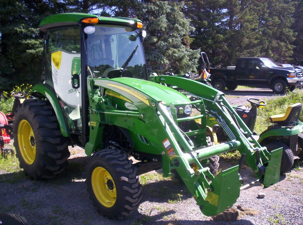

I ordered the SSQA for my 400x. Haven't had a chance to use it yet but here is a couple of photos.

Thanks for the pictures of the loader, those mounts sure look tough.
