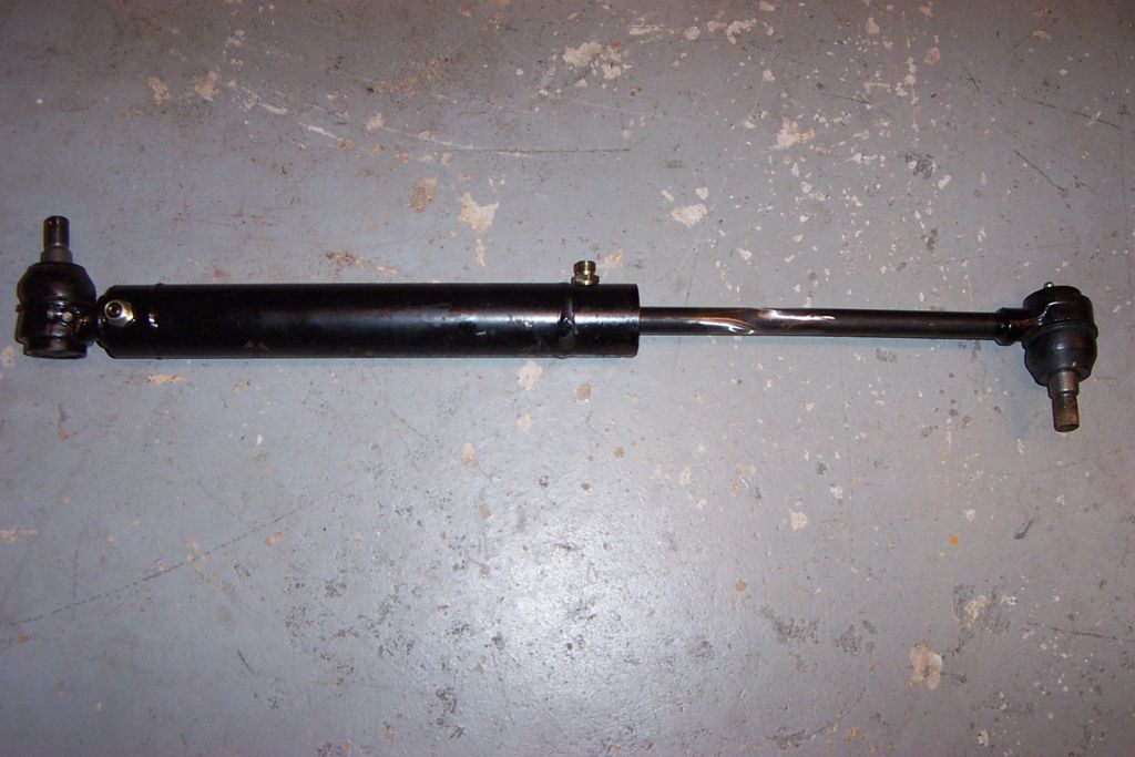

This past weekend I caught a rock which in turn broke the hydraulic steering shaft rod on my 4210. I've attached a pic & I'm curious as to whether any other 4000 series owners have had any problems here & also if anyone has made any mods to make this system better. At $834 Cdn, I'm racking my brain to try & figure a way to protect this cylinder/rod because we have lots of rocky soil here & really don't want to go thru this again. Suggestions/Thoughts ??
Thanks, Eric

Eric,
</font><font color="blue" class="small">( At $834 Cdn, I'm racking my brain to try & figure a way to protect this cylinder/rod because we have lots of rocky soil here & really don't want to go thru this again. Suggestions/Thoughts ?? )</font>
Have you checked with your local hydraulics shop? They might be able to fabricate a new shaft or modifiy a 1 3/4" x 10" cylinder to use as a relacement.
/ 4000 Series Steering Link Damage #3
The 4000 series are vulnerable to damage like this since JD addressed the turf scuffing axle design a few years back and changed the axle design...The older style axles were less likely to have this happen...but that does not help you any....I don't know if the JD Armor All protection package has a part that would cover that or not.... sorry about the problem....if you end up having to buy a new piece you can file a price complaint through your JD dealer,you might get a little bit of a discount....

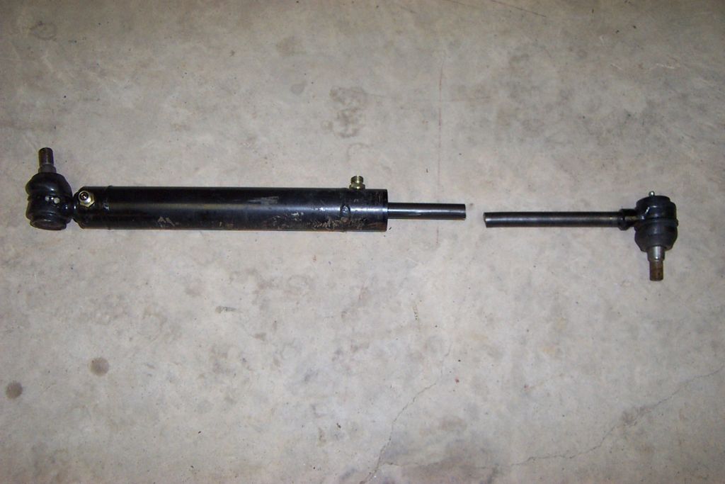

Jim...
Just got home from my neighbour's shop. He's a millwright & as you can see in this attached pic, he has done the best he could which as far as I'm concerned "excellent". He has been quick to point out that it is a short term fix & probably the seal will fail but at least I'm mobile again. See my smile. /forums/images/graemlins/smile.gif
Whoops, forgot pic.
Still interested in finding a long term fix to the design.

/ 4000 Series Steering Link Damage #7
That must have been some 'rock' to get that 'link' damage. Sorry to hear that, but don't suspect it is a common problem under normal use of the series tractors.
Do you have a picture of that rock?
I've been concerned about tree stumps, and getting caught on them, and have rock boulders too. Will try to avoid doing what you had happen.

/ 4000 Series Steering Link Damage #10
The rental package is great. I would highly recommend getting it before they disappear.
But, it does nothing for the steering linkages... I will look st mine to see if there is any good fix...
/ 4000 Series Steering Link Damage #11
Guess I got lucky. I bent the tie rod this weekend, instead of the hydro cylinder -- only $180.00. Backing into some brush with the MX-5, a root snapped up in between the axle and the tie rod. The root won. It came out of the ground without a sound or even a jolt, but it bent the tie rod to the point that it almost touches the hydro cylinder now.
The JD skid plate package doesn't have anything in it for this rather vulnerable area.
/ 4000 Series Steering Link Damage #12
I've bent two and broke one on my 4700, All were replace by JD under warranty. JD had many problems with these in the early 2000's and fixed the problem by a different hardening process of the rod. I am not aware of any protection device for this area so if anyone comes up with something I'd love to see it.
David
/ 4000 Series Steering Link Damage #13
I had a post about a week ago asking if anyone made a "skid Plate" for my JD 4300. I think having the steering linkage below the axle is an accident waiting to happen. Ironically, my 4100 had the steering above and behind the front axle. Much better protected, however, I still managed to catch a stump with it. I am downright paranoid with my 4300 - maybe thats good. Someone who is good with a welder ought to fabricate a skid plate for these tractors. I checked the new 3000 series - they have the same design - steering under the front axle.
/ 4000 Series Steering Link Damage #14
Welcome to the forum.
Seems my connecting linkage rod that is just a bit under the axle is a fair distance above the ground. Not sure what that clearance is, but it will clear the stumps I leave in the woods.
On my previous tractor (Deere 420U), I had a frame (actually built for a snow plow on the front) that stopped me from going over stumps and rocks. Something like that dropping down ahead of the axle and the connecting rod should help warn of tall stumps and rocks. A pan or skid plate would have to be low enough to allow the oscillating front axle to rotate, and wide enough to protect the exposed parts. Raising the connecting rod would not allow the axle to rotate. Kind of a catch-22.
/ 4000 Series Steering Link Damage #15
GoodGuy--looks like a good temproary fix. I'd sure want to keep that word "temporary" in mind if I were shunting a fully loaded bucket downhill, though.
I have a couple of different brackets that hang low. One for the MMM and another for the front blade assembly. They do not provide direct protection, but the do help establish a "safe" zone. I would think a little ingenuity and some fabrication talent could help you come up with a simple pin-on stump-catcher.
