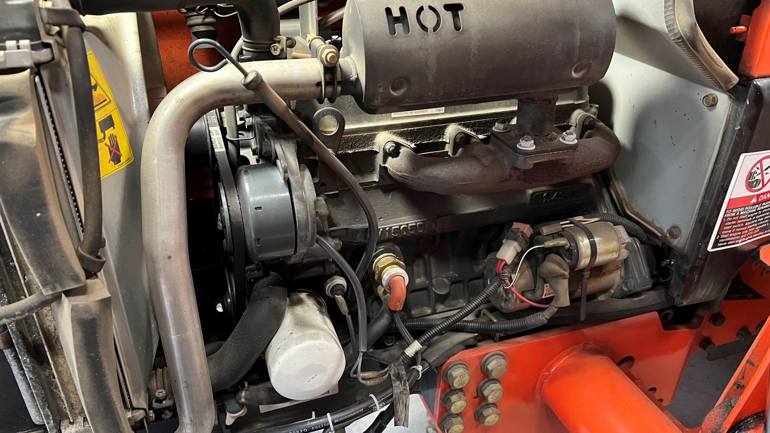

I started by removing the front grill and side cover. I didn't remove the FEL, as you can see, there was plenty of room to access everything. I then disconnected the NEG 12V battery terminal.

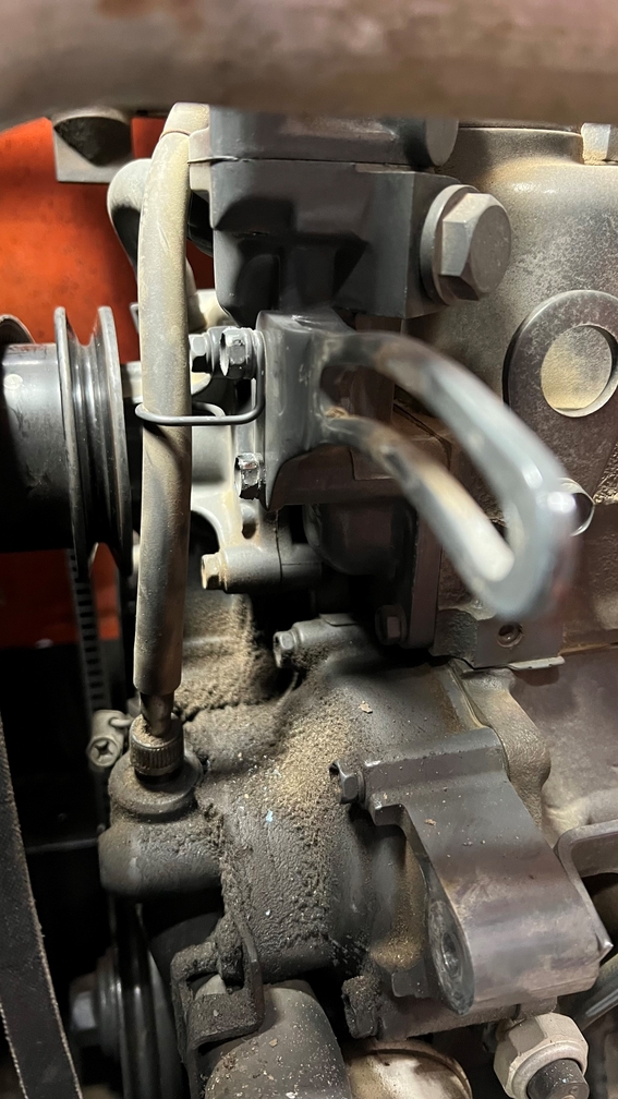

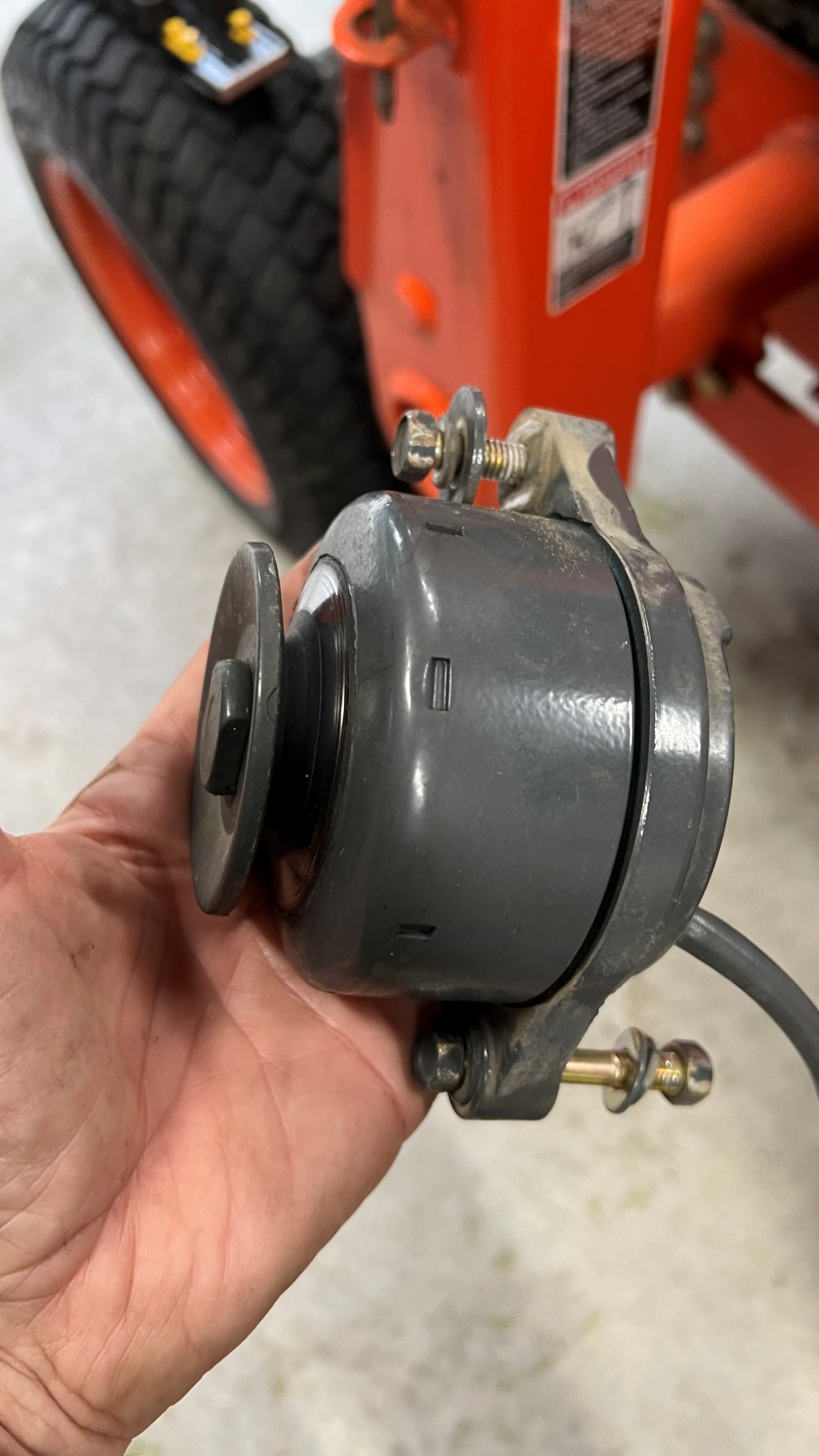

I removed the upper and lower bolts holding the dynamo in place, and removed the assembly. Weird looking little thing!!! I then removed the belt as a new one is provided.

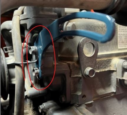

There are two 10mm bolts that secure the dynamo bracket in place. The kit comes with a new alternator bracket which must be used, and you use the two bolts you removed to secure it. These bolts were easy to loosen with a 10mm wrench. They were just "snug". I went by feel when tightening them with the new bracket. Didn't feel it was critical to torque them, and it would have been difficult to get a torque wrench in there.

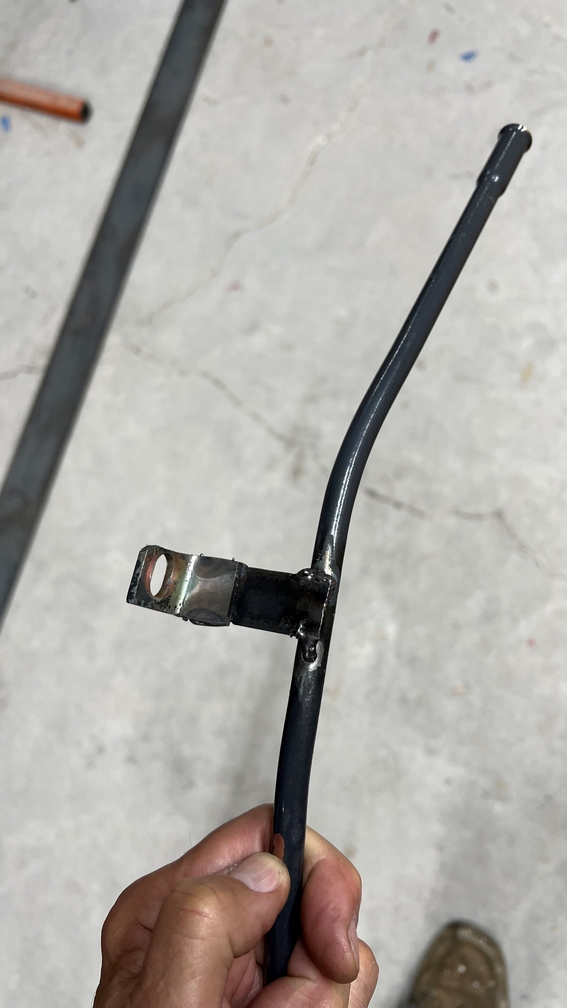

The oil dipstick tube is in the way of mounting the new alternator. The kit comes with a new dipstick that can be inserted directly into the block by removing the dipstick tube. There is a metal bracket welded to the tube that is secured by the lower alternator bolt. I couldn’t “bend” the tube and maintain the placement of the bracket. I’m going to cut the bracket such that I can fab up a new piece and weld it to a portion of the existing bracket. For now, I just used the new dipstick to continue with the install. With the new dipstick you have to remove the side panel every time to check the oil level...that's a PITA!
When installing the alternator, I had to go back and loosen the two bracket bolts, and “match up” the upper alternator bolt hole with the bracket slot, with the alternator in place. There is enough play in the bracket that the top hole will not lineup if you randomly secure it in place. Just loosely secure the bracket in place without the alternator, then you can adjust it with the alternator in place. I just tighten the lower alternator bolt enough to align the top. I was able to get in there with a small 10mm wrench and get the two bracket bolts snug enough so it wouldn't move. I removed the alternator and tightened the bolts.

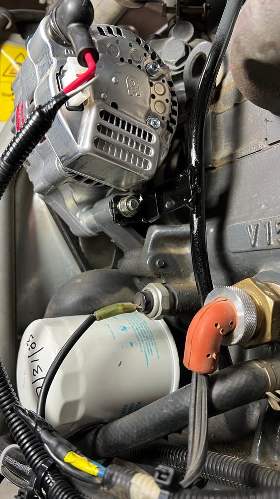

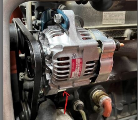

Installed the alternator once the bracket was properly adjusted. I used the smaller diameter bolt with a sleeve that goes in the lower alternator bolt hole, and a spacer behind the lower alternator bolt hole indicated by the red arrow in the image below.
The belt tension should be adjusted so there is 7-9mm of deflection in the middle run of the belt. That's roughly a 1/4". I checked it from the alternator pulley to the crank pulley.

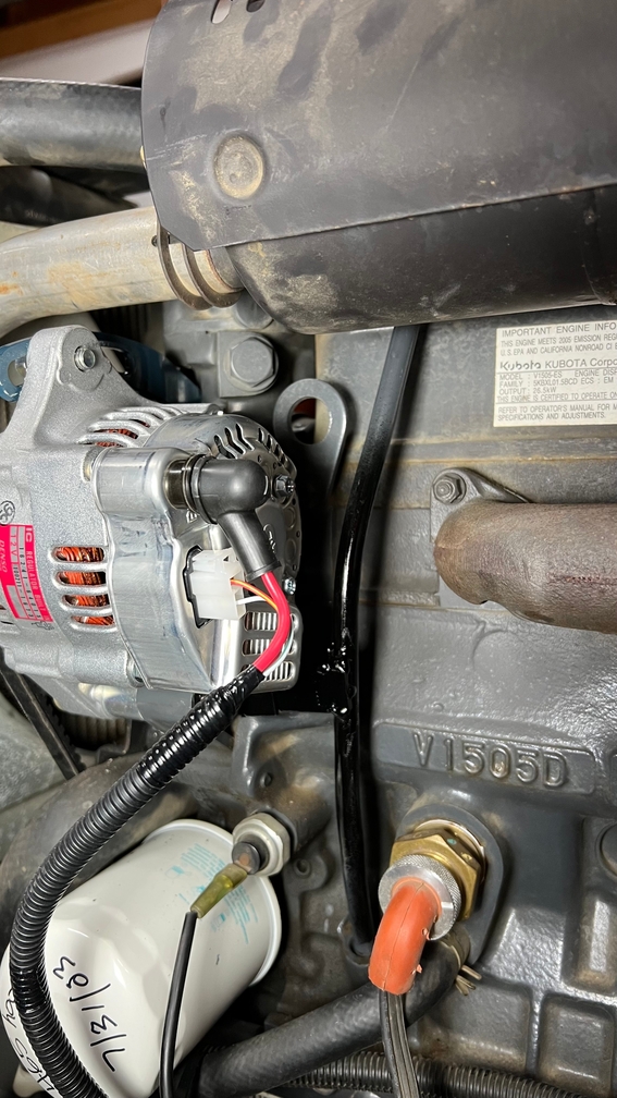

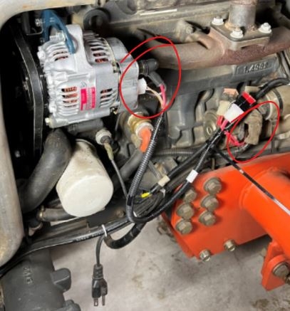

With the alternator in place, I routed the new wiring harness from the engine compartment to the cowling under the dash.
I routed the new red alternator wire and terminal through the rubber boot to connect to the starter. I then connected the other end of the red wire to the alternator lug, and the white plastic connector as shown below.

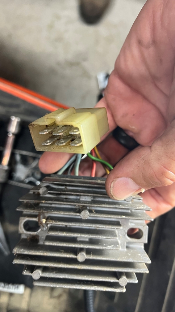

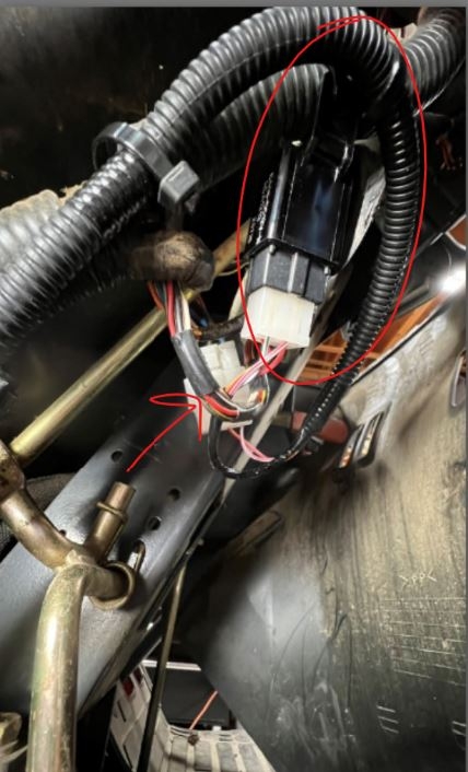

I remove the voltage regulator which is mounted to the steering column. I used a long and short 3/8" extensions to be able to reach the bolt holiding it in place. With it loose I disconnected the harness connector to it.
The new harness has a connector that will connect to the voltage regulator connector.

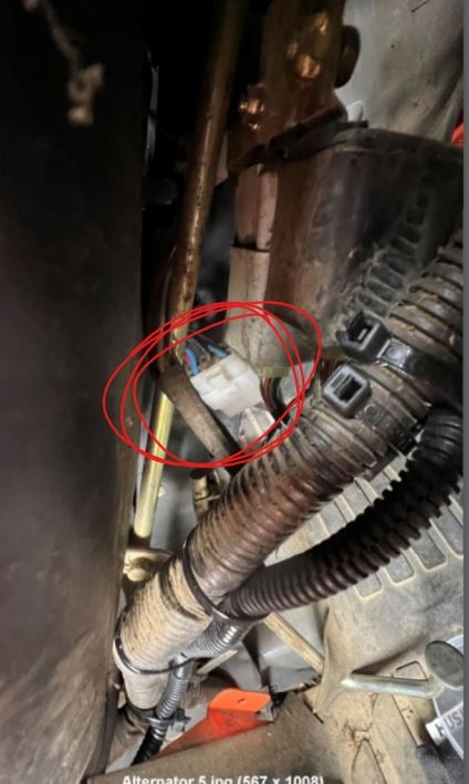

There is a relay that comes with the kit which connects to the new harness. I attempted to secure it to the steering column where the voltage regulator was mounted, but the screw was too long. It was getting really tight, and the relay was still really loose. I ended up just using a tie wrap and securing it to the large existing harness. The relay is circled, and the voltage regulator connector is pointed to with the arrow.
With everything connected, I figured I'd start the tractor and make sure the new alternator was working. I reconnected the neg battery terminal and attached a volt meter to the terminals. Measured 12.9 volts with the tractor off and 14.4 volts with it running...SUCCESS!!!!!!

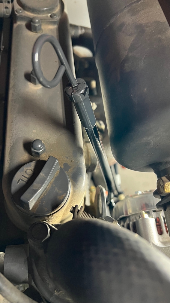

The final step in getting this completed is to reroute the dipstick tube. I figured it had to be between the muffler and the valve cover.
I cut the bracket leaving about 1/2" of it on the tube. I figured I could weld onto that instead of the tube. Once I got the tube shaped so it was positioned properly, the piece on the tube was on the back side of the tube, so I just ended up cutting it off. I removed the lower alternator bolt nut to position the portion of the bracket that had the hole. I hand tightened it and marked the tube where the bracket needed to be. I used some 3/4" flat stock to extend the angled portion of the bracket to the tube. With the tube marked, and the extra length of bracket material determined, it was time to weld it together. I have a Lincoln 180 MIG and first welded the extension on the angle piece of the bracket. Then I removed the paint from the tube and put one tack to hold the bracket in place. I then when out to make sure the fitment was correct. I just had to make a slight adjustment, and then put a couple more tacks, three in total.
Lightly sanded the tube around the weld and painted it. Only had some black paint so that had to do.
Took a couple hours, but definitely worth the time! Otherwise, using the replacement dipstick in the kit, requires you have to remove the front grill and side panel every time you want to check your oil!!!
