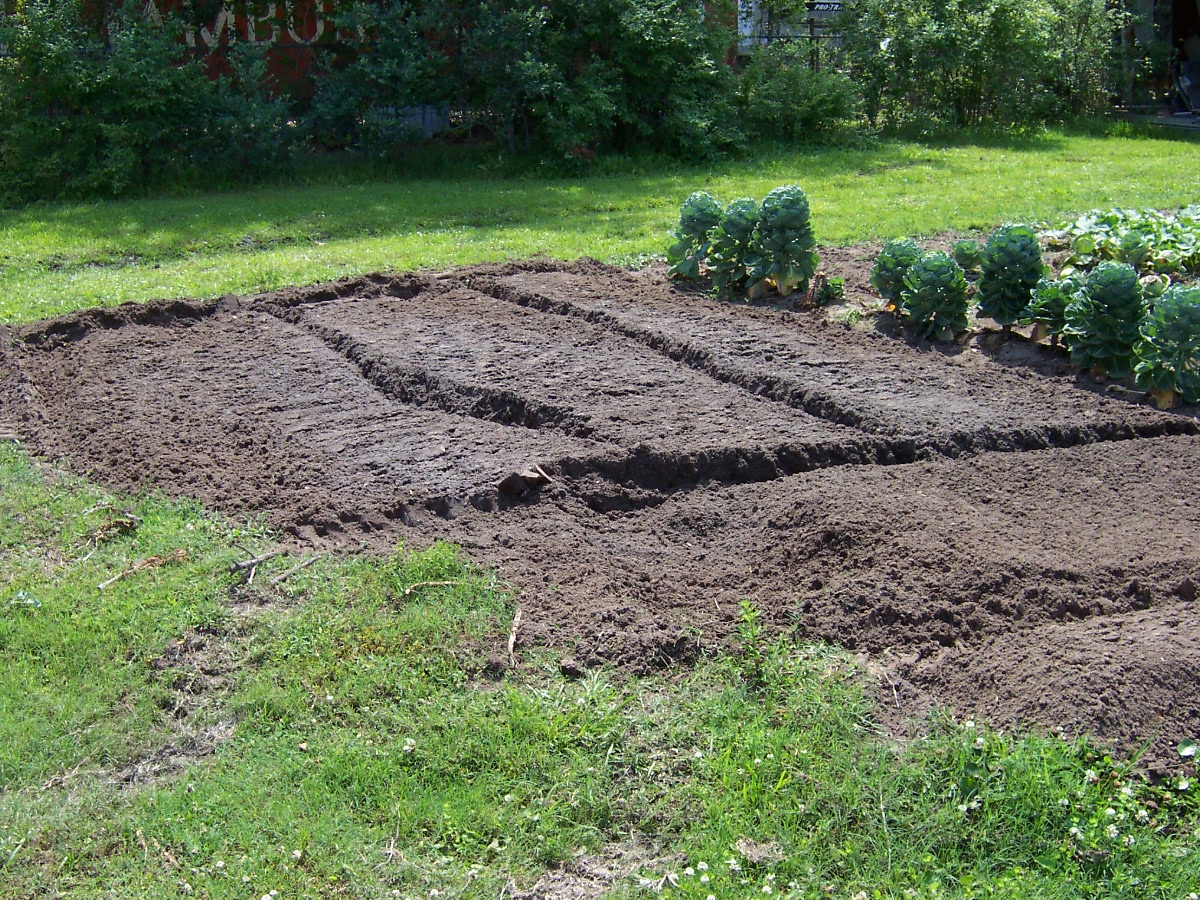

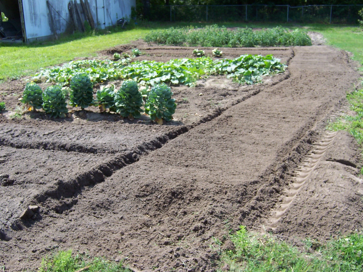

I just bought a used 4' tiller. What I like about the 4'er is I can get in between in my garden to start new crops.
The pic shows three passes side by side. I was going away from the camera. I also made a pass (in the fore ground) coming from right to left of the camera and you can see how little tire track there is. I have a 35hp Branson with R-4 tires.

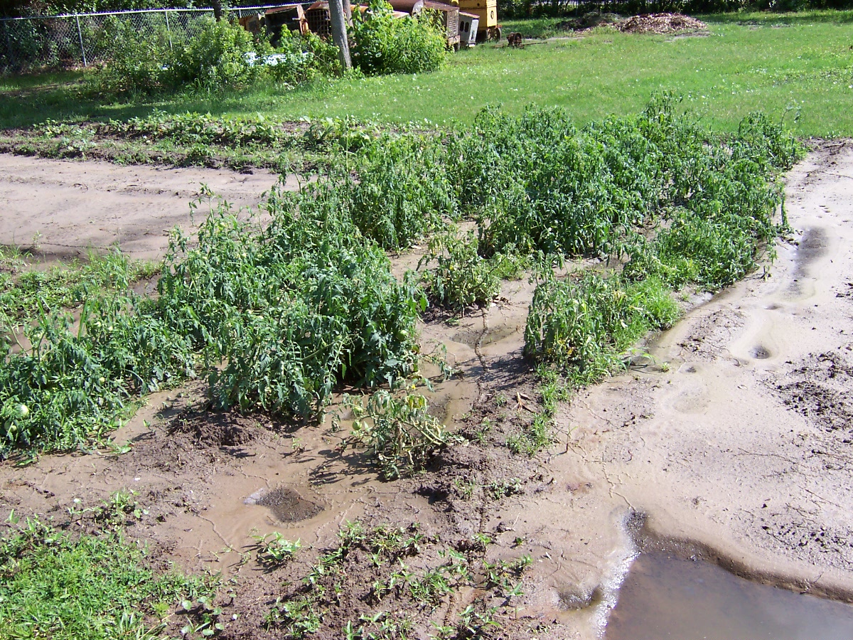

Here is a newer pic of my garden area after 25-30 inches of rain in the last month since the other tilled pics. I had 1 3/4" of rain just today! The soil now is like pudding 8" deep. Everything growing is now ruined.
