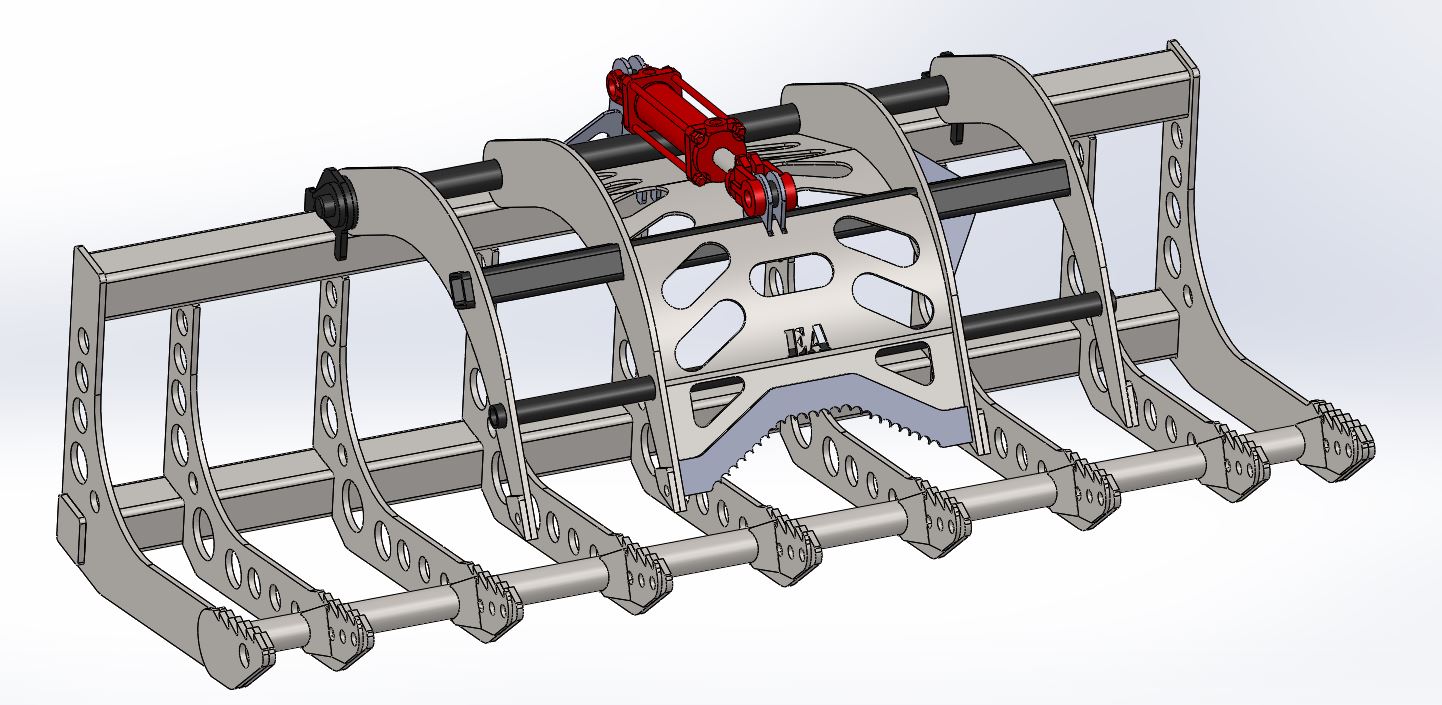

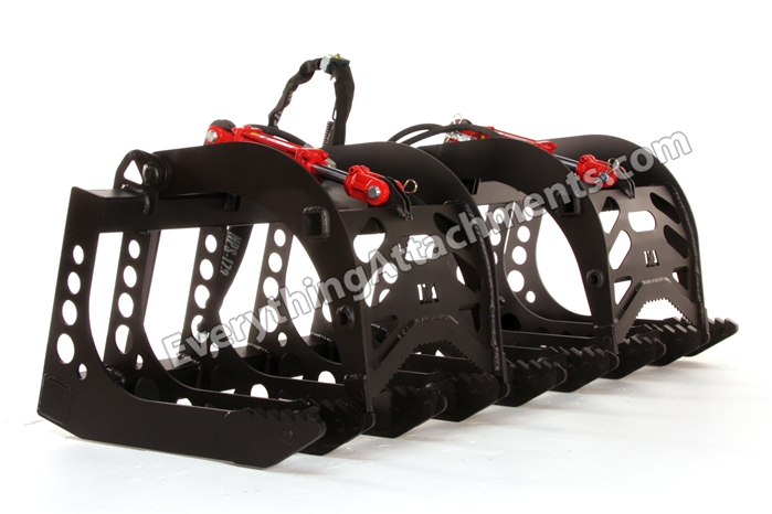

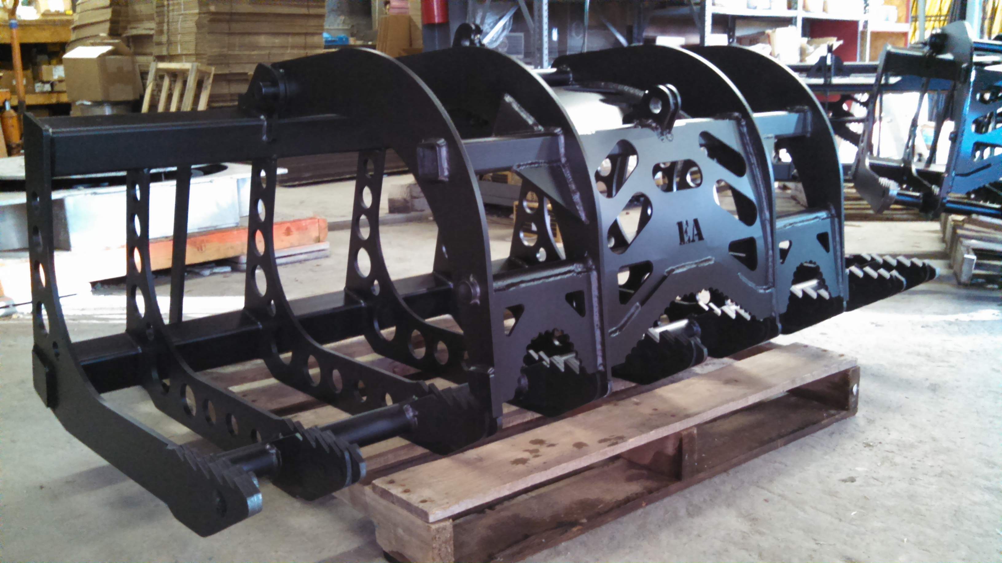

My tractor is 40hp and has lift capacity of about 2700lbs. My grapple is a light duty 48" open bottom style. Made by Millonzi who is out of business. If I had to replace it (It is fine despite aggressive use for about eight years) I'd probably get one of the light/medium weight 54" or 60"(max) single lid grapples from Everything Attachments. I'd actually prefer a 48 but they don't make that for a 40hp. My current grapple is essentially a generic style and there are many manufacturers who make similar grapples. I am impressed that virtually all the generic grapple manufacturers are just welding shops and put very little thought into their product. Everything Attachments has put a lot of effort into designing a true light duty 50" grapple that is limited to 35 hp. The 54/60 is a hybrid of the bottom from a heavier grapple plus the lid from the light duty. Best compromise available IMO right now for 40-60 hp CUTs.
